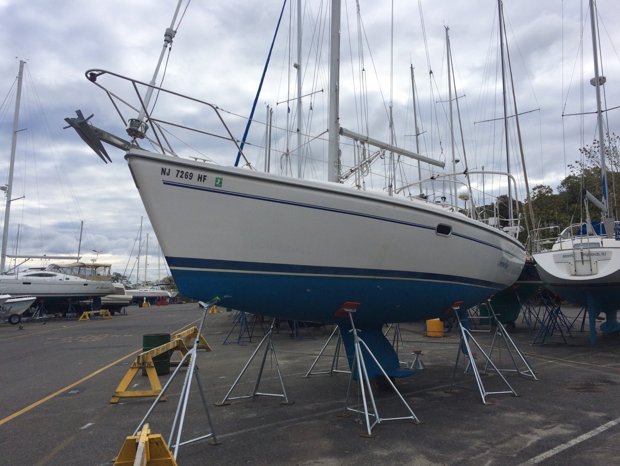

The quick answer is that I've never measured them, but when my boat is on the stands the heads are neither screwed all the way tight against the stands, nor are they screwed so far out that I've got less than an inch remaining. So I can easily adjust 1+ inches up or down on every stand. So I don't think an inch difference is going to make a difference. And that is with my wing keel probably 6-12 inches (I'm guessing) off the ground. The boat is low enough that I can use the swim ladder (when left down) to board the boat without an additional step-stool or ladder.
Also, I didn't need/use the keel stands. You can see them on the ground behind the boat. They are just sitting in my garage.
The longer answer (in case people haven't read my older post)...As I mentioned in the prior post, back in 2014 multiple members of our club ordered stands at the same time from ScaffoldMart in North Carolina, so we got a break on shipping as they sent them all up to us in one truck. This is what they recommended for my wing-keel C310, and is indeed what I purchased:

Now, it turned out that my harbor guys didn't like the keel stands as they felt it put the boat too high in the air with respect to the other stands or it was because I wanted to be able to board from the swim ladder (it has been 6 years so I don't remember exactly why). Regardless, I've never used the keel stands as the harbor uses large wood blocks instead. So the keel stands were a wasted purchase for me and they are sitting in my garage. So depending on how your harbor blocks the keel, you may not need the keel stands. The other items have worked perfectly for me and I'm still using them today. I haven't even had to replace the wooden heads yet, but I also keep them in my garage during the summer. The stands sit out in the harbor yard during the season.
As always, your mileage may vary. But this is what worked for me.
