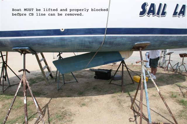

Aug 11, 2006
1,446
Hunter H260 Traverse City
Check this pic out from Pat Adam's Centerboard project...The more you use the better. I think he used 6 stands.

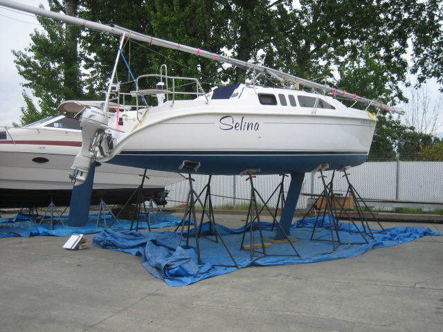

8 jack stands by boatyard
Here's a pic of our boat at Schooner Creek Boatworks. They used eight jack stands.

Great photo Bob! Very helpful. BrianW
