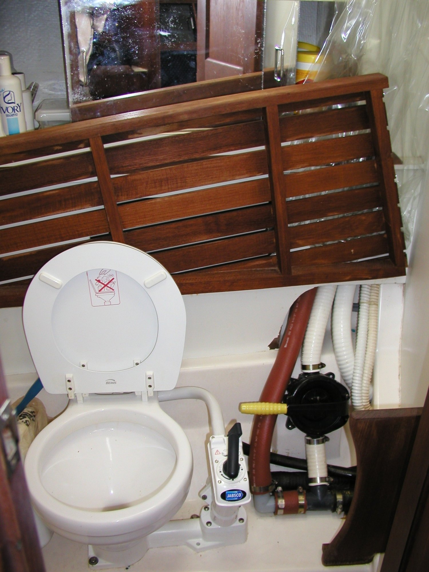

Does the top of the pump cylender look like the one in this pic. It should have a "padlock" symbol on the top. When you turn the handle it will lock the handle from being able to be pumped. If not then it is a regualr / older pump.
10,247
You can see the "Lock/Unlock" signage on the top, under the handle.. The difference is that the underside of the piston in the pump has a rubber extension that pushes down on the pump flapper valve and locks it closed when you push the handle down and lock it by giving it a quarter turn.. that prevents any backflow into the bowl from the holding tank or discharge line.

Claude, I think you have answered my confusion. To "Lock" the system, I need to push down on the plunger and turn. This is not shown in the video of how it works. When I'm on the boat this weekend I will test this out. Thanks for the clarification!
