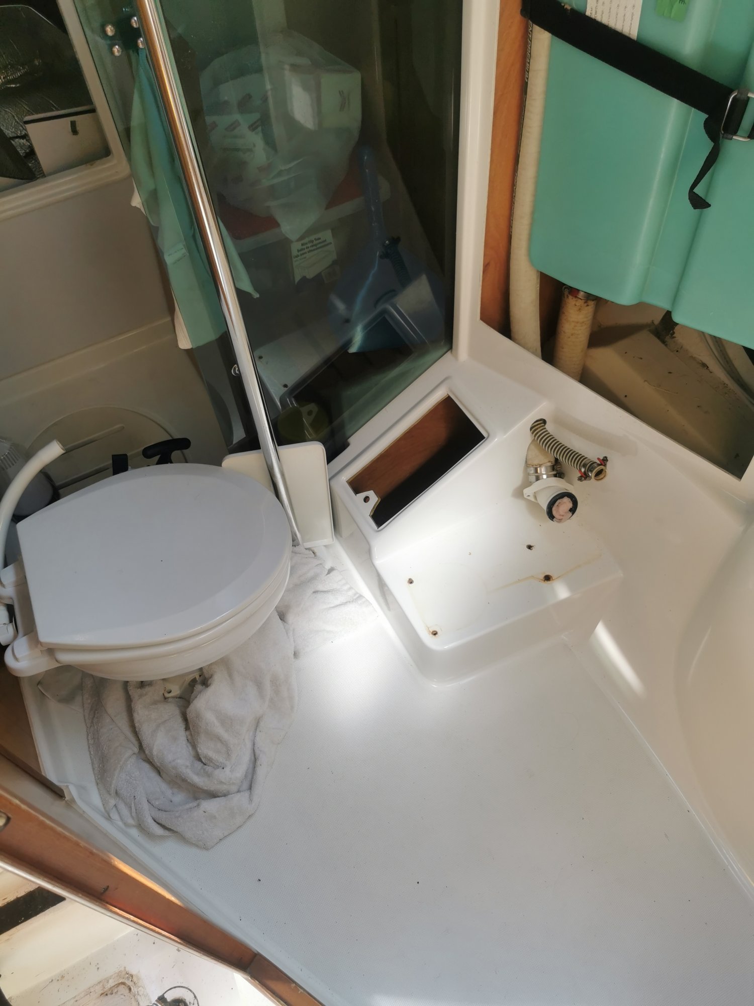

Due primarily to space constraints, I've picked up the Quiet Flush electric head conversion (#37255). Researching the install, I found reference to the necessity for a solenoid controlled vented loop (after the pump before the bowl) for the Jabsco replacement unit (#37010) so I bought that too. Opening the solenoid, though, it says specifically it is only for 37010. That leaves me wondering why one would need the controlled loop and one not.
And if they both do, might the solenoid unit simply not work with the control harness for the 37255?
Am I better off just returning the conversion and getting the full unit (which I'm not sure will fit, but in theory...)?
