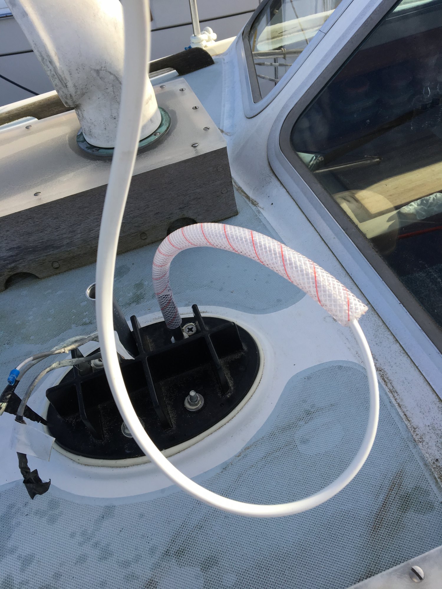

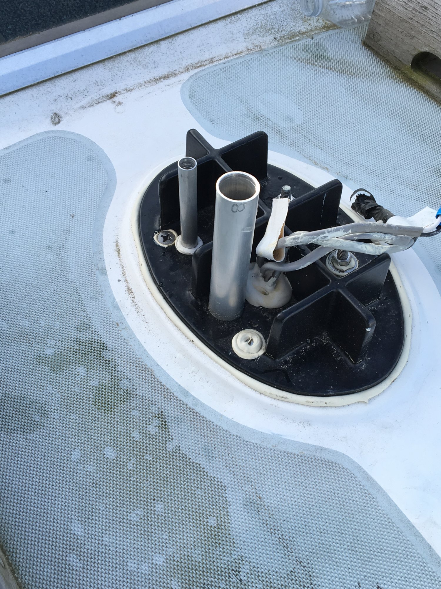

I am afraid inside the mast is something we all live with. Some of us have deck stepped masts. Then the water accumulates in the mast at the deck. Smart owners make sure they have weep holes in the mast step. That way the water seeps out onto the deck and off the boat. If no weep hole, then the water accumulates till it eventually finds a way out.
I took precautions with my mast I created weep holes. I clean the weep holes each winter. And I installed elevated pipes to pass the electrical cables into the cabin. Additionally the wires pass through a length of hose. The hose is coiled so water running down the cables inside the mast drip off into the mast base. Water has to accumulate above the pipe level to gain access into my boat. So far I have a dry interior - no leaks.
D17E5D26-8846-4EC2-BD16-ED6B79434687.jpeg F47C1425-E703-4362-8E45-E24AF59398BE.jpeg
The wires you see there are the old system They were cut off during install and the area was filled with 4200 caulking to prevent possible leaks.
