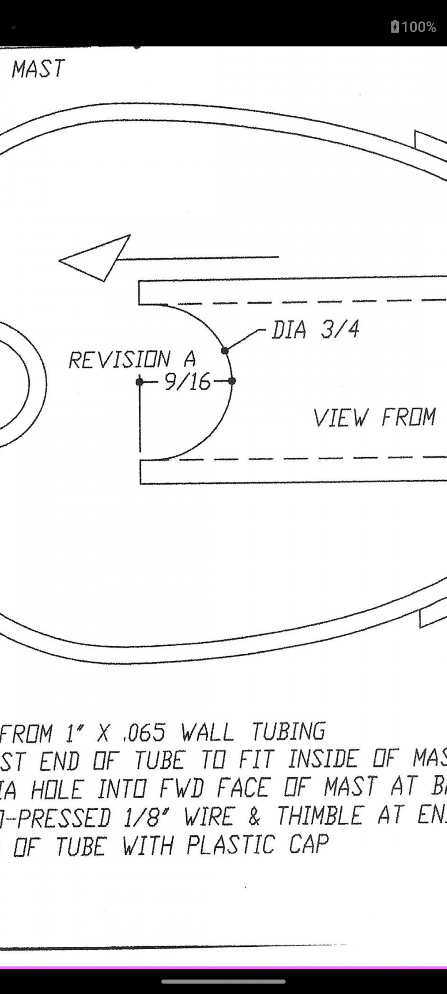

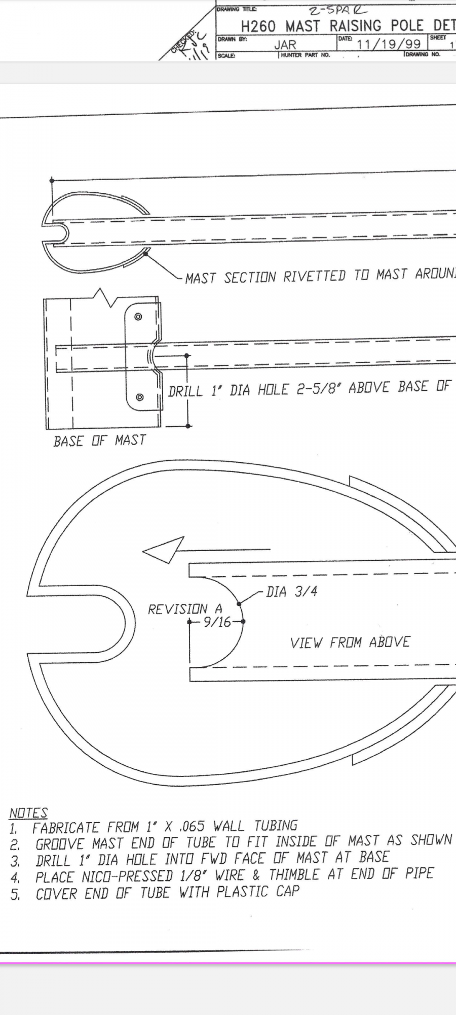

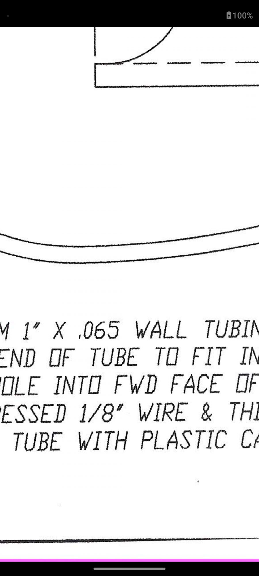

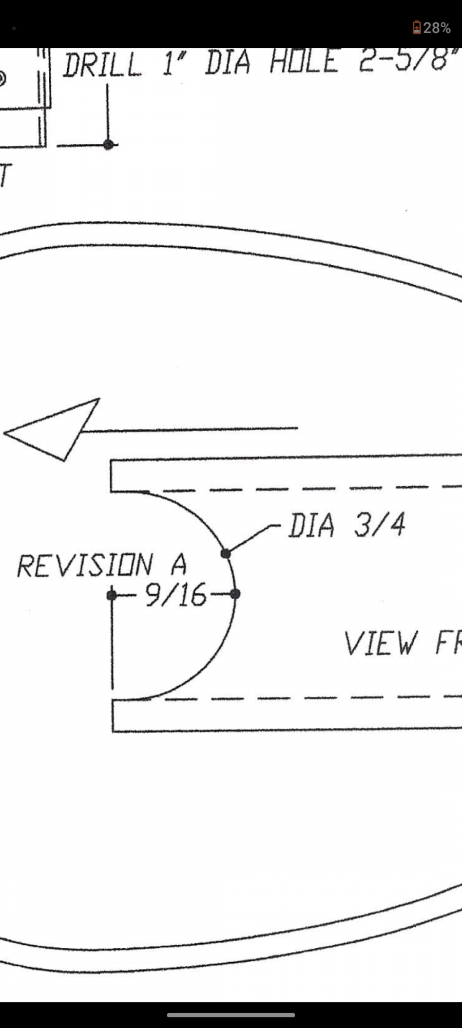

Oct 8, 2023
116
Hunter 260 Kemah
Thanks for all the good info you share. For the Hunter 260 gin pole do people know if the half circle cut at end is diameter 3/4 of inch as I think and image shows. The image also shows "revision A 9/16" and I worried what this meant. Thank you. Thanks for dealing with us slow thinkers. DAVENPORT
