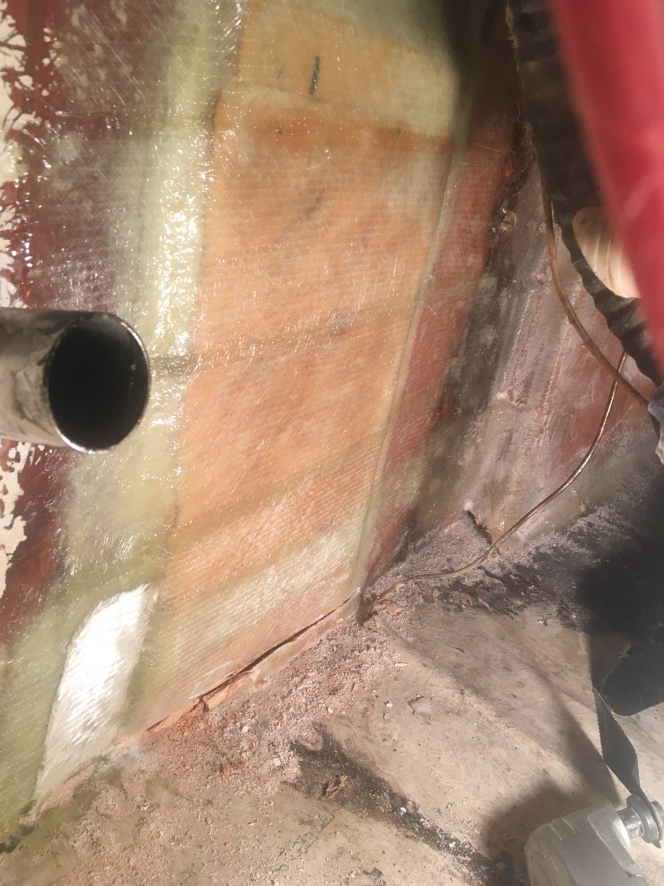

I discovered that the wood in the middle of the transom is soaked. My boat is the inboard model and construction might be different than the outboard model. Anyways, I started cutting away the inner skin and rotten wood today. I discovered that there is some thin wood on the starboard side of the transom. Does anyone know if this wood extends all the way to the starboard corner of the hull?

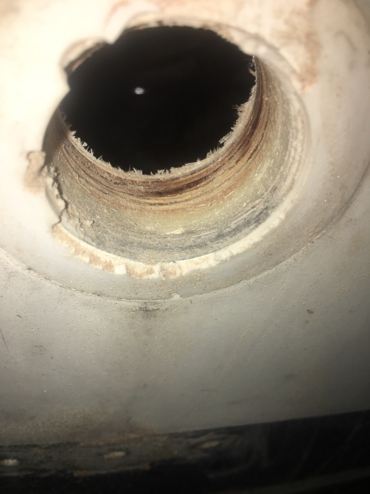

I'm considering redoing the area around the gudgeon in heavy fiberglass without wood because it's constantly getting dipped under water. Can anyone find any reason not to?

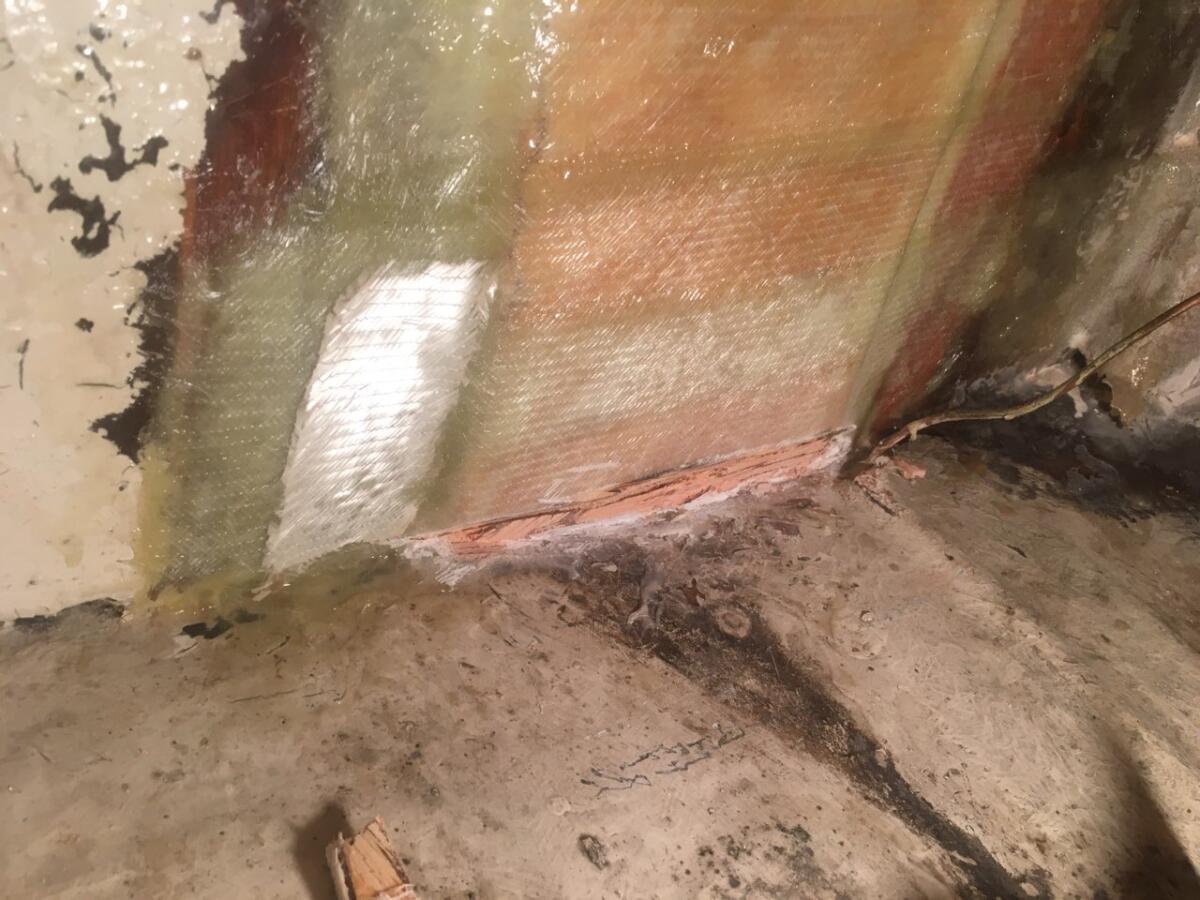

I peeled away the wood layer by layer until I found some solid wood that was a normal color. Can I build on top of this or should I go to bare fiberglass? Does anyone know how thick the outer fiberglass skin is on the O'Days?
