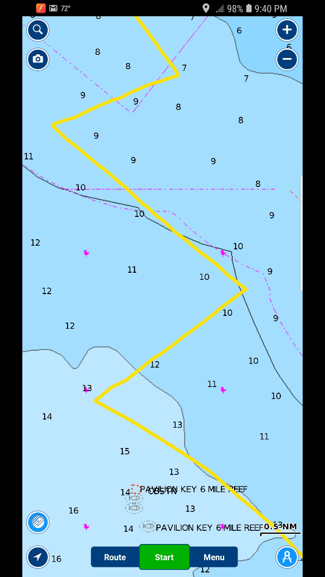

Have you made any calculations to determine your actual tacking angles, just to establish a baseline? If your chartplotter gives you VMG (Velocity Made Good), that data can tell you a lot. GPS tracks are also helpful. It's always possible you are pointing better than you think.
This is about the best I can achieve:
You tacks look much better than mine. I checked my recorded tracks and I am 15 to 20 degrees off what you show. I have lots to learn - still pretty new at sailing.
thanks for posting,
Valerie
