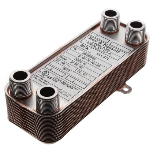

Does your boat have hydronic heat? Just curious if anyone has used a heat exchanger with hydronic heating and kept their hot water tank.
I was In HVAC for close to 50 years, learned a few things along the way... I would have to say great idea but, by time you purchase the heat exchanger and a water heater tank you'll probably find the cost about the same as buying a heat exchanger water heater already made for the application.

I was a HVAC business owner for close to 50 years I would have to say great idea but, by time you purchase the heat exchanger and a water heater tank you'll probably find the cost about the same as buying a heat exchanger water heater already made for the application.
I agree on the costs. My Seaward HW heater is functioning fine plumbed through the engine and shore power. I have been thinking of adding heat to my boat which would make May and October evenings more comfortable. Researching air and hydronic systems has been fun, and both have their advantages. To me the advantage of having hot water at anchor has driven me towards a hydronic system. I read a lot of sailors with hydronic heating using them but I still want to keep my HW heater running off the engine too.
