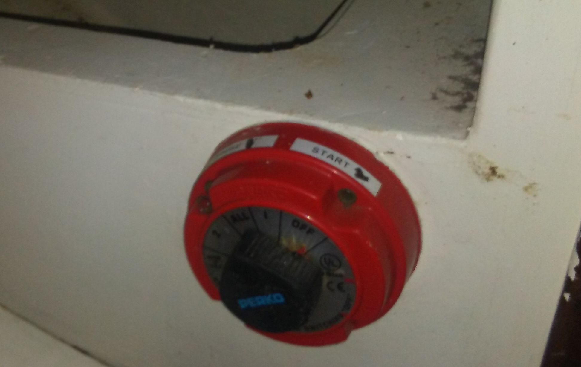

Oh well now, this really Is embarrassing. Good thing it weren't no snake.switch.jpg

Oh well now, this really Is embarrassing. Good thing it weren't no snake.View attachment 186046
Yep, better than it just being all one bank. Still wouldn’t be bad to have something like an ACR to automatically combine and isolate the banks. That might help especially if the owner might not have the interest or discipline to switch the 1-2-B switch for all the necessary starting/charging cycles.

Just realize that labeling it a starting battery don't necessarily make it exclusively so. On that switch, the house load and the start load is on the same post. The only thing that differs is the source between Bank 1 and Bank 2. If the switch is normally on "ALL" then they are using and charging both banks at all times. It's not the worst thing, they just don't have any reserve if they need it. Just think of it as a good opportunity to make a productive change!
