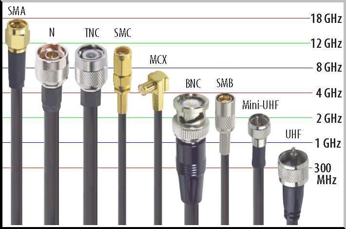

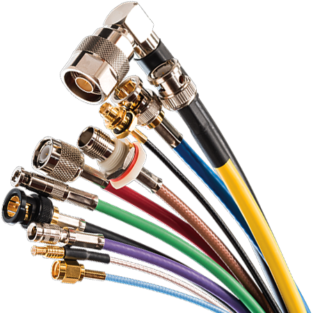

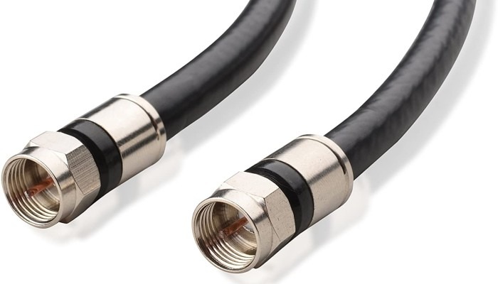

Various cable tiles have been used on boats.
Black is typical
But some owners have installed colored cables. There are a smorgasbord of options I am afraid
