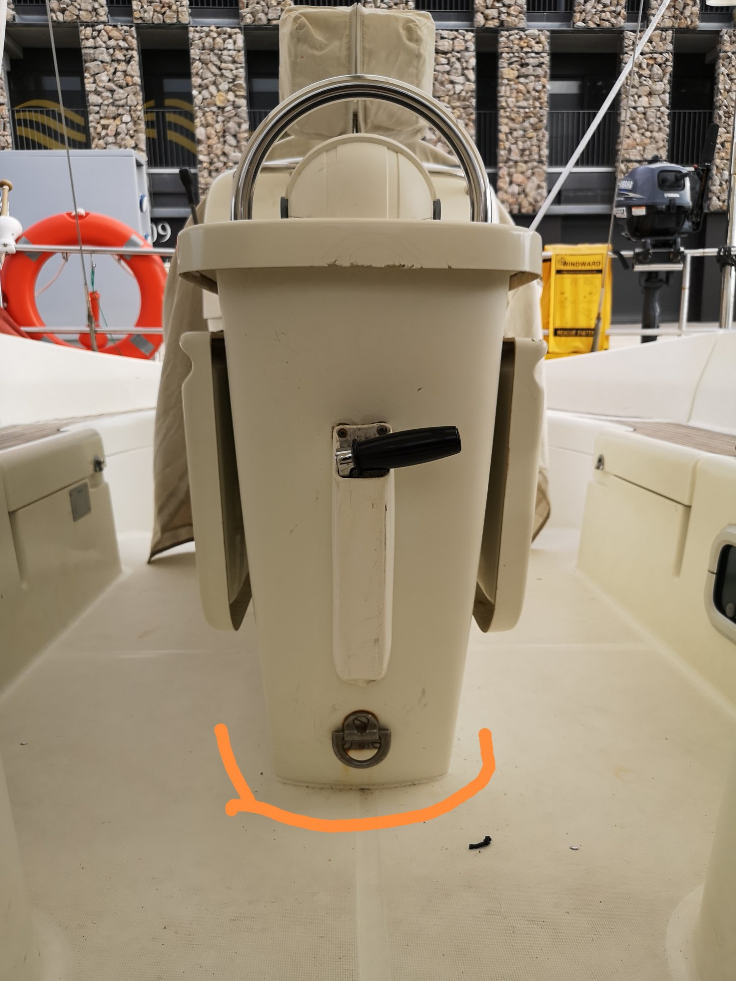

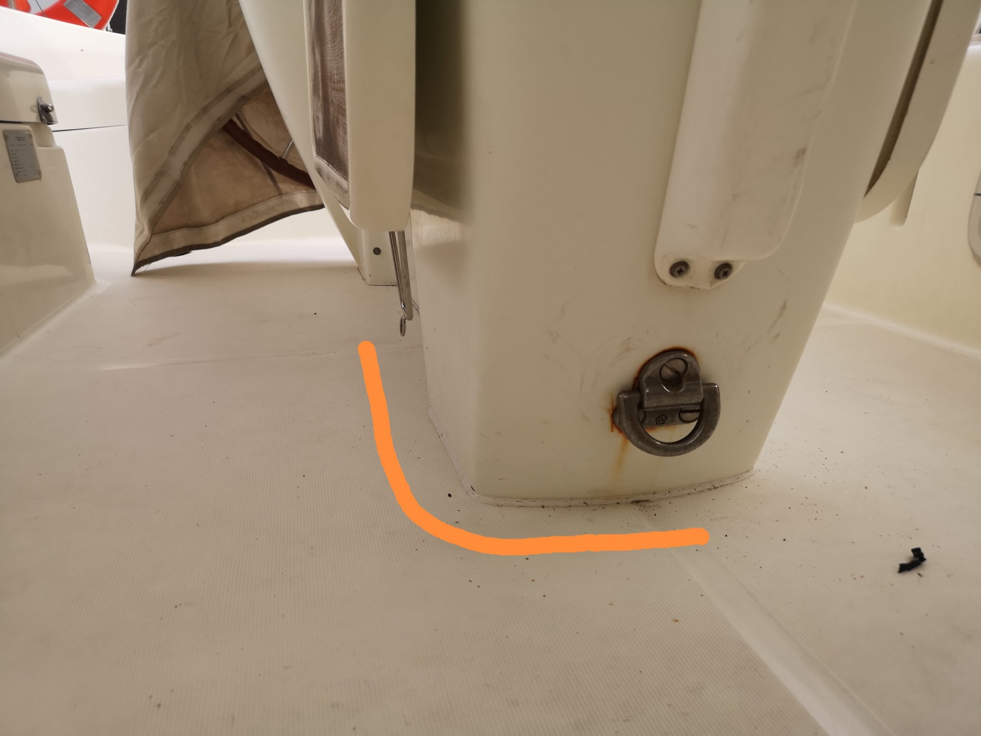

So we've had some leaking into the rooms via what we think is old caulking leaking in the centre cockpit. my question is removing this and applying 3M 5200 a good idea or is this too strong?
it's around the area shown in the pictures. anyone got any experience with it?
I've heard it's for places where you don't expect there to be any movent in the future so don't want to make a mistake.
thanks for the help and guidance.

I'm not seeing pictures?

For that application 4000 or 4200 would be appropriate. There is a UV stable 4000 or 4200 (can't remember which off hand) that would be best as it will not yellow or turn brown.
To do the job properly, it will be necessary to remove the old caulk and clean the surfaces. The seal will be better if the pedestal can be raised a few inches and the caulk applied underneath the pedestal. there is probably a flange that allows the pedestal to be bolted to the cockpit sole. More work and effort than running a bead of caulk around the joint but with a better outcome.

ah thanks so much for the advice. the table screws are loose as well so might be able to big two birds with one stone.
13,969
And make sure the pad eye is properly secured and backed up. Might as well caulk that too. ;)
