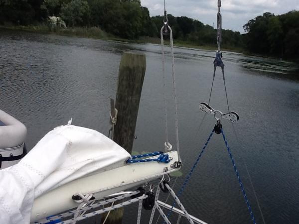

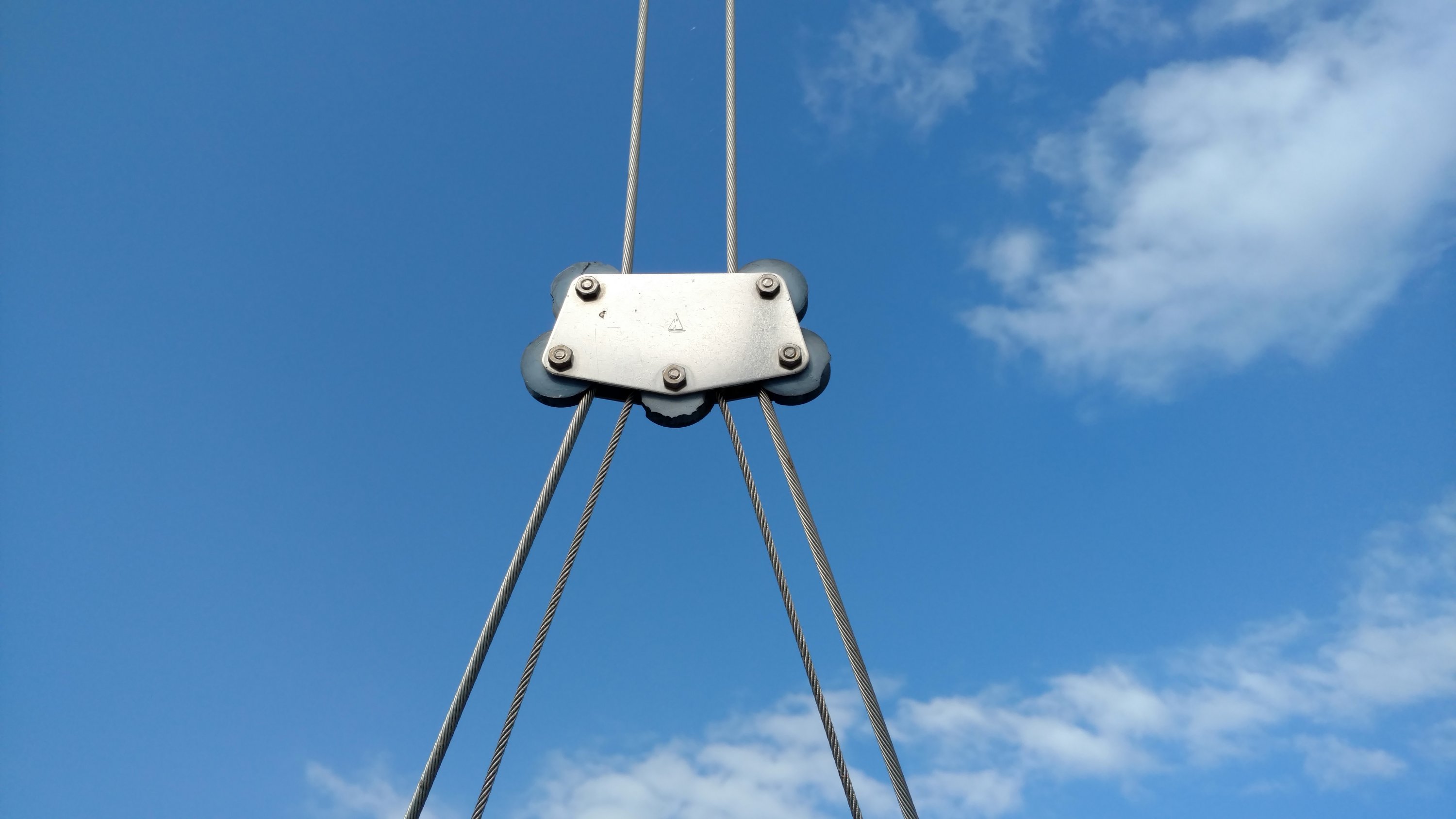

TopCat, consider going to a split lower backstay and using 2 wire blocks to squeeze them together //////snip ...............//////snip( percent of working load you don't want to exceed (15-20percent).
I am indeed considering it due to the comments in this thread.
But honestly I just don't understand the concern if the back stay lets go. So what? This boat and many others similar to it sail around for years with a seriously floppy backstay, in other words - it does nothing. I've seen it called "the boston strangler" on other Mac sites.
The only reason mine isn't still floppy is because I want to induce mast bend and I'm only bending the top few feet.....
Feb 20, 2011
8,062
I think Roger put that backstay there for a reason. Maybe to bend the mast, maybe to back up the shrouds, maybe both.
Apr 5, 2009
3,332
TopCat, you can get the redundancy that others are advocating with your system by shortening the length of the static line so that the moving block on the tackle is tight to the backstay block when fully released. That way, if you loose any component of the tackle system it will dead-end into the block on the backstay and maintain the minimum tension / max length as a single backstay. It will be off-center but many boats are designed that way (C42 for example) and the horizontal component is very small.
