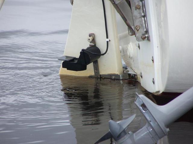

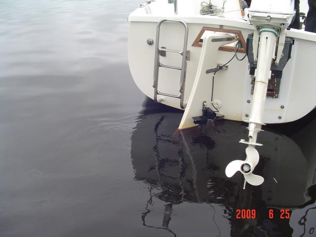

Don't feel bad Jonny. I'd be afraid of that one myself. If it was my boat, I'd relocate that transducer to the outside of the stern transom even if I had to Mickey Mouse it somehow. Then I would patch that hole some day when I got it out of the water. My friend Wayne mounted his knot meter on his rudder blade using a track which allows him to lift the transducer out of the water when the boat is not in use. That way, it doesn't get fouled up with growth. Here's his rig. I found this small track with a car attached to it at a consignment shop in Newport RI and paid about $4.00 for it and he Mickey Moused it to work on his rudder blade on his Seaward 22. His transducer is as old as the hills but it still works great for him.
It's possible that the transducer on you boat is OK and just needs to be cleaned up. I remember reading about Tristan Jones using a piece of canvas with four ropes attached as a temporary patch for a hole in the under side of the hull. It's a matter of getting the ropes under the hull and using them to slide the tarp under the hull from the beam of the boat. Then, I would have a large cork handy or some rags to plug the hole temporarily as soon as I removed the transducer. You could try that. A small polytarp would work in keeping the water from gushing in fast. The rag would stop it for sure. If the rotor is just stuck and needs cleaning, you'll be able to fix it right on the spot and stick it back in place once you free it up.
