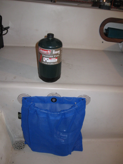

I know that small camp-style propane tanks should not be stored in the cabin or a lazarette, and I've also read that they should be stored in a mesh bag, outside.
Is this tight-weaved mesh bag safe to store the bottles? Is it okay to be near the cockpit floor and companionway? I thought I read something about hanging them off the stern rail, but I just imagine them clanging around, and that doesn't seem safe either.
thanks.
10,253
The key is to imagine water leaking thru the bag .. The propane is heavier than air so it will sink out of the bag, much like water would. If that cockpit drain normally exits above water, that is a perfect place to store the cylinders. if the drain exits under water, the propane would not drain out and could, on a very calm day, seep into the cabin by overflowing the companionway sill.

A 4" piece of PVC pipe with a cap on both ends (cement the bottom, leave the top loose), fixed to a stern rail did the job for me.

I see. That makes perfect sense. It does drain underwater. So what do others do about cylinder storage?

PVC pipe holder, in the Anchor locker.
Stays mostly dry, drains low to the outside, no access inside.
IF you have one....
