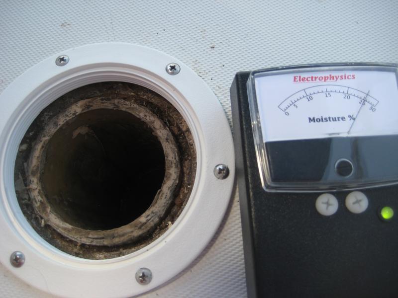

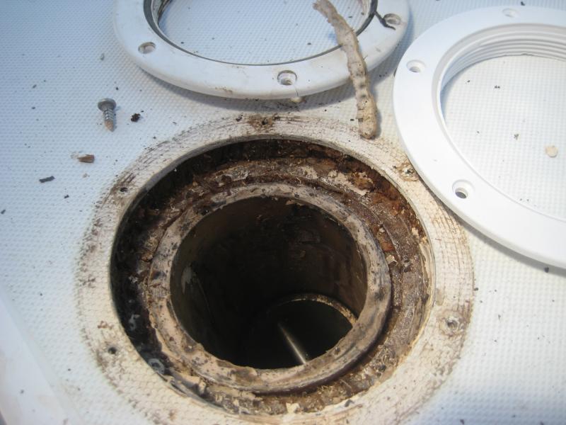

Is this how the water got into my rudder?

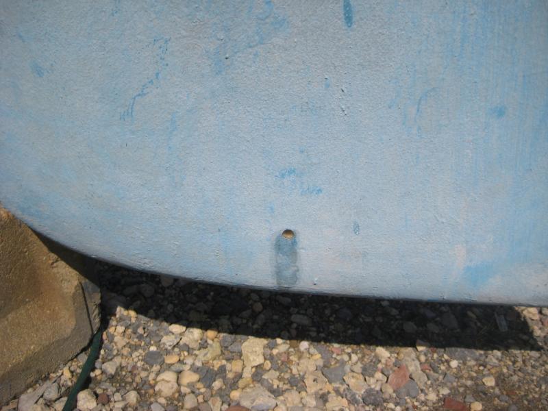

We knew there had been water in the rudder from the survey and one foot square area of delamination. I drilled a hole in the base but very little water seeped out. As there were no breaks in the skin, I figured it got in where the skin wraps around the outside of the shaft.
However, when I went to try out the emergency tiller, the top of the rudder tube was full of water from a leaking deck plate. I pumped out the water into a bottle as it was very oily. As one picture shows the plywood core is soaked. The other pic shows the old and new deck plates with old failed sealant removed. I used butyl tape for the replacement which also allowed me to keep the deck plate straight so it threads close properly and allow for the deck camber.
As it is a very small area, I hope that venting it over the winter will dry out the ply. Being a small area I do not plan to start major surgery. (long list of other projects on front of it).
