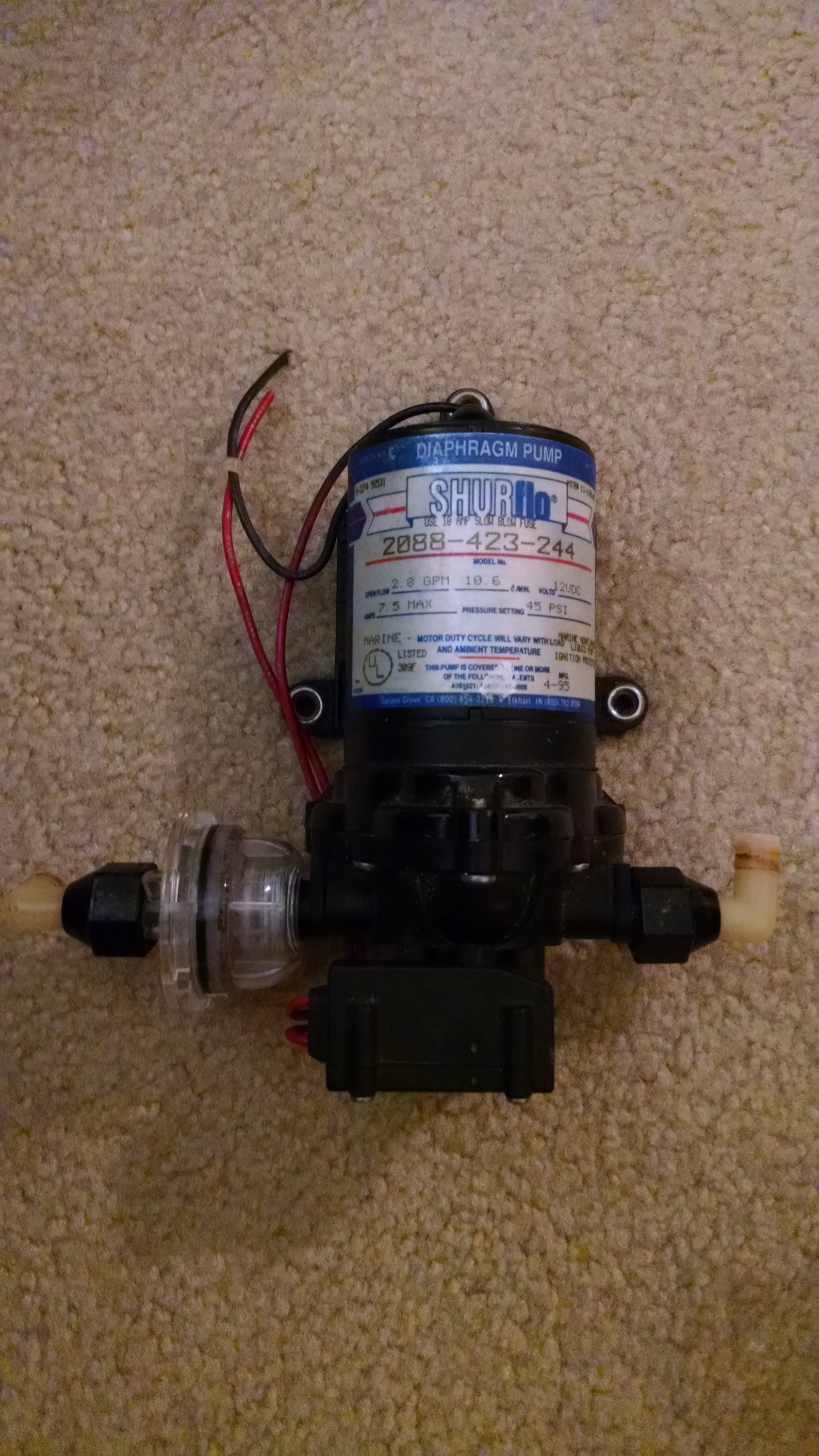

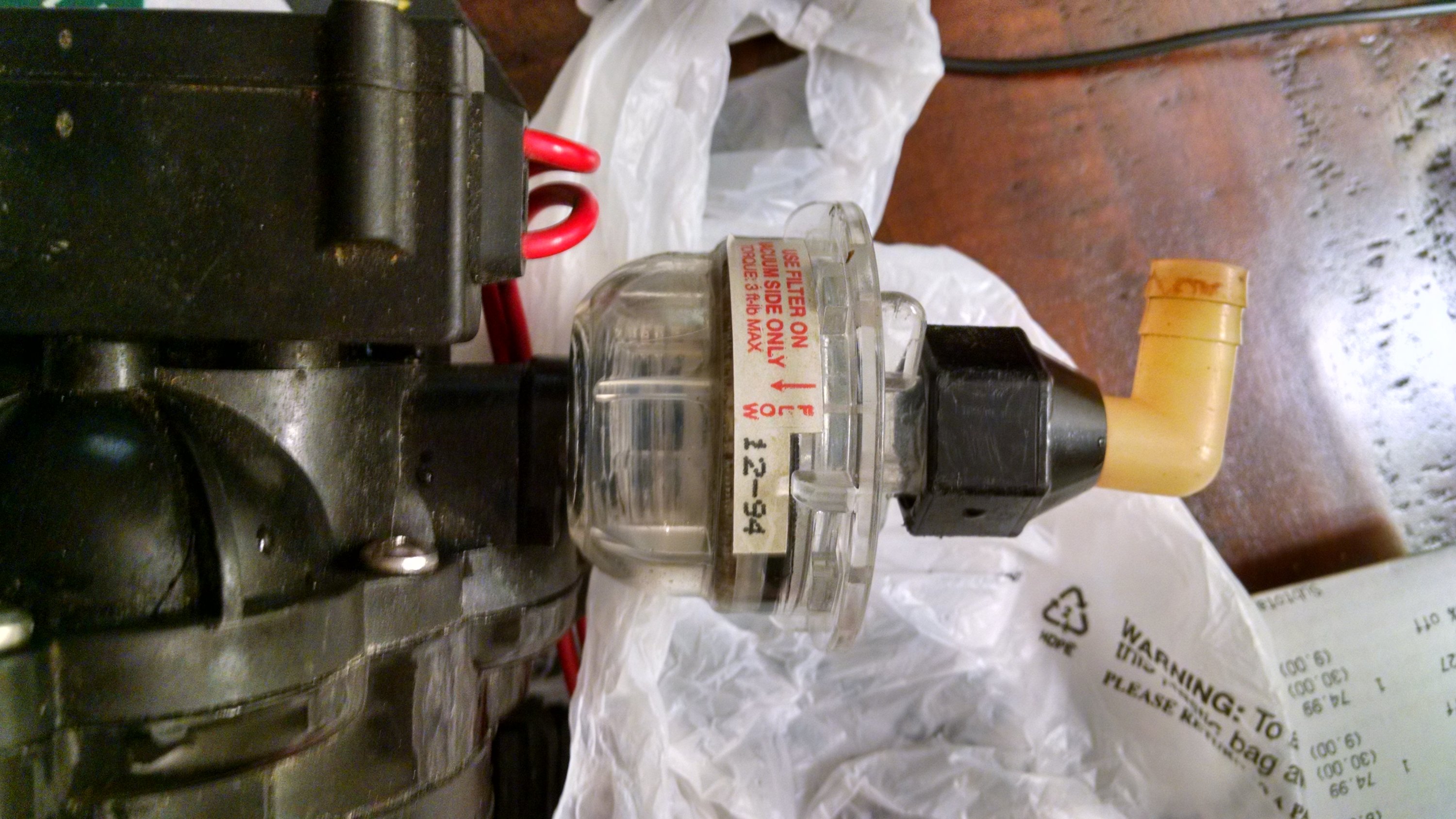

Fellow Sailors. I started my winterizing chores today and found that my fresh water pump is broken. I depressurized the water system to drain and isolate the water heater and the fresh water pump took forever to repressurize. After turning on the faucet the pump ran forever and water only trickled out. I did all regular stuff. Water was in the tank. no blockages on either side of the pump. I looked at the pump and there was a date code of 12/94. It is a Shurflo 2088-423-244. Is this fixable? Is it worth fixing? I would maybe want a replacement with a little more pressure. Does anyone have a replacement suggestion? Also there is what appears to be a filter attached to it that I can't find anywhere on the net. Is there a replacement for that?

Well the motor runs, and it pumps... somewhat...for $36 I would take a shot at replacing the pump diaphragms:
http://www.pumpagents.com/partpages/ShurfloPumps/2088-423-244.html

If the motor is running and the pump body is not leaking water, chances are that the valves in the pump are fouled.. it is easy to disassemble to check.. The kit that Gunni references will fix that problem too..

The doo-hickey attached to it is a filter. West Marine stocks them right next to the pumps. I just replaced mine and didn't know about the diaphragm fix..
BTW, from your pics, the 12/94 date is for the filter, the pump appears to have a 5/95 manufacturing date...

Fixable? Anything is fixable with enough $$$$ . Cost effective, I don't think so. Recall my father in law saying that he was going to look for his warranty papers when his 20 year old A/C unit failed. Check Amazon, they have a new Shureflow 3.5GPH, 3 chamber diaphragm pump for $72.50 with Prime shipping. All of a sudden that repair kit for $36 to keep the old motor and housing seems kind of expensive. If it was a newer pump I would consider the rebuild but for a 20+ pump I would certainly replace. Now taking apart for cleaning it is something I would do if I were underway but I don't think I would bother if I could have a replacement dropped at my home in two days.

The filter comes unscrewed for cleaning. Those hose barbs look bent or not seated properly.

6,990
take off the 6 (if memory serves) screws on the pump head. Remove the 4 mushroom valves (shaped like a mushroom)(three inlet and one out or viva-verce). Take them out with a tooth pick on the mushroom stem and be careful that you do not tear the rubber. Clean with a toothbrush. also clean the valve holder with a tooth brush. Reinstall the valves and assemble the pump head. If during cleaning you notice a tear or wear spot buy a diaphragm replacement kit and install it. When reinstalling the screws insert the screw and turn it clockwise till the threads cut in the plastic "click" into the screw threads. Then screw counter clockwise to tighten.

Thanks to all for your responses. I will be out of town all next week and I wanted this done before I left. I went to WM and bought a Shurflo Aqua king II. They gave me a port supply price which helped. It took an hour to replace. I did take the old one apart and when I put it back together it did not work at all. If I had lots of time I probably would have opted for the repair. The pressure is much better which leads me to believe this pump was on the edge of failing for a while. Thanks again for the wisdom.
