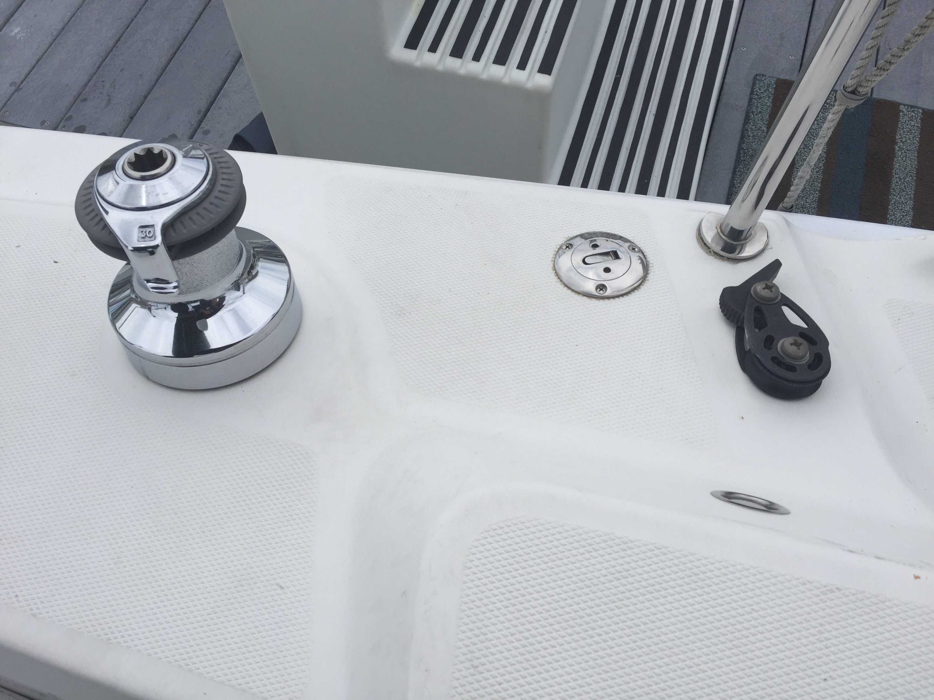

My problem with the existing cam cleat is that it appears you need to re-reave it after every tack. That is unmanageable. I don't know how you get a good release of the jib sheet like that. I would just use the self tailers. As hewebb said maybe the existing "Cam Cleats" are for spin sheets. You like to be able to lock them and release them as needed for the pre-set. Seems to make sense. Usually there is a turning block and we tie a stopper knot. For the jib sheets I would think if you don't want to use the self tailer (And there are good reasons not to), you could add a jam cleat or cam cleat without a bail like this:
https://www.mscdirect.com/browse/tn...MI0uuV_oei1QIVnbjACh0ZFg5PEAQYASABEgJtgPD_BwE
Size it to your line. It will be downstream of the winch so it should never see a full load. Placement is critical. You should be able to release by pulling up from the high side and it needs to run fair from the winch.

Most everybody knows this... but I hope it's okay to mention it anyway... just in case.
Your headsail sheet winches should not use line captive devices on the cleats. That means no fairleads on the cam, clam, vee, or jam cleats. No mechanical captive devices such as clutches or the spinlock snappers.. etc. The cleat should never be placed between winch and sail....The sheet runs from the sail to the lead block, and perhaps a turning/foot block, directly to the winch. WHY???? you must be able to cast off your headsail sheets quickly and completely....
With a self tailing winch... it is entirely normal to have a dedicated cleat, in addition to the cleating jaws on the winch. It's much faster and sometimes more convenient to operate the winch as standard, non ST, device. Especially if your not grinding with the handle....
Gybing single handed is one of those times when you might find your self controlling both sheets at the same time... not grinding, under minimal load with just a couple wraps on the drum... allowing you to cleat and un cleat both sheets from the helm ...
When you are adjusting trim under load... the self tailing winch is a huge advantage, especially for single or short handed crew... when easing the sheet... the proper techniques is to un cleat the line and use your hand flat on the wraps against the drum to control the amount of release.
If you find it difficult to trim this way when single handing.... you should invest in an auto/tiller pilot.
PS Unlike sheet winches, it is common practice to install cleats and clutches ahead of the Halyard winches... mainly so the winch can serve a number of other control lines.
Joe this is not correct. I agree you have to be smart about their applications, but those spinlock locking fairleads are used as headsail sheet control devices on 1000s of high performance boats. I've seen the on First 367s, First 40.7s, First 40, SunFast 360s, Farr 395, etc etc.
The locking cam remains open and the line runs free unless the cam is tripped over, which will hold the line. This will let you use the winch for whatever purpose you need.
The biggest use in racing is setting your headsail out when coming onto the leeward mark. While going downwind you hoist your headsail, and trim to a mark on the sheet and lock the lead. Then you can continue to use the winch for the spin until the kite comes down just before the mark. When you start your turn you don't have to worry about the headsail sheet as the sail powers up in the turn.
Why its on a Hunter 27-3 is a different story....

For the jib sheets I would think if you don't want to use the self tailer (And there are good reasons not to), you could add a jam cleat or cam cleat without a bail.
That's pretty much what I was thinking too. The problem with that solution is there aren't many good options for placement that don't create a kick/trip hazard for the primary entry/exit point and/or being at the feet of folks sitting in the highly prized rail seats.
I think I'm jut going to sail her for now with the excellent advice from this thread.

It's not on my 27-3. That photo was from my prior H23.5. I loved using those SpinLocks, and the genesis of this thread was to inquire if they'd be appropriate on a 27-3.

Well it depends. That part serves two tasks
1) It a deck-level fairlead, that can turn a sheet run around other deck hardware.
2) Its a sheet lock, needed only if you use your winch for other purposes. (quick/racing spin/jib switches)
If you never do #2, a simple deck level turning block will be fine. If you also have a fair from from your jib car to your winch, you don't need anything.
As Joe notes they do introduce complexly, cost, weight, deck penetrations, and can foul lines. No need to add them if you don't really need them!
