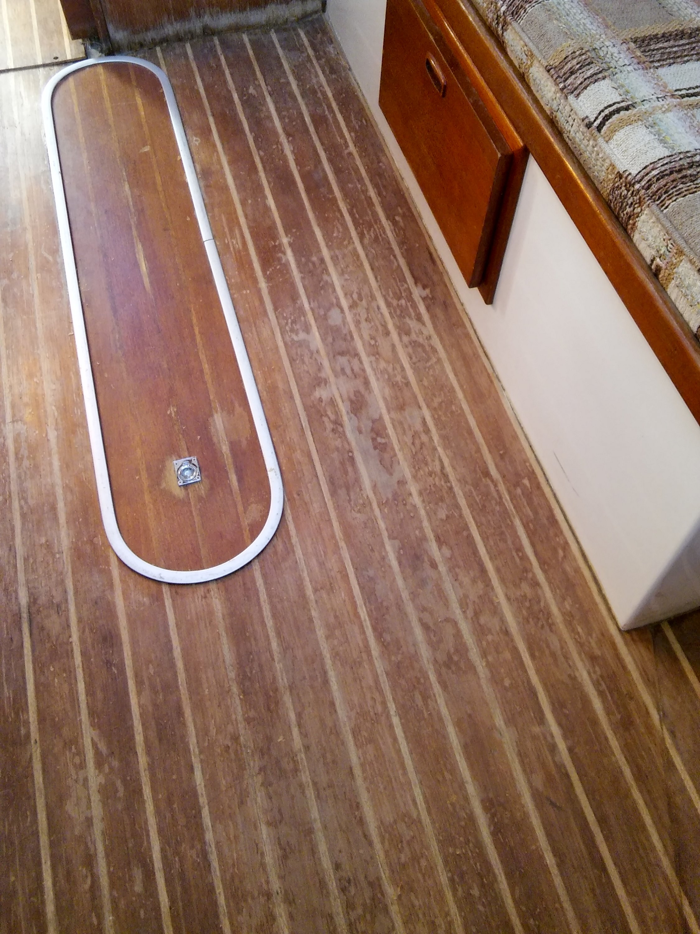

floor closeup.jpg My recently acquired 1980 Hunter's cabin sole had been neglected for many years it seems.
In searching the site I didn't find anything relating to the kind of staining mine has. It seems the spots where the varnish failed and flaked away just kind of "grayed out" or bleached to a lighter color. These pictures are after an arduous day scraping. No sanding yet, the veneer is very thin so I wanted to see if anyone else had encountered this situation. Thanks for any help.

take some LA's Totally Awesome and clean it and see what you have then..... that sole from the pic doesn't look all that bad

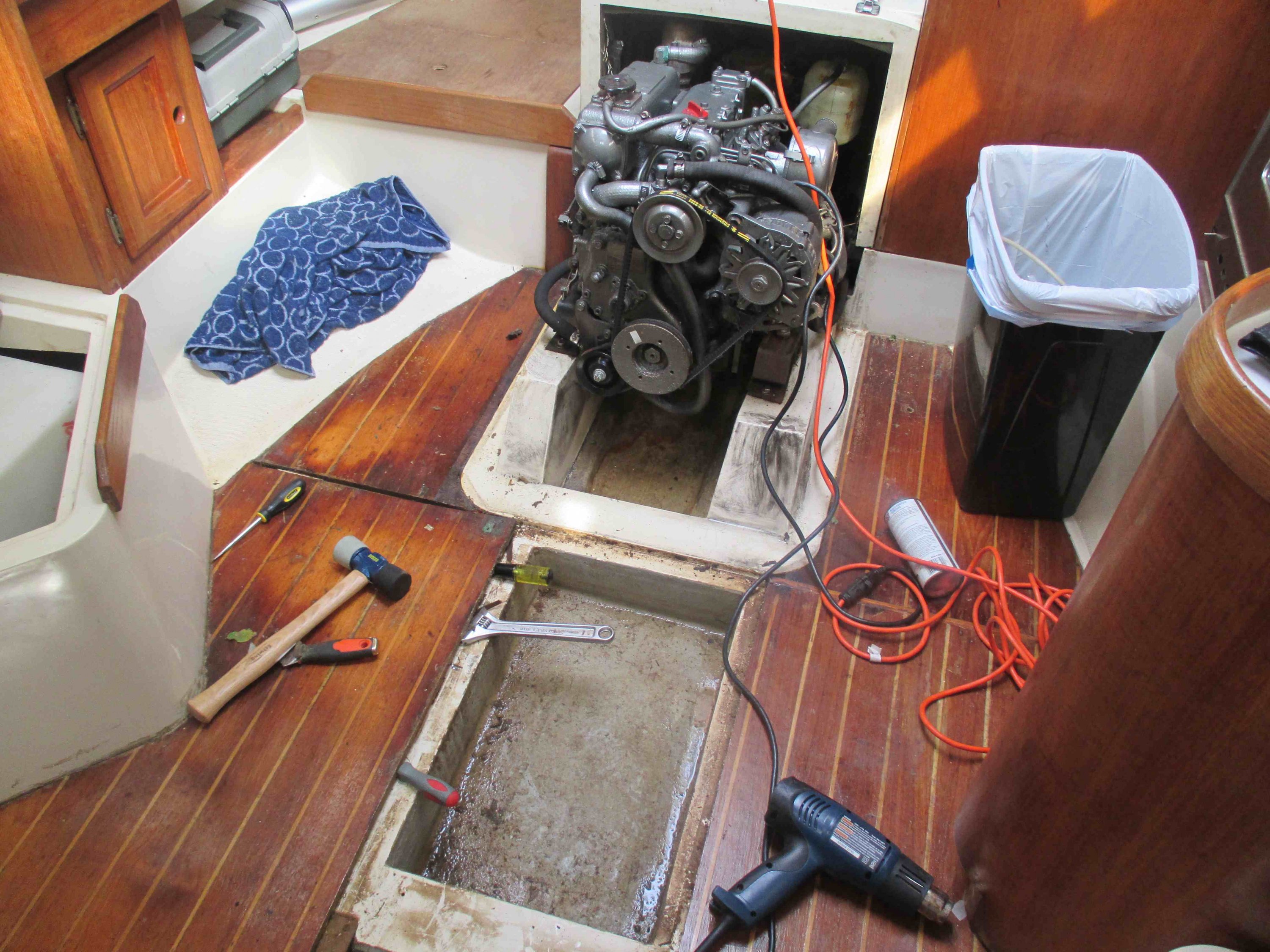

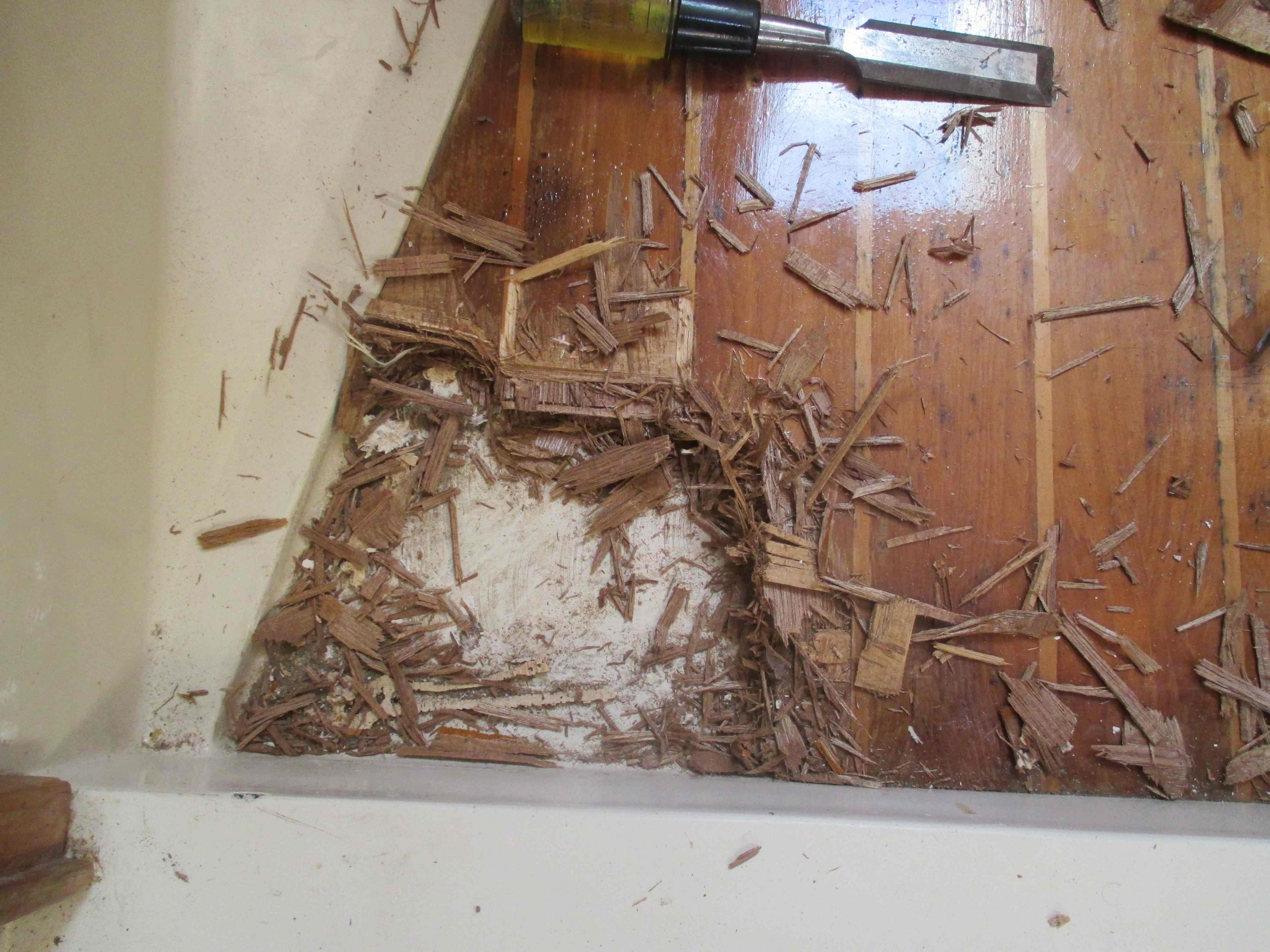

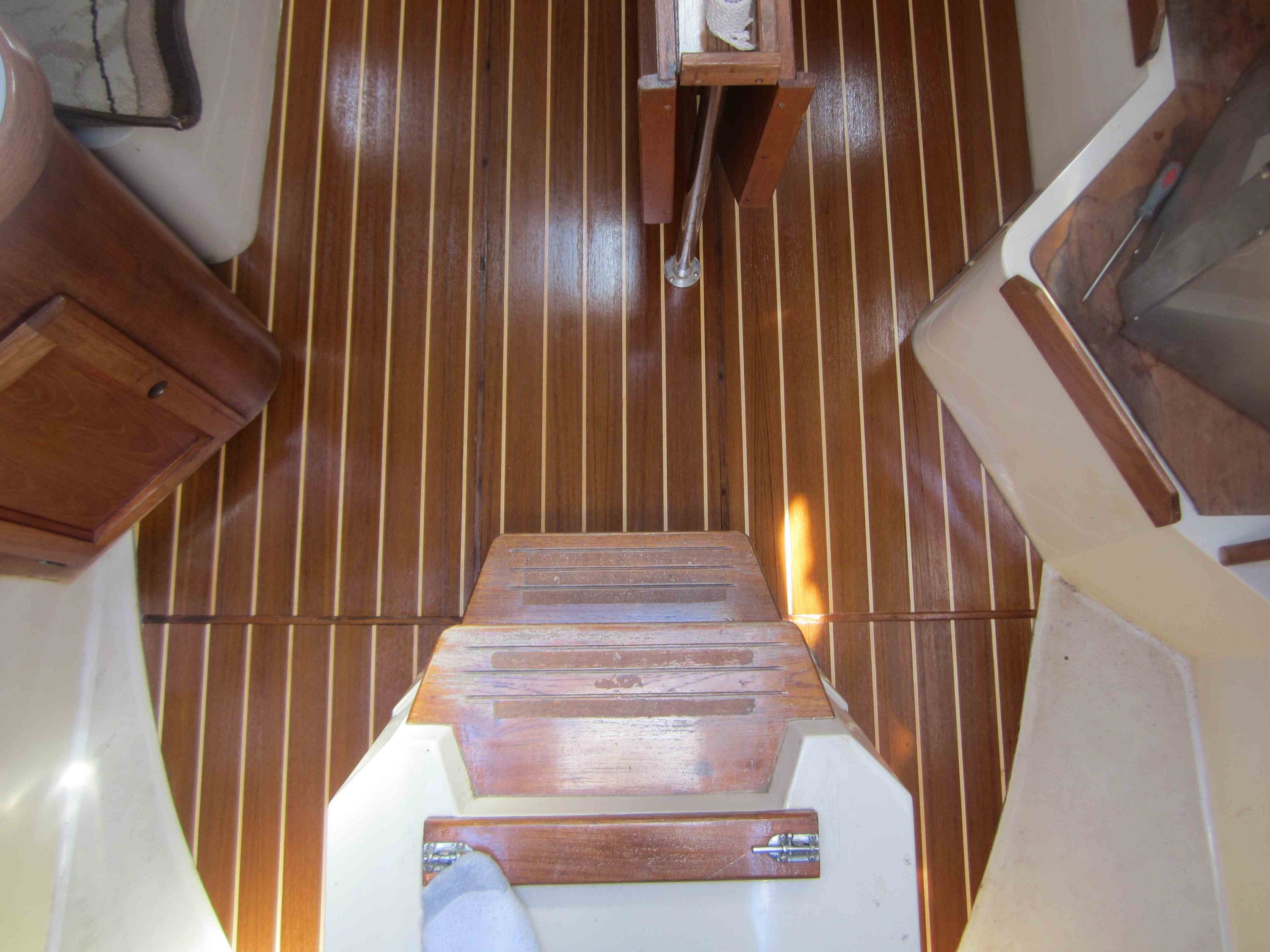

I am replacing portions of my sole, it is a PITA. If the plywood does not feel soft I would take a chemical stripper or a heat gun to it, then some cleaner and brightner or bleach the teak (do some research) and see what you have. I started out on one of my bilge hatches. It has worked well so far. I am getting ready to strip the old varnish off the old wood.

Nice work on your cabin soles/hatches. Woodster, LA Awesome looks like a cleaner degreaser, and since I spent about 5 hours with a heat gun and scraper, I'm afraid that it would mostly just temporarily wet and darken the wood that's been bare all those years. There's no dirt or residue to clean I swear! If you have experience with that process succeeding in a similar case I'd definitely try it. Maybe it reacts with the wood or something?
If not, I have some citrus stripper I can try. It looks hideous, and maybe it'll be a matter of laying on my belly artfully staining the blotches to match, and hoping when I varnish they the good parts still match. It'll be a loooong process if nothing else works.
You see the floors glued down. Dang.

A Scotchbright pad is good for sanding without being too aggressive and not leave any residue behind.

Ken, I replaced two portions of the sole with new pieces of teak and holly, and I am refinishing the existing pieces that are still good. To test the idea of stripping and refinishing 35 year old wood I took the bilge hatches home, stripped and refinished them. I used the method shown in this video, two coats of the epoxy West System 105 and 207 hardner, then three coats of varnish. Here is a link to the video, I have also used this on the new pieces with two coats of epoxy top, bottom and sides and varnish Pettitt Captains Varnish 1015 on top.

Scotchbrite is an excellent low risk idea! One or two strips of the holly veneer lifted on one end. Didn't caliper it but maybe 15 mils. Scary.

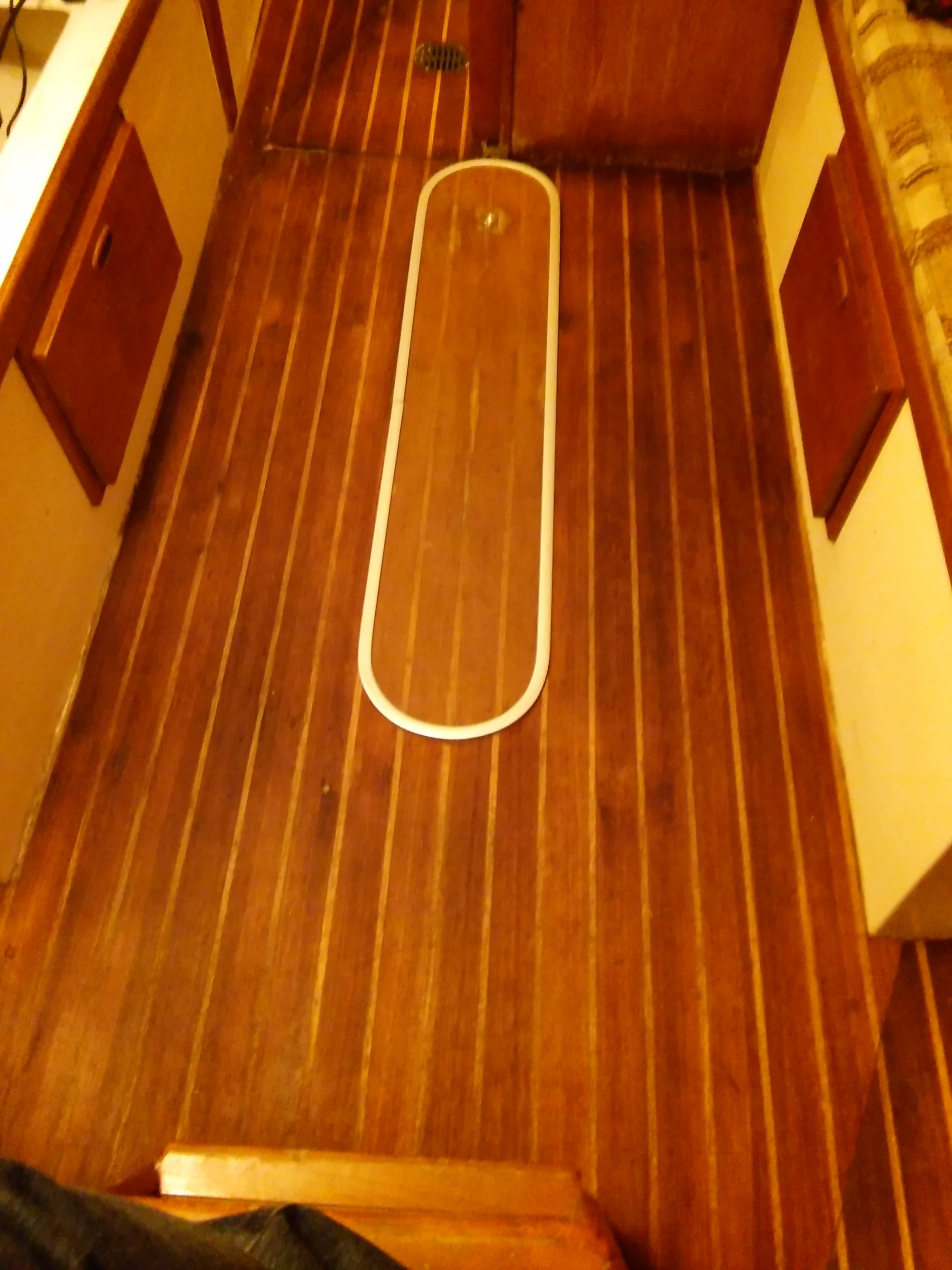

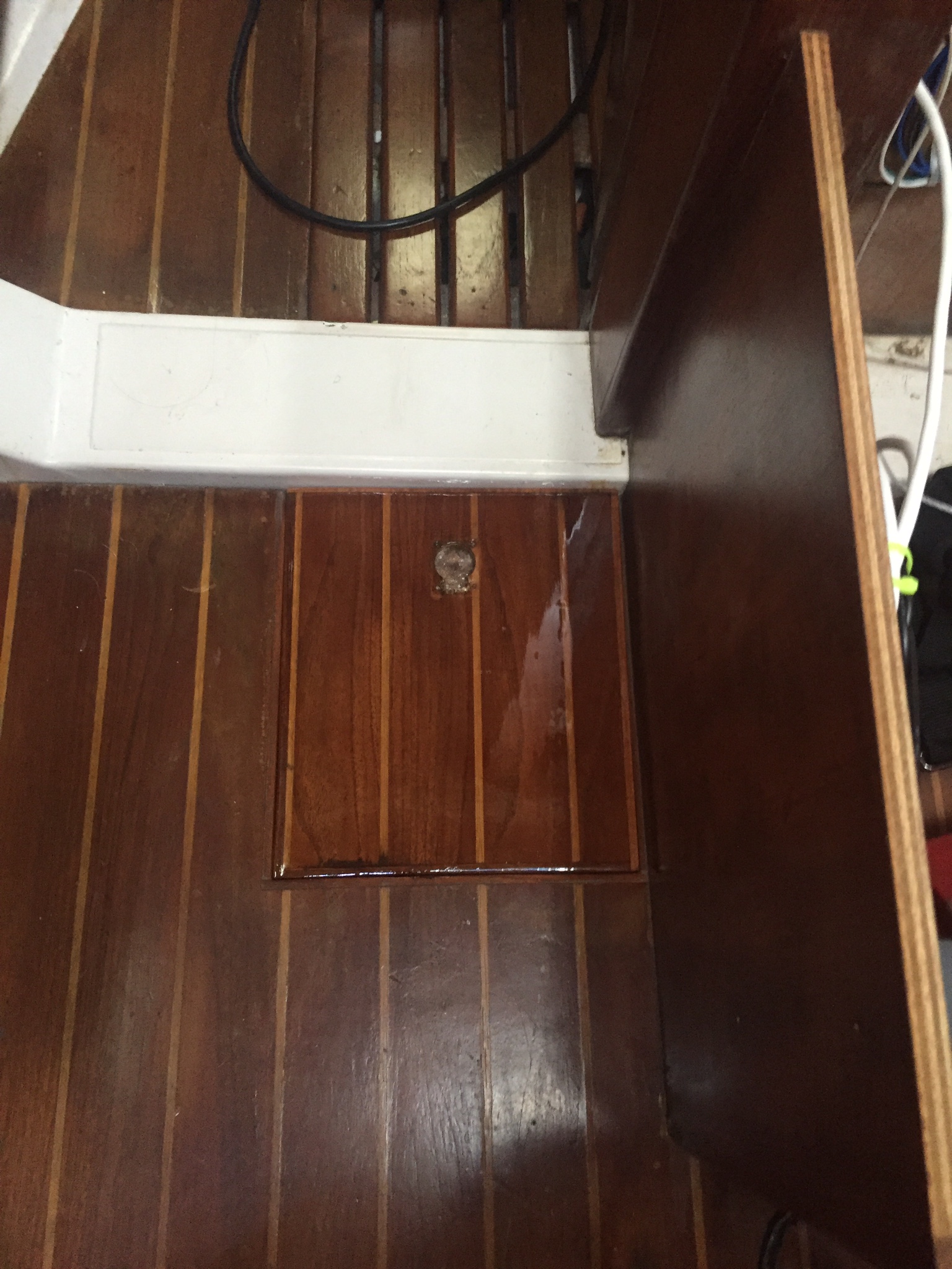

Here's the cabin sole after heat gun and scraper, citrus stripper, and a cleaning with odorless mineral spirits. It is still damp from the mineral spirits and looks less blotchy then when it was truly dried but I believe this approximates how it will look finished, minus the gloss of course. The bilge cover is undone- the "before" photo.
I can't believe how easy the stripper was. I would never bother with a scraper and heat gun again, just way too slow and tedious.

I used "Citristrip", and it must be pretty good because I was short on time and it was only on the deck for about 45-60 minutes. The temperature was only as high as my space heater could get it too. I was in the closed cabin the whole time, and didn't feel any ill effects from fumes, nor did I have any cognitive problems afterward. Anyway, can't wait to get back on my Jeanneau and finish the job!

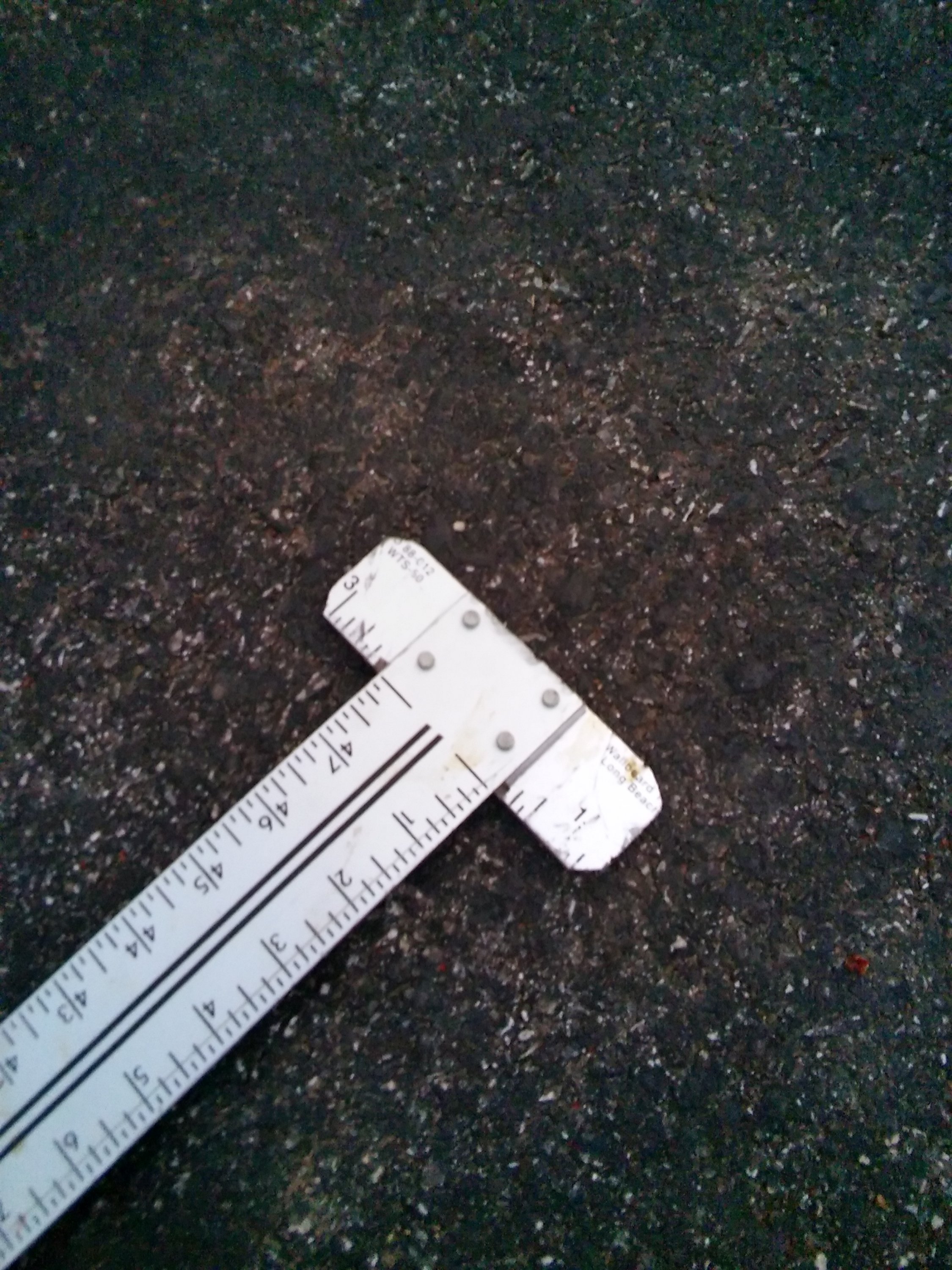

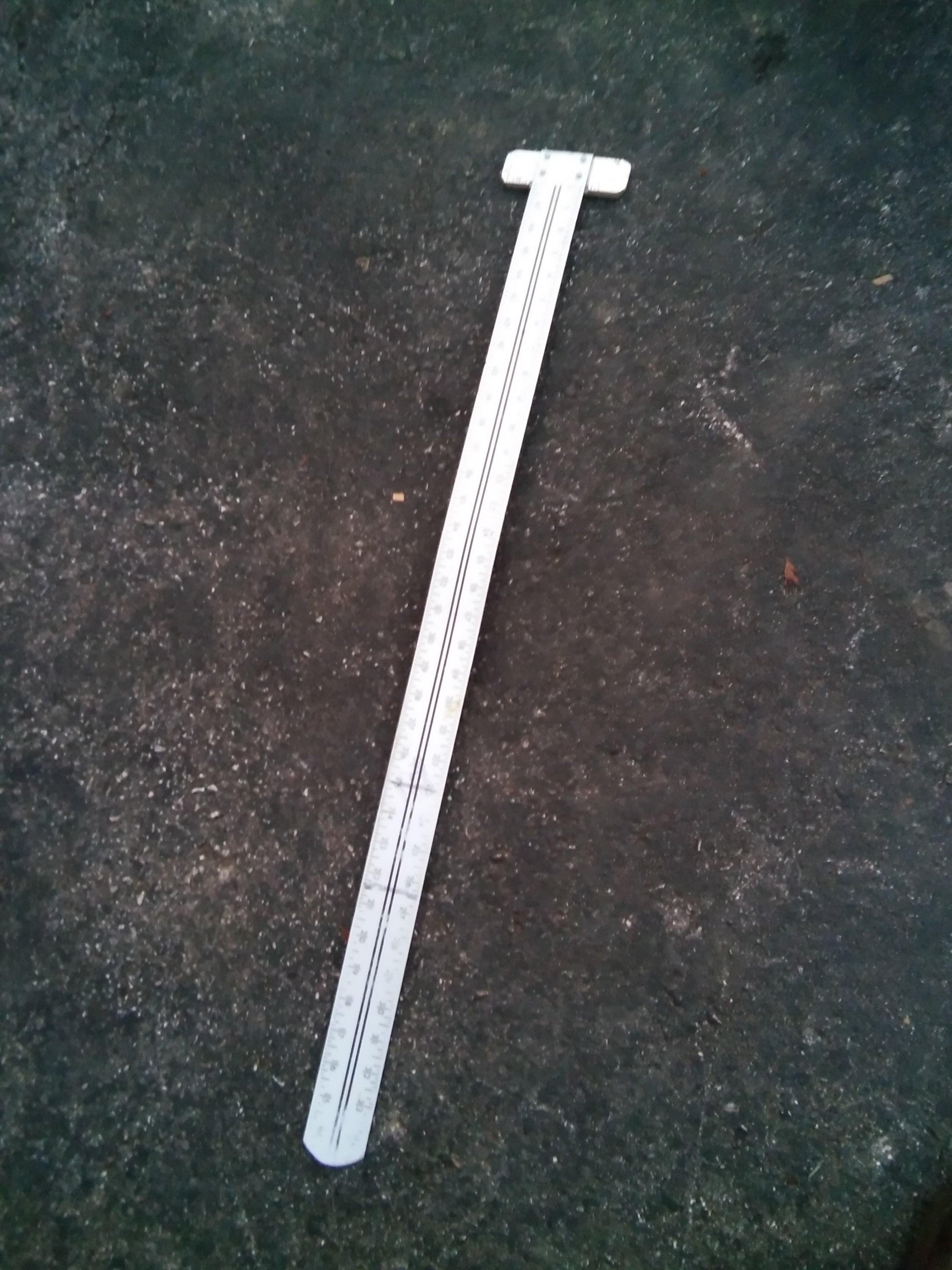

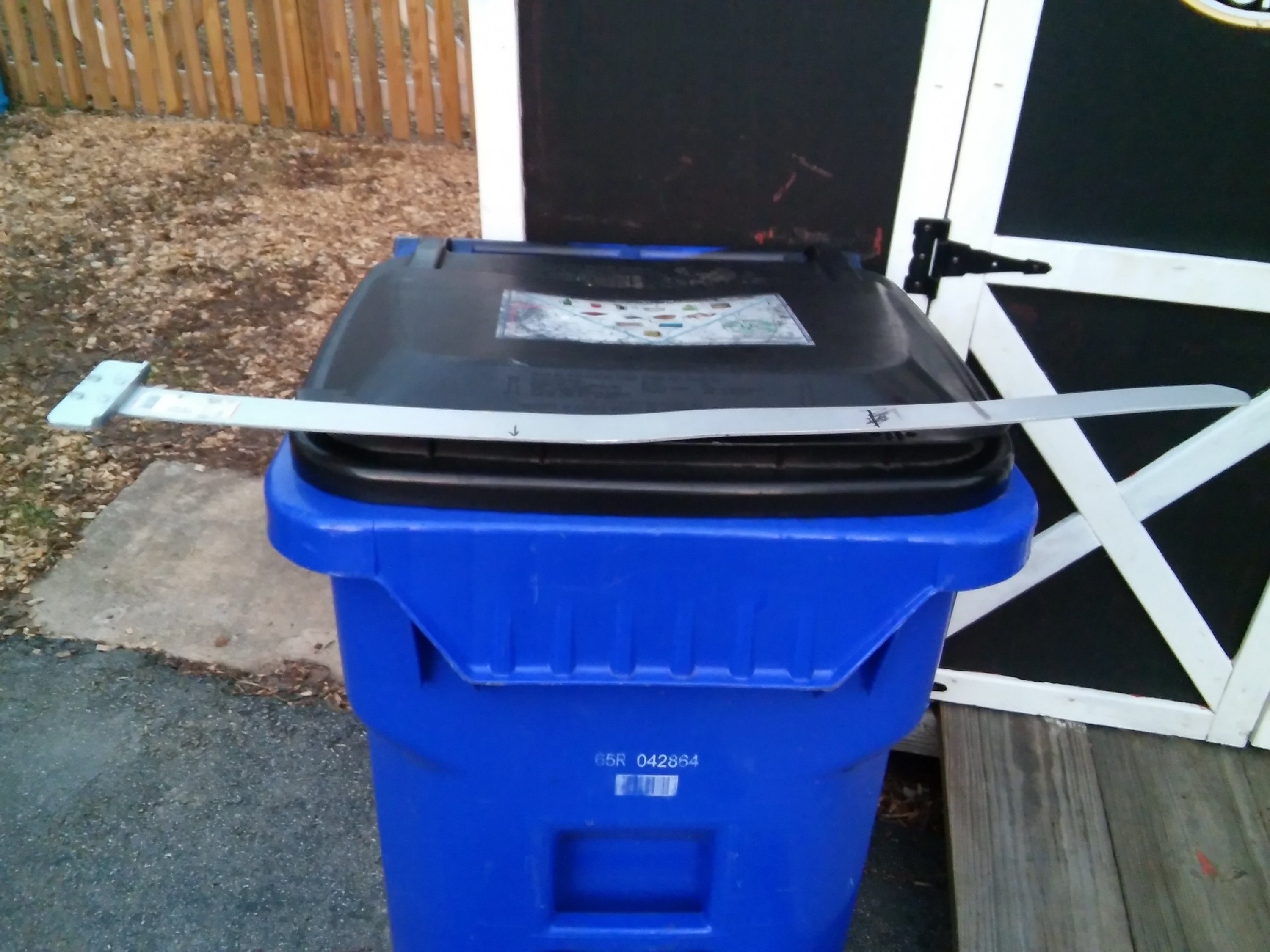

Here's the tool I "invented" to separate the plywood cabin sole from the fiberglass floor pan in my H27.
Just an old drywall square chopped down. I wore thick gloves to use it but you could also wrap the handle end with some sturdy tape. Just necessity mothering another tool. As you can see it bent easily which helped when quarters were tight.
