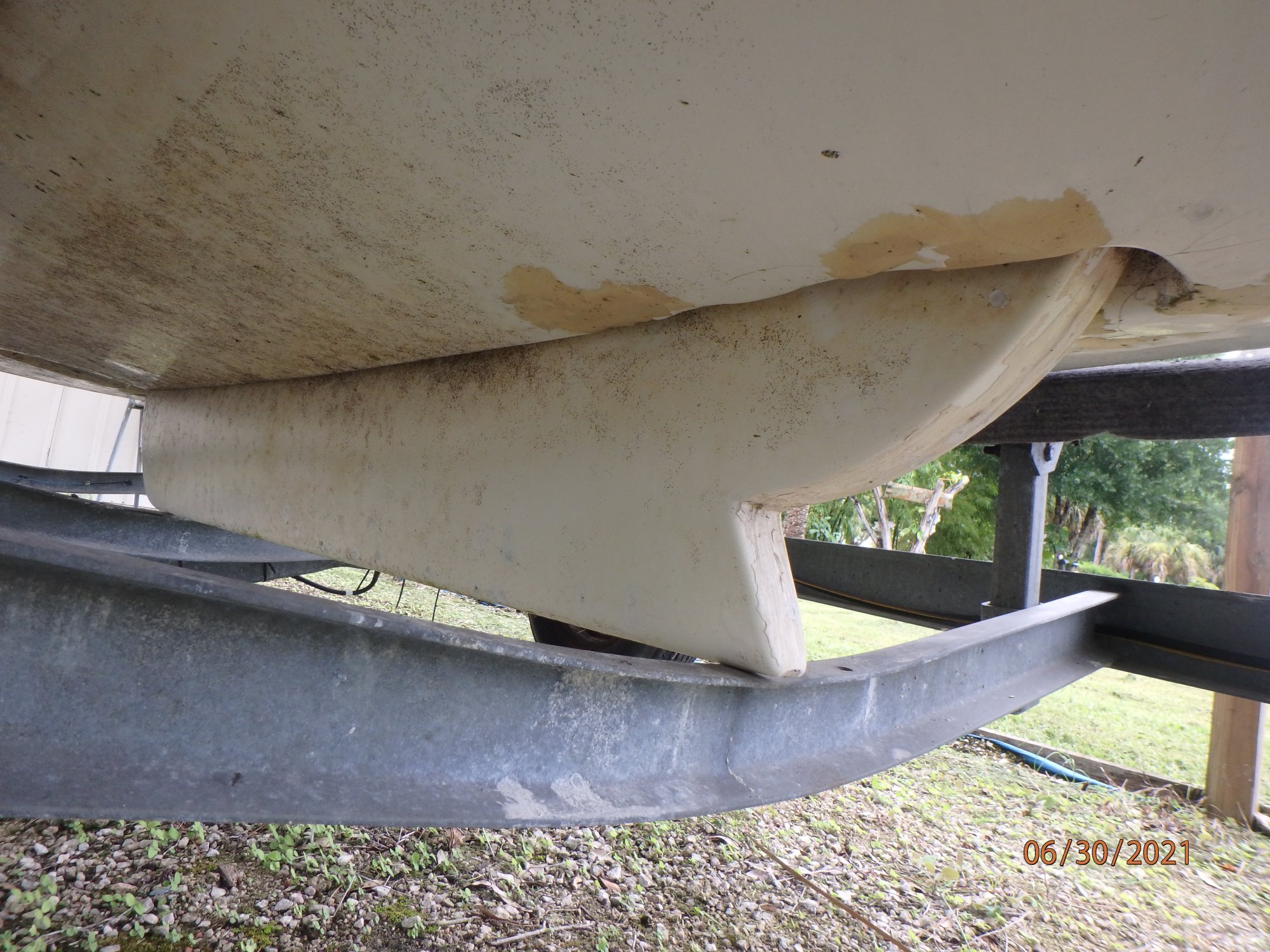

It does look like there has been some work around the trunk.
However, it also looks like shipping more of the CB up into the trunk wouldn't leave enough rotation on that notch to allow for full lowering.
With a car jack, and a padded block lift the bow off the trailer and see if the CB lifts with it.
