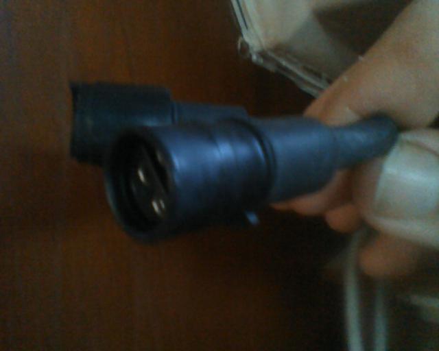

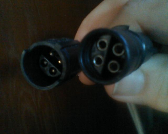

Finally getting ready to swap out my Mariner SR Nav-5 with a Nexus NX-2 system.
I'm trying to reuse the existing cable.
The wind sensor uses a connector like the ones pictured below.
Lo and behold, hidden in a compartment of the cabin I found these same connectors in the Nav-5 wind sensor cable.
What's the chance of finding the same type connector aloft?
Anyone have a source to buy a couple of these?
CommNav and dealers have told me the connector itself is not available.
I believe it to be made by Amphenol-Tuchel but have unable to locate it.
Digikey, et al, has an Amphenol of the same construction, but not the same configuration.
If I can't find it, I'll just have to make up a short inter-species adapter cable.

I had to replace the same connectors and found that a four prong trailer connector was the same thing and at under $10. I reused the boots. I picked them up at O'Railey Auto Parts

The set back half seems to be the problem. The Amphenol 44 series does that, but only comes in DIN configuration. And is larger.
As to wireless, I considered that. There is an NX-2 wireless. But reading around, I see lots of "had to re-join it to the network", and battery (yes the solar cells charge batteries) problems stuff. Admitedly, more so with TackTic than Nexus. But I already have usable wire up the mast. And wire usually doesn't get "confused".
If needed, I'll just cut on a different connector onto the pigtail of the windvane.

That looks like a plain ol crimp on connector that a good auto parts store would have and you'll have too make up four then after inserting and checking that it works slide some heat shrink over the whole connection and forget about till the next time it needs to come apart
