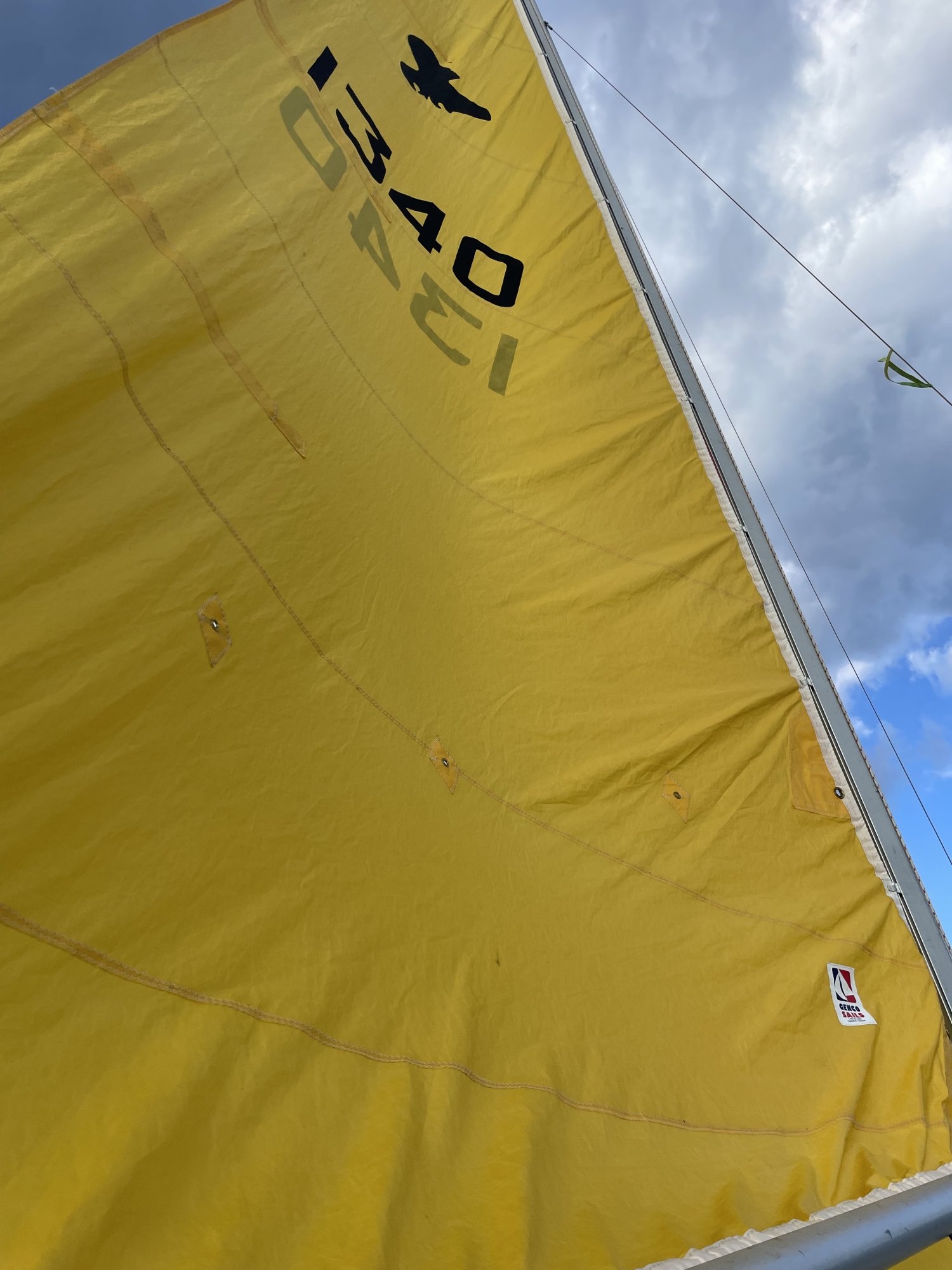

Hello,
I own a Siren 17 and it feels like there is too much slack near the foot of the mainsail. It is attached to the boom. I am not sure how much slack is reasonable or if it would impede the sailboat. There is the option to lower the boom and that seems to stretch it out more, but I would rather have the additional headroom if it is all the same. I included an image of the mainsail; it is fully hoisted.
Thanks!

Pictures from some other angles would help, but the wrinkles don’t look great. I could think of three causes, though there may be other possibilities -
- the sail could be the wrong size like kappy suggested
- the bolt rope could’ve shrunk, keeping you from hoisting the sail as far as it should
- you may have raised the main while the sheet was still tight, keeping too much tension on the leech and keeping you from getting it to full hoist.
8,160
No, no no! Something's wrong. I think the simplest thing to do is lower that boom. Headroom on a 17' boat is an illusion anyway. But I don't think that would even fix that sail.
The sail should be basically flat. Make sure the outhaul is tight and then some. Make sure reef line if it exists, vang, mainsheet are all slack. Tighten the halyard, wait and retighten it several times.
Then call a sailmaker and get a decent sail.

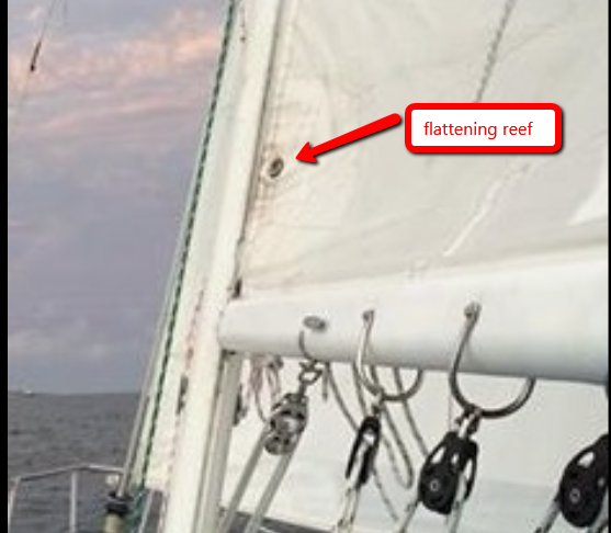

It could just be the angle, but this sail does not appear to have a cringle for a flattening reef. Your best bet is lower the boom. It should be low enough that you have just a bit more height that you can raise the head when fully hoisted. The sail needs to have tension on the luff. Outhaul on the foot will also go a long way to making the main look like a real sail.
On many small boats, the luff is tensioned but hoisting the sail until it hits the mast head and then the boom is pulled downward to tension the foot.

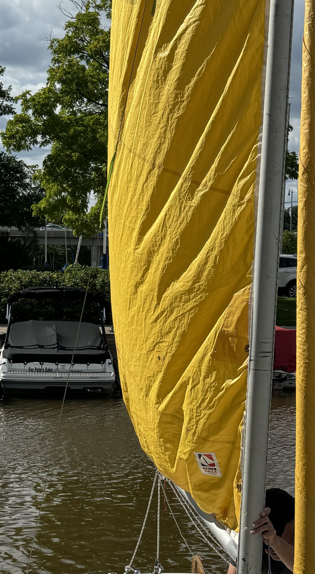

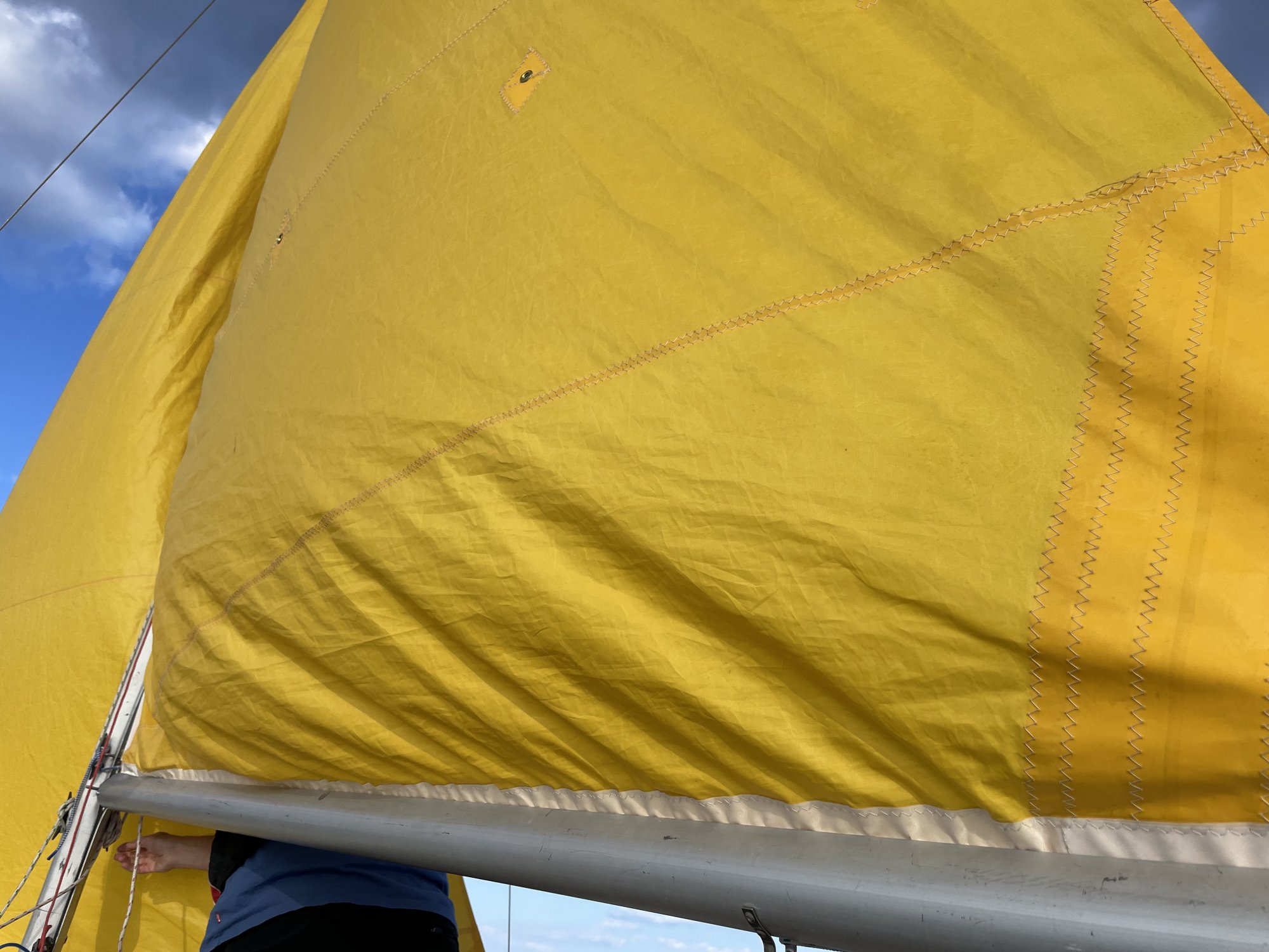

Hello! I wanted to update the thread. I have lowered the boom and tensioned the outhaul, but even now it feels as if there is too much slack. Here are three more shots of the sail. The first and third show the slack on the leeward side of the sail. I need to mess with the downhaul, as some of you have mentioned, or else replace the sail. Can someone tell me: is it normal for sails to puff out like that?

It looks like it's an old sail in need of replacement. Tks for posting the additional pictures.
Thank you for the help! If the sail is as old as the boat, then it’s more than 40 years old. I don’t know if the former owners ever replaced it. I think I will order new sails for next season. That’s the likeliest explanation. Cheers!
edit: I remember the previous owners told me they bought those sails, so I imagine they are not older than 5 or 10 years.
