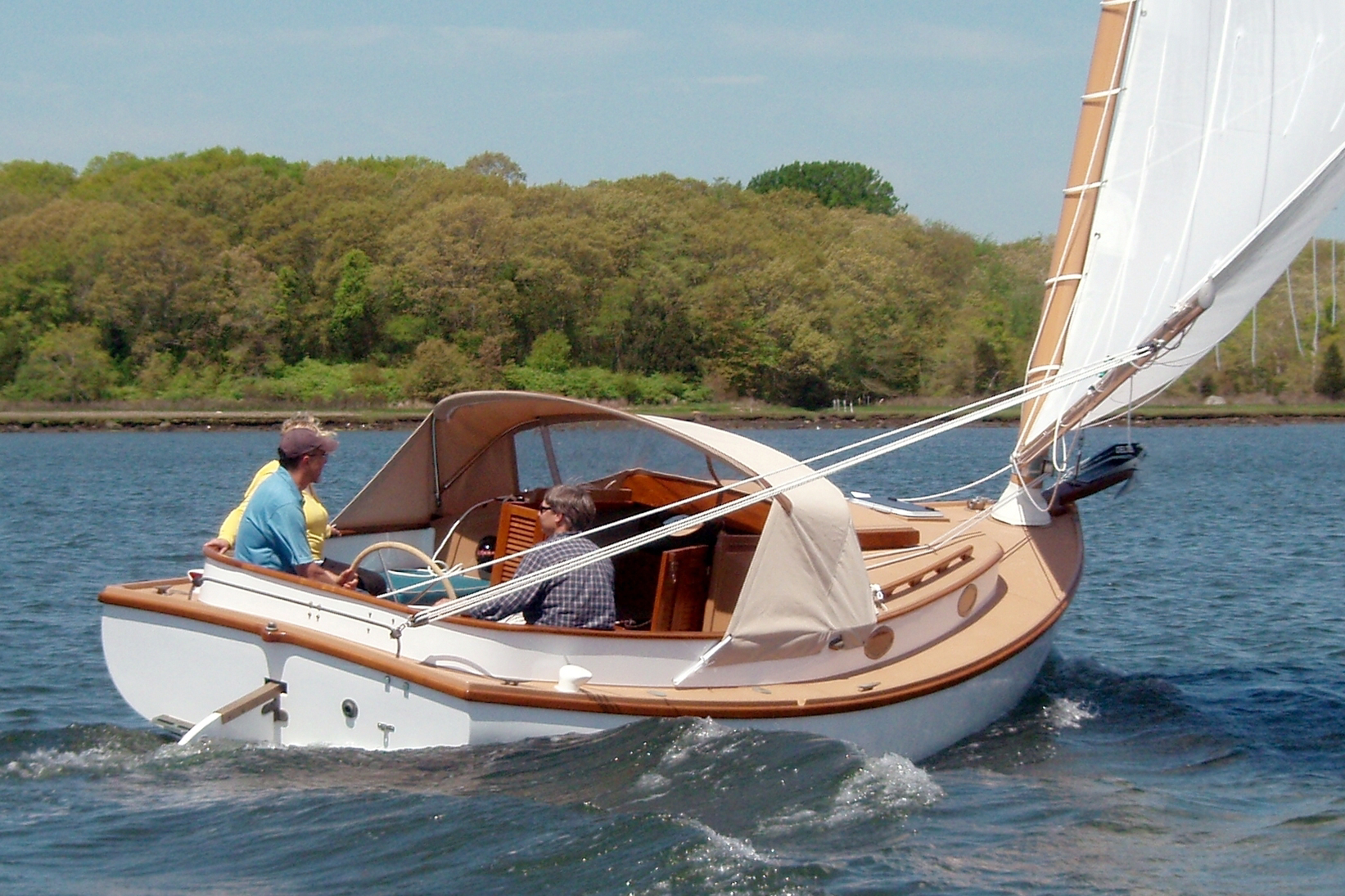

And consider a Freedom sailboat that has no stays or shrouds…
All depends on how the boat was designed.
