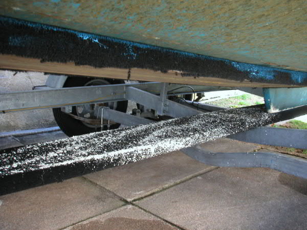

I took my 2002 H260 out of the water this weekend. I was a little surprised to find, what seems to be, flaking paint coming from my water ballast tank. I have only used fresh water in the ballast tank with 1 quart of lemon scented bleach each season. Any one have any idea whats happening here? Appreciate any info. Thanks, Bob Fliegel

Maybe too much bleach *yks
You may be overdoing the bleach a bit. I keep my 240 in salt water, use about a pint of bleach (a year), haven't had any odors, or anything coming out of the ballast tank. Marc_B

I have exactly the same thing
...except it happened after my second season of owning this boat. If I took a picture it would look just like the posted picture. She spent her first 7 sears in salt water, and I've now had her in fresh water for two seasons. I don't add anything to the balast tank. I thought maybe it was "salt-water stuff" that got got loosened up and flushed out with the fresh water, but there was so much of it I found it hard to really believe.

I don't know, maybe...
lack of use this year, yuk yuk? Gell coat(hope not)? Any of the same last year? alan

Does chlorine attack polyester?
If so, that might be the answer to your question. Maybe try Lysol or a similar disinfectant rather than bleach.

Bits of rubbish??
Looks to me that this white stuff is fine shavings of glass probably from when the yacht was built. It is still quite a "new" yacht! Would it be worth getting the stuff checked for what it is?

Good point Mark!
There is still fiberglass dust under the sole to either side of the centerboard trunk in my '94. alan

Bleach
1 tsp will disinfect 5 gallons of water. 1 quart will do 1000 gallons of water. Maybe a couple of oz. once a month might be easier on the surfaces...........

Maybe even cut back on that
I think those figures are for emergency purification of water for drinking. I think even less bleach would suffice. Try just a little to see if there is a smell afterward. My first choice would still be Lysol. Won't attack polyester and it it a disinfectant by design. Smells a lot better out of the bottle than chlorine bleach.

Hot Tub Chemistry
Hot tub and/or swimming pool chemistry is a lot less caustic than bleach and might also be easier on the glass?
