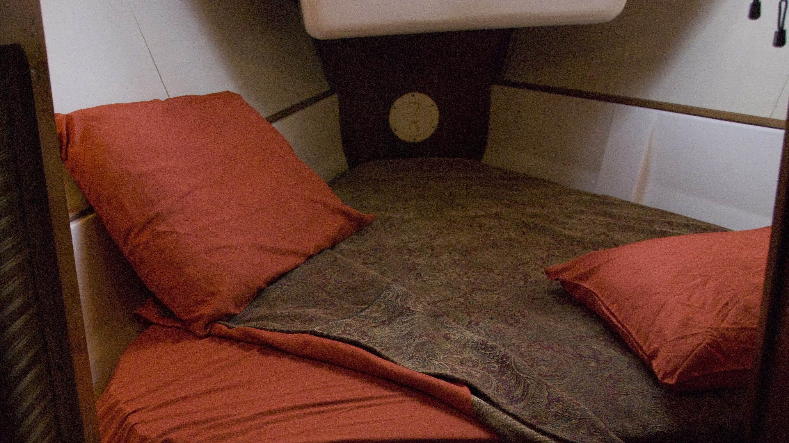

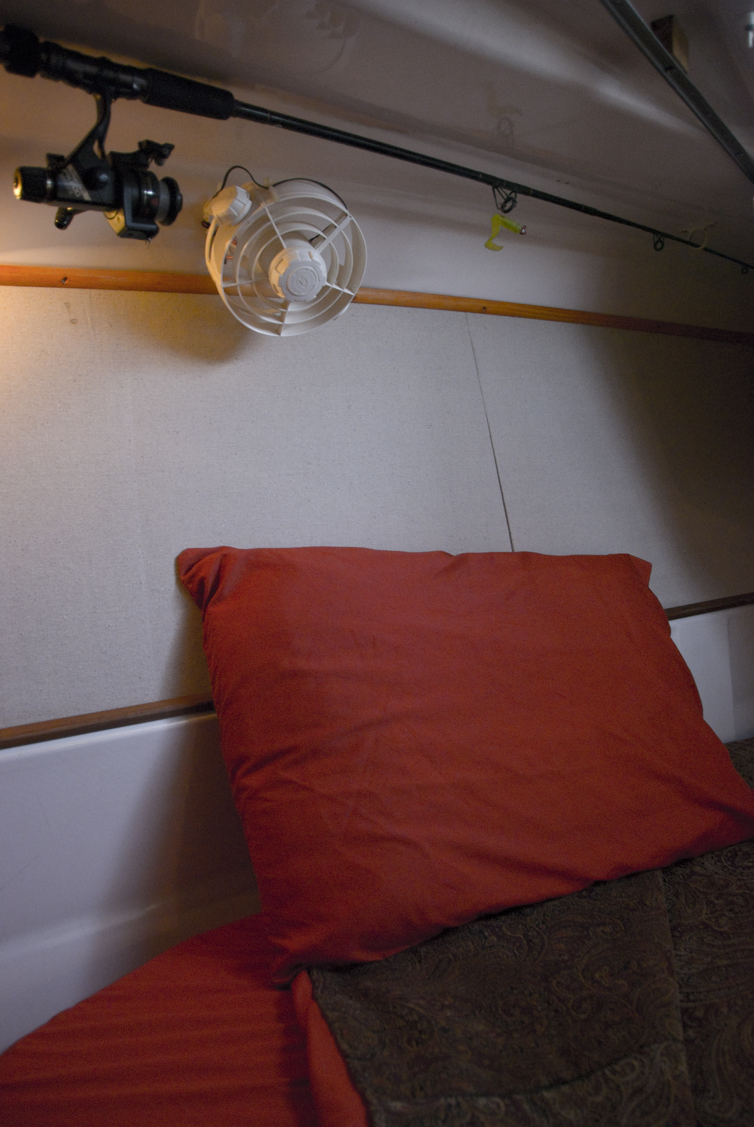

I understand all the pros and cons. I just 'remodeled' our v-berth and was going to tear off and refinish the sides where Hunter had used the grey 'mouse fur.'
After some contemplation I left it (it wasn't peeling or smelling) and attached sheets of insulation I ordered from Home Depot. It's a mylar bubble pack kind of stuff that weighs nothing, has an R-3 value and can't retain moisture. It's sort of like the stuff you put in your car windshield. It cuts with scissors and comes in huge rolls.
I covered that with 1/4" ply panels with fabric contact cemented to each. These are held in place with quarter round trim on the edges. No glue and it's easily replaced.
Oh yeah, it was also incredibly cheap.
I don't know if it's similar to what you're doing but I thought I'd share just to give you some ideas.

Rick - you mentioned using the sheets of insulation. Does that have to be attached or is it just "inserted" between the hull and the fabric-covered ply?
Jul 1, 2004
567
Hunter 40 St. Petersburg
Everything floats
No squeaks, no drips, no errors. I can remove the whole shebang in about 60 seconds by removing the half dozen screws per side holding the top (or bottom) trim strips.
Okay, I confess, I used a couple dots of hot glue to hold the mylar insulation in place. If I redo any part of it again I probably won't even bother with that.
If I get tired of this pattern I'll just use these panels as templates, trim new ones and cover those in whatever I please. I can reproduce another set in about two hours for around $70. $35 for four 2'x4'x1/4" sandable ply sections and the rest for about 3 yards (I think) of fabric. You could do it for less with build grade ply but I've really gotten spoiled by the nice stuff.
The difference in performance is amazing. We've got flag blue topsides in St. Pete, Florida. It's dropped the interior surface temp by about 20 degrees. One of these days I'll get an infrared temp gun on it and I'll give you some specific numbers.
