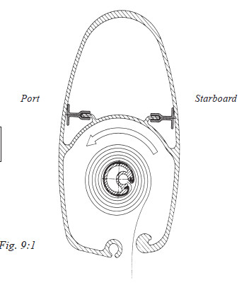

I have been reading through the Selden Furling Mast Manual and I noted that it specifically indicates that the sail is to be furled onto the starboard side of the furler extrusion (with the extrusion rotating counterclockwise looking down from the top). It also says that the furling winch mounted on the mast must be turned clockwise when furling in the main.
On my 41DS, the main is wrapped the opposite way probably due to the fact that the two clutches for the furline line are marked "I" on the left and "O" on the right. Pulling on the "I" side furls in the sail but does so on the wrong side of the furline extrusion because it turns the winch hub counterclockwise..
Can someone with a Selden main furler confirm which way their main is furled and which furler line (left or right) they use to furl in?

I have a 41DS and it is furled as described in the picture!

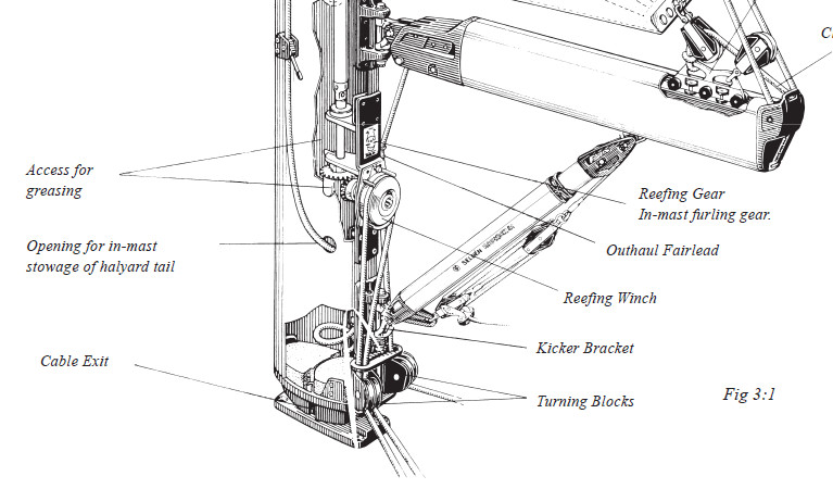

Found out that the two lines are supposed to sort of cross over [...]
The attached image was excerpted from the Selden furler manual (URL in an earlier post in this thread). It doesn't show the furler lines crossing over. On my boat, the turning blocks are attached to the mast base, slightly lower than depicted. From there, the two sides of the loop go through the port side deck organizer blocks and on to the clutches.
I'm going to re-label the clutches so that "Furl In" is the rightmost (facing forward). When pulled, that will cause the furling drum to rotate clockwise as the manual says it should.

Yep, my Selden really likes to be furled as the picture indicates. Note that the slot is slightly offset to starboard. That sets it up to furl more easily on a slight starboard tack, i.e. it doesn't have to make an acute bend once inside the mast when furling on a SLIGHT starboard tack.

Interesting! My furling line does not "cross over from the black at the base" and I have had no issues with furling. Where did you get that piece of information?
There are two blocks at the base of the mast for the furling line. Coming off the clutches on the cabin top the line leads straight back to those blocks, but then the furthest outboard line goes to the opposite side of the winch drum. So the furling line sort of makes an X between the base of the mast and the winch. The blocks are arranged slightly differently on my '07 H38 than that picture.
The labeling on my clutches is correct per Hunter manual. Its easy to tell which side of the winch the "in" or "out" line runs to based on the behavior of the switch on the winch.
