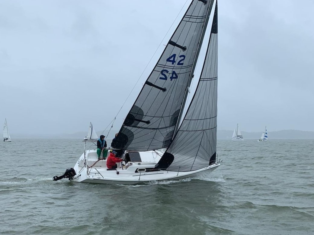

I don't know if you've done anything with your genoa yet, but IMO a genoa works nicely on a fractional rig. The 26.5 came equipped with a 110% jib, but with tracks installed the inboard shrouds are designed to accommodate a larger genoa. It takes a little more attention to manage the slot upwind and not get a luff bubble on the main, but it can really help performance on all points. The large round hole at the forestay deck connection was designed to install the furler lower to have a deck sweeping genoa for performance. Here is a photo I found online of someone's 26.5 with a nicely set probably 135% genoa. There is a Facebook group dedicated to Hunter 26.5's, although it doesn't get a lot of posts. And I'm still trying to get rolling on my project 26.5, but been too busy sailing my other Hunter. Good luck with yours.
