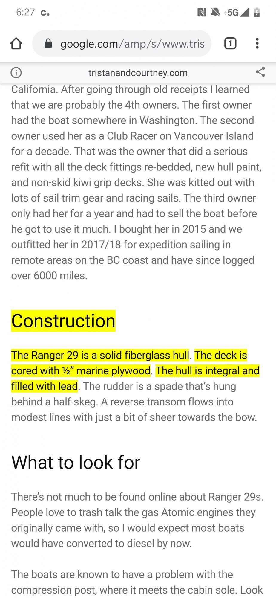

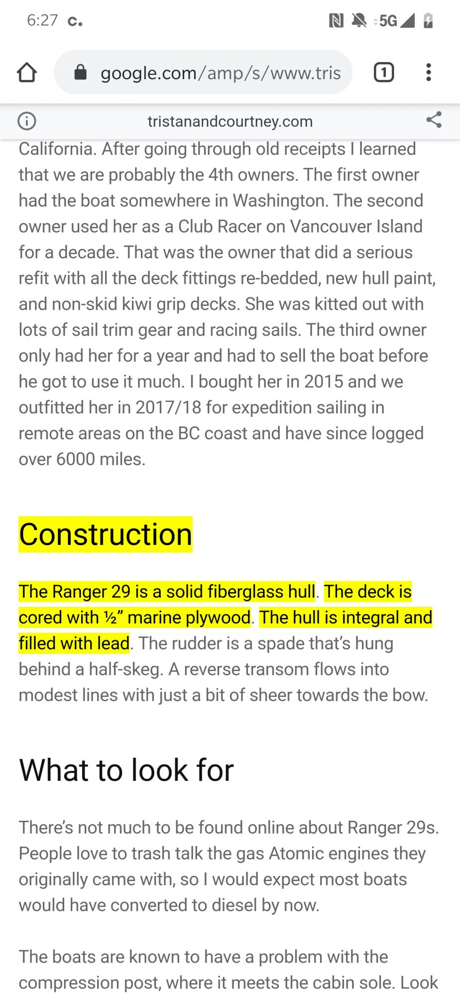

I think "Skins" is referring to a hole he drilled into the overhead from the inside, that he incorrectly called the "ceiling". I don't think an older Ranger 29 had a 'cored' deck, so he's crunched old fiberglass at a location that may have delamination.
If I am correct, I would have the area behind the vinyl checked for delam or
other damage and repair same.
I also agree with Capta and not use a mild steel fastener there or anywhere on my boat.
I too would install a wood block at the location before re-installing any fastener.
