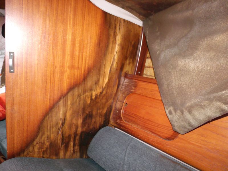

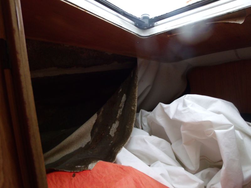

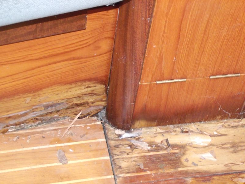

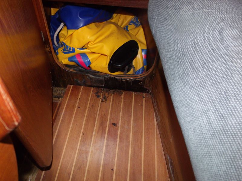

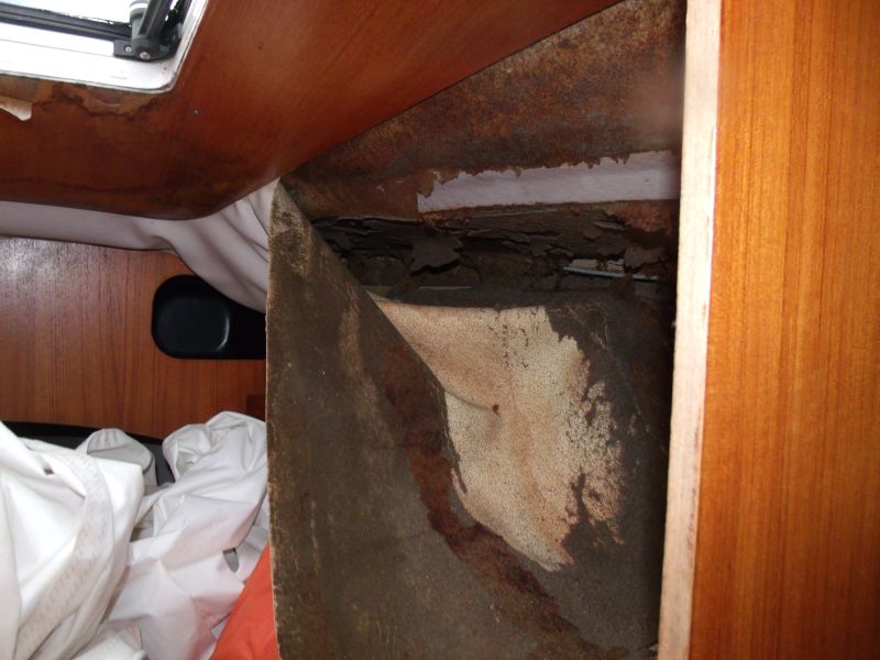

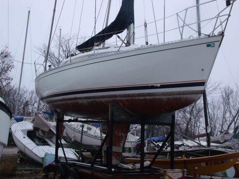

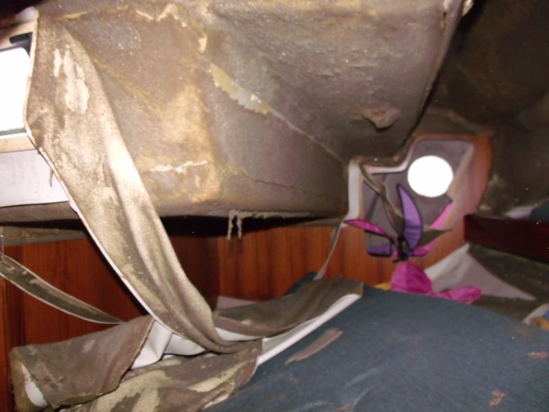

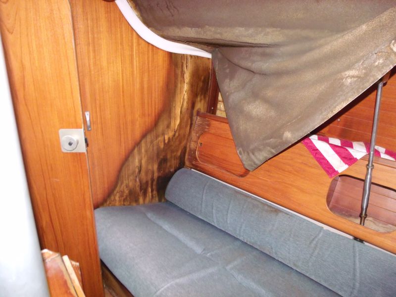

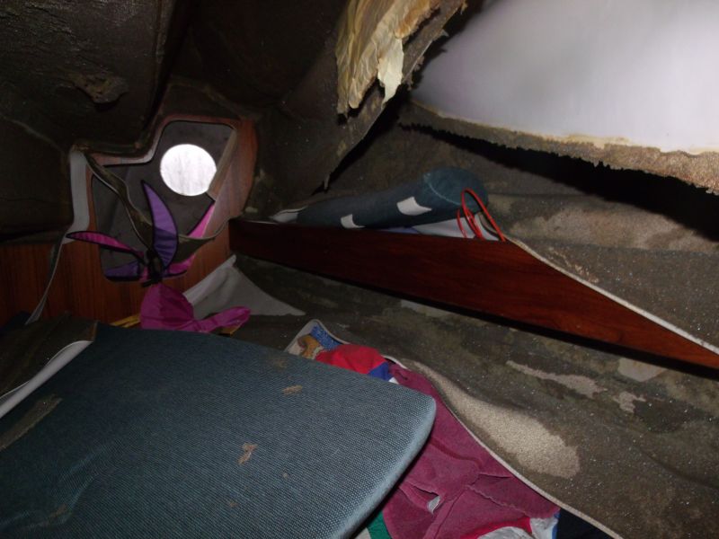

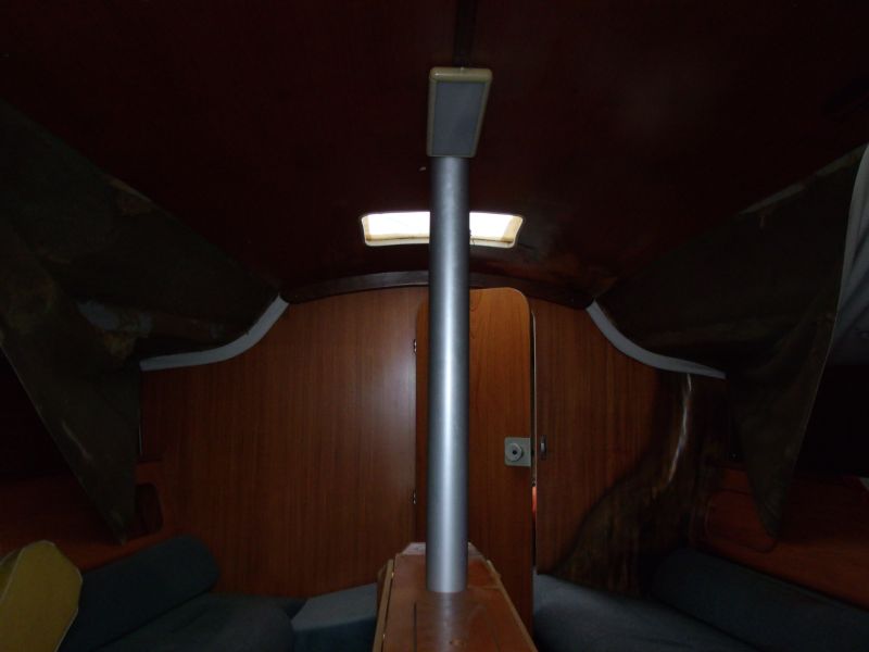

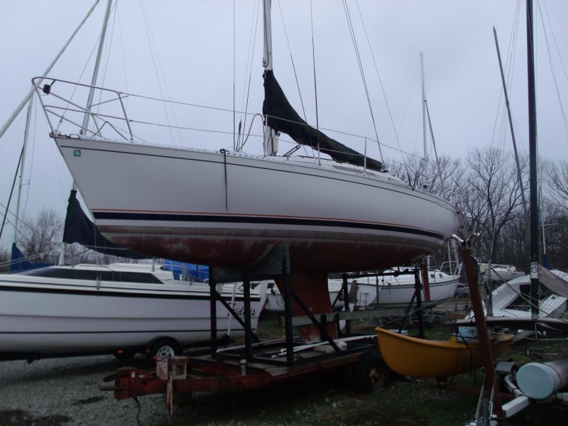

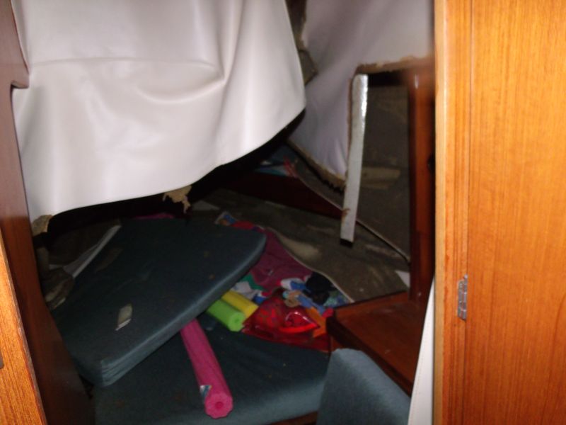

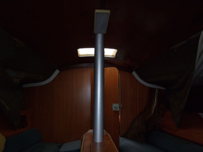

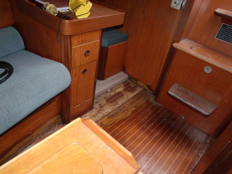

Am looking at a first29 that has had water leaking into it for a few years.
Generally I think anything is worth saving, but the value when finished may underscore the costs involved. I'm sure the sails will need to at least be reconditioned. All lines are shot. Diesel should run, turns over easy by hand. One stanchion is broken leaving a small hole in the deck. All the cushions should be reupholstered. And the pics show the obvious damage.
Is the wall between the v berth and salon a structural piece or can it be removed without causing a failure of the cabin top?
Any ideas on value now and costs involved to return her to former glory?
Thanks for your helpful suggestions in advance.

The "wall" between the v-berth at saloon is the main bulkhead and it is very definitely a structural piece. It can be REPLACED, but NOT Eliminated. Lots of work here. All depends on the price and if you have the tools, facilities, skill, time,to tackle the job.

looks like a major strip out to be sure there is no signs of black mold. like TLW said, its alot of work.given the time and effort and the all mighty dollar, could be a sweet boat.

Best have something else to sail for a while, wonder what shape the core is in???
Nov 8, 2010
11,386
The First 29 has a solid hull, so that will be OK. The deck is cored but Beneteau as a practice uses solid areas where they drill thru the deck. So it it rare for a Beneteau to get wet deck, even with a substantial leak. But in general they rarely leak, and that was a bad one. So I would be interested in where the water is coming in and why. Solve that first.
The bulkheads might be shot, you'll have to look into that. Good news is that they do not support the rig.... the rod rigging shown in your pix connects the chainplates to the hull.
Typical for this era french boat the head liner has failed. It all has to come down. A messy but doable job. Keep the old pieces for patterns. Most replace it with sailrite hull blanket. Getting the old glue off is the big job.

I just completed repairs on a 27 that were similar to yours. You can bet there are core problems in the decking. Your main bulkhead is going to cost a lot to repair and I suggest getting an expert on this part. As for cost of the boat? You should expect to pay less for the boat than the repairs. Therefore, it should come at a very big discount. If you can't do many of the repairs yourself I wouldn't even go there.

Personally I think I'd rather replace a bulkhead than one of those crappy headliners. I hate those things. I had one in my last boat and they suck. If you get the boat, pull it down and paint.
At least the mast isn't deck stepped, so the bulkhead isn't holding it up.

That looks to be a wet and rotten boat. Add up a few of the required material$: marine plywood for bulkheads, headliner material, epoxy, glass and gel coat repairs for the wet deck work. A completely new electrical system. Tools you don't have yet. 1000 hours of your time. All new upholstery. Then go to the used boat sites and search boats for the same cost. You should find something that will require considerably less work and be more durable. Don't worry, you'll still get to work on it enough to make it your own.

The bulkhead is definitely structural. Just make sure you support the overhead with 2x4, 1x6, etc. after removing the old bulkhead.

Several years ago I refurbished a 1974 C&C 35. It was a big project. Took three years. At the time it was the only way I could get into a bigger boat. Unless you have lots of time on your hands, the know how, the tools and patient family members I suggest you pass. There are enough used boats on the market that will take considerably less work and you can start enjoying them this spring. Life is too short. Based on your pics I estimate a $15 to $20 K job.
