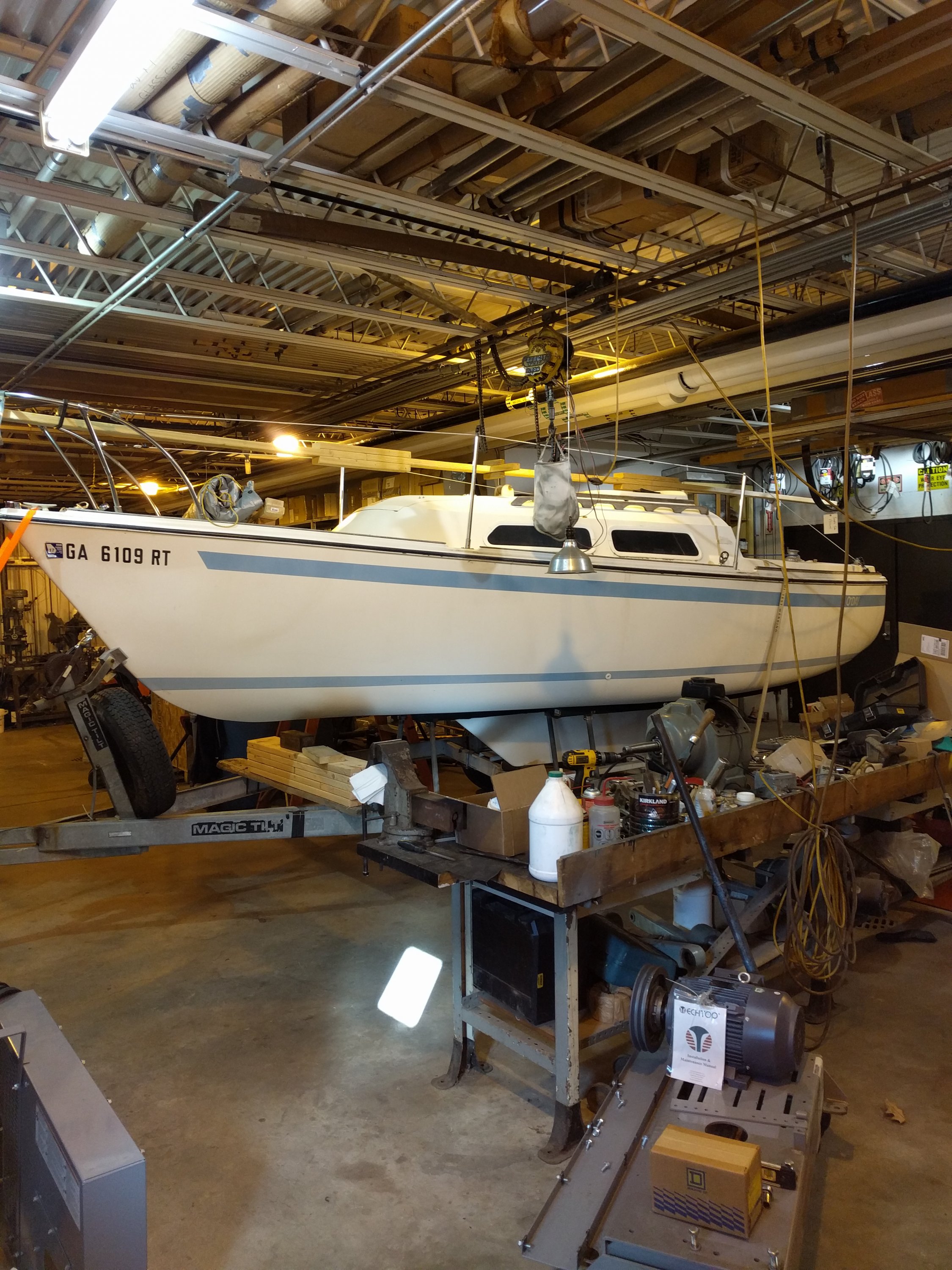

I'm at the point with my winter repairs that requires me to fill in the divots in my Shoal draft Keel but to get at some of the areas that need attention I need to get the Trailer out of the way. On the weekends I am able to put said Boat and Trailer inside my employers shop and my plan is to suspend the Boat from the ceiling with straps one fore and one aft of the Keel to raise it a couple of inches off the Trailer enabling me to access the underside of the Keel for grinding damaged areas and Epoxying over them in preparation for the bottom coat of paint.
My question is it safe to do this as far as the stresses from the weight of a #600 Keel pulling down on the Hull go? I have no concerns as far as the strength of our ceiling is concerned as heavier loads have already been applied to various areas of the supporting structure.
I have replaced the core of the Transom and redrilled all of the various holes and I then moved forward and removed a rotten block of wood that the Bow eye was bolted to and re epoxied and glassed the Bow and installed a 3/8" Stainless "U" Bolt and now I really need to make the Hull below the waterline ready for paint. Everything above the Waterline can come later. I attached a pic of my as yet un named Boat in the shop at work.

After looking at your picture I would not hang a boat from those open steel trusses. They are probably overloaded with what's stored up there.

LeeandRick, you just made me think of something. Our office has open decking ceiling with trusses like that. It's good for holding up the ceiling and HVAC. However, the boss got a bug in his ass once, and decided he wanted a whole building generator after we lost power for 2 days a few winters ago. He though it was going to be cheap like what he had installed at his house. Yeah.... no. Anyway, the guy who came in to quote out the job was like: "Where you gonna put this big generator?" I was like, "On the roof?" and he was like "This roof is not made to support a generator of that size. Would have to go on the ground in the back yard or something."
Yeah, unless you've got some engineers saying trusses could hold the load, I would be very cautious about flat roof trusses like that holding up a boat. But I'm not an engineer, so I don't know for sure.
Oct 8, 2016
53
O'DAY 22 East End Yacht Club
Hi Brian, Yes we have staff engineers and those trusses are supporting a poured concrete floor with offices above. This is a production scale factory that houses 30 to 2000 gallon Reactors and the supporting structures are quite robust. Routinely we have chain hoists supporting loads of up to #2000 at one pick point and I want to hang my boat at around #2200 at 4 separate points so maybe 550 lbs at each of four corners. My concerns were not for the strength of our factory but are that I'm not going to stress the Hull of the boat in some fashion that I'm not aware of. I'm kind of new to sailboats and I feel that if I support her from slings right in front of the keel and right behind the keel I can raise her a few inches so I can do my prep work for painting. I think that the hull is probably thickest at these points and not going to be a problem but I wanted to check with forum members first before I started to lift.
