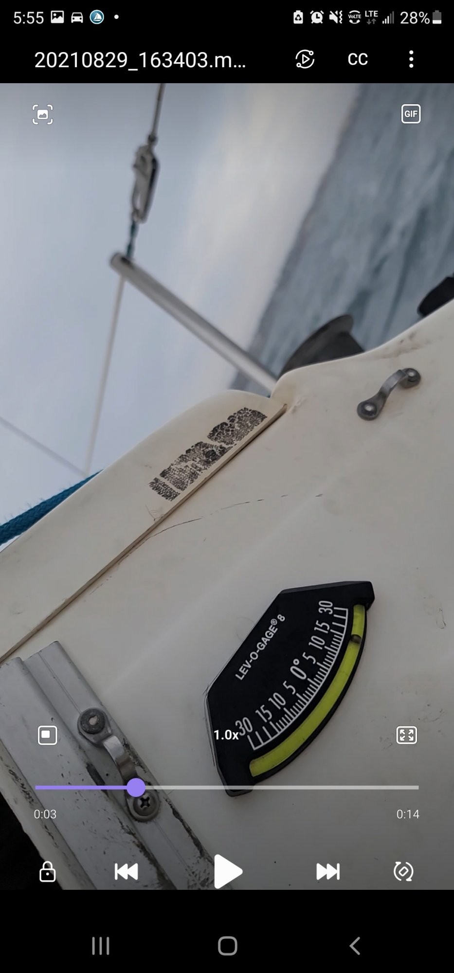

I'm not a sailor, I have a combined sail time of 8 hours lol. Went out for the second time today and hit my new speed record of 8.5 knots with a good amount of wind. I may of panicked once or twice when I could reach over and put my hand in the water. My question is realistically how hard is it to tip a sail boat???? Is there any specific wind speed where you should just use the main sail?

The inclinometer shows a 15° heel, for many boats that is in the range of an optimal heel angle (15° to 25°).
New sailors often find this amount of heel disconcerting. After awhile you get used to life at 20°.
