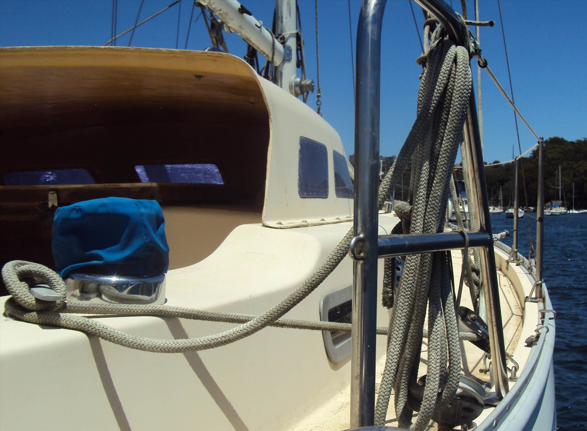

i was thinking on a dodger like this one. seems very doable but , not sure if i can get one like this or not for a reasonable price.
