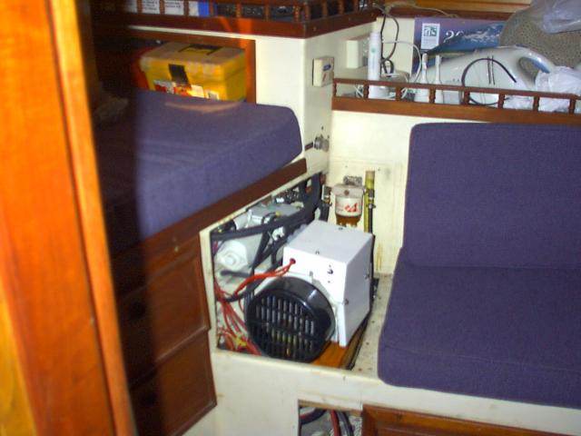

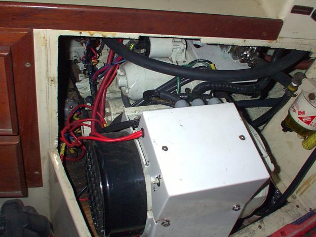

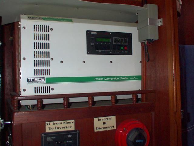

I have a 2500 Watt true sign wave inverter with a 150 amp multi stage battery charger on 650 AH worth of batteries. I have it on 24/7 pier-side, at anchor, or underway. It has a battery voltage monitor with three different voltage/time set points, and when the batteries drop below any one the set-points or the demand is excessive it starts my diesel genset automatically.
I don't use it for heating water, as I have a tank that I use when tied to shore-power or underway when it is heated by engine coolant. When on anchor for extended periods I have a propane instant water heater that I use.
Beside using it for a battery monitor, Microwave, Toaster , Coffee Maker, Kitchen Mixer, extra AC lights, power tools, and a portable freezer/refrigerator, I use it to drive my 600 GPD AC water-maker. I have had it running constantly and just recently after about 12 years it has a short in the battery charger side, so I have to pull it to have it serviced. I have become so dependent on it that I really don't know what to do without it.
