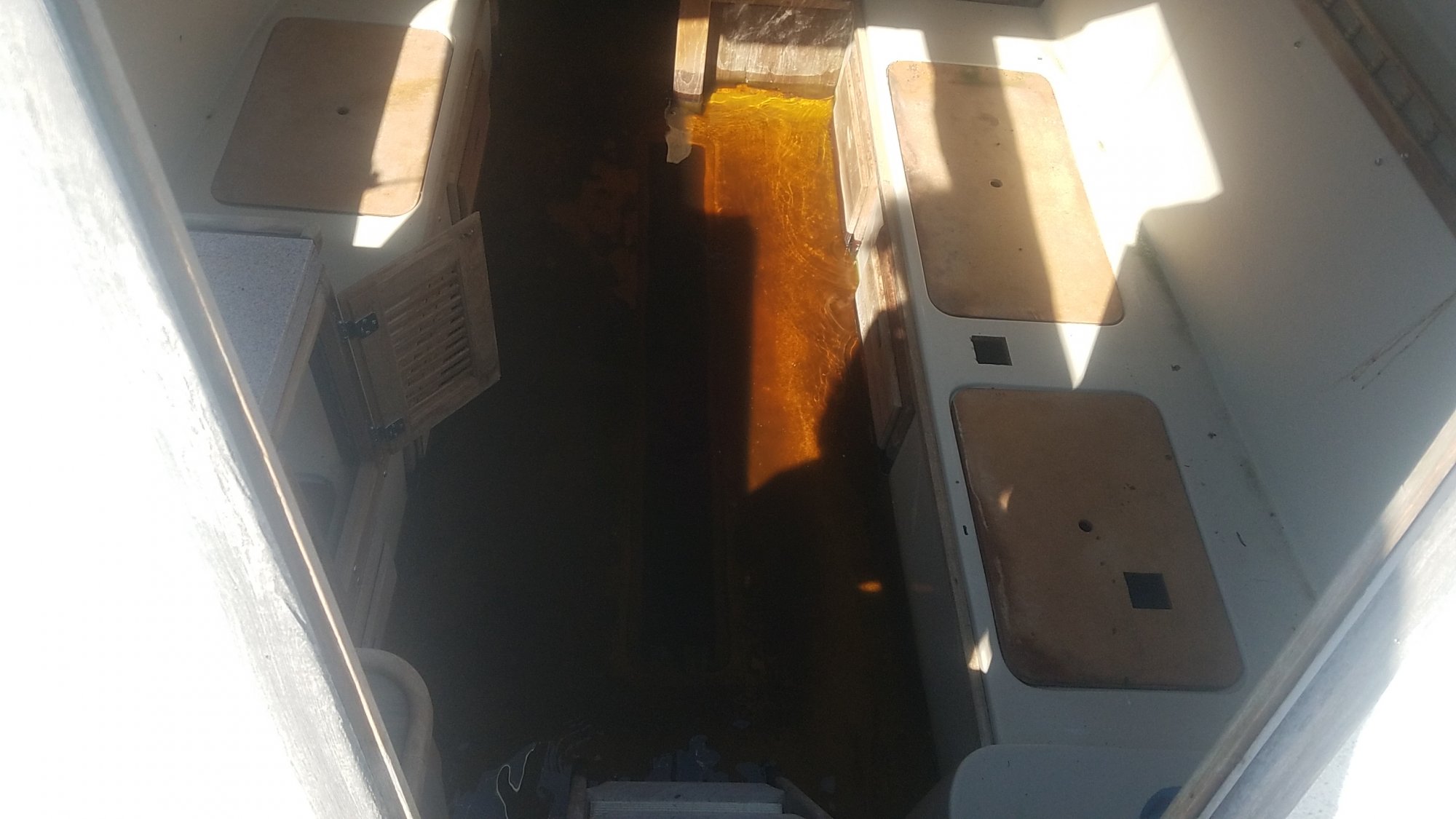

Is a interior mast pole done at this stage?

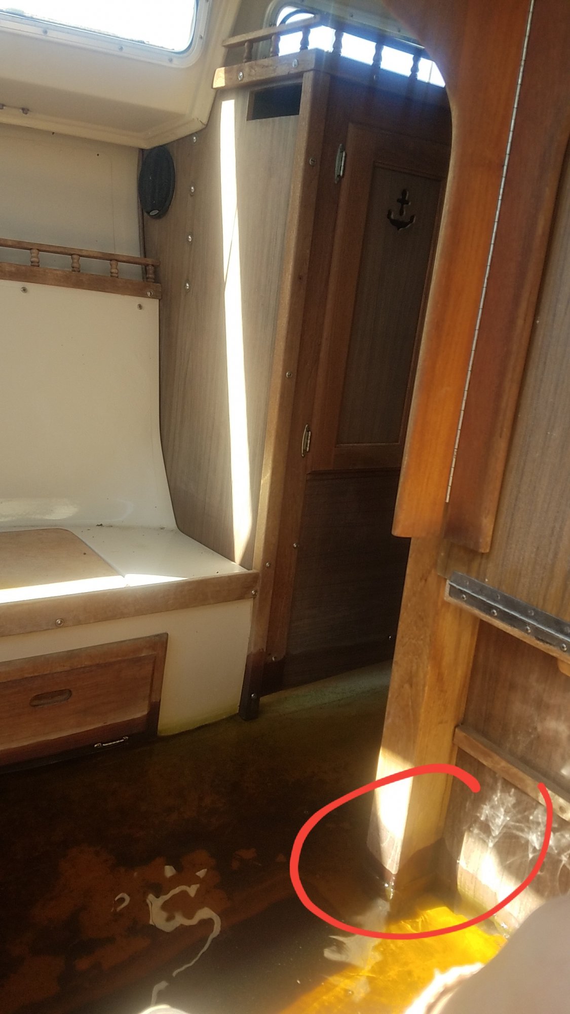

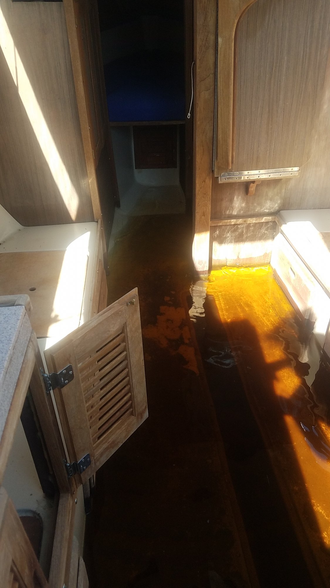

Suppose this boat has been sitting with water in for a year. Does the interior mast pole need replacing? I'm thinking this pole connects the deck mast the the keel correct? This is the second boat I've seen with the interior mast sitting in water. Is this a "back away from this one" scenario?

Most here would tell you to run fast and run far. Having done this repair myself ,I suggest asking your self ,would you rather sail or spend a couple of months fixing it properly ? The work itself isn't particularly hard . The mast support post must be measured very carefully .
Likes: gtg
14,187
The proper name is a Mast Compression Post. :)
Whether this is a boat for you depends on a couple of things. Is the price right? Do you have the wood working skills to replace the interior of the boat?
The bulkheads will likely need replacing along with the Mast Compression post. One has to wonder about the rest of his maintenance if there is that much water in the boat.
The right price for this boat is a bit less than he'd pay to have it cut up and put in the landfill. That would be the amount he pays you. :)
Yes.
Yes.
I would suggest you visit a youtube of someone who has bought a boat with the plan of fixing her quickly and cheaply.
Then someone who is doing it slowly and expensively
One question I have is, How much of the engine and electricals have been submerged?

Great thoughts and correct names, thank you. I hadn't even thought of electrical issues. Dang.

Its a very simple formula.
Would you be happier spending months working on a boat than sailing a more expensive one in better condition and spending more in the long run? Because if you buy the project boat you most certainly will.
Not to be rude, but if you don't even know the names of the parts of a boat, how can you consider yourself qualified to be a boat builder? A boat builder is to a carpenter what a spackler is to a paver.

A more challenging fix it the path (s) the water took to fill the boat. Deck and core damage. Run!
