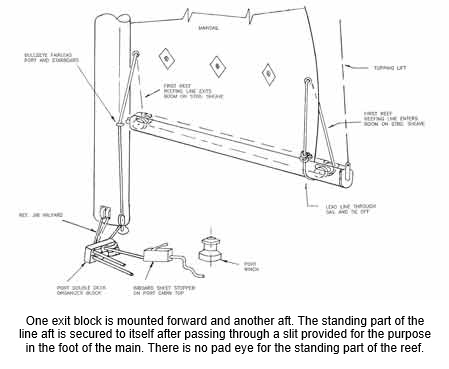

IIRC, there is a block that can be sewn into the sail. It allows the line to go from one side to the other, but there is an athwart sheave in it to reduce friction.

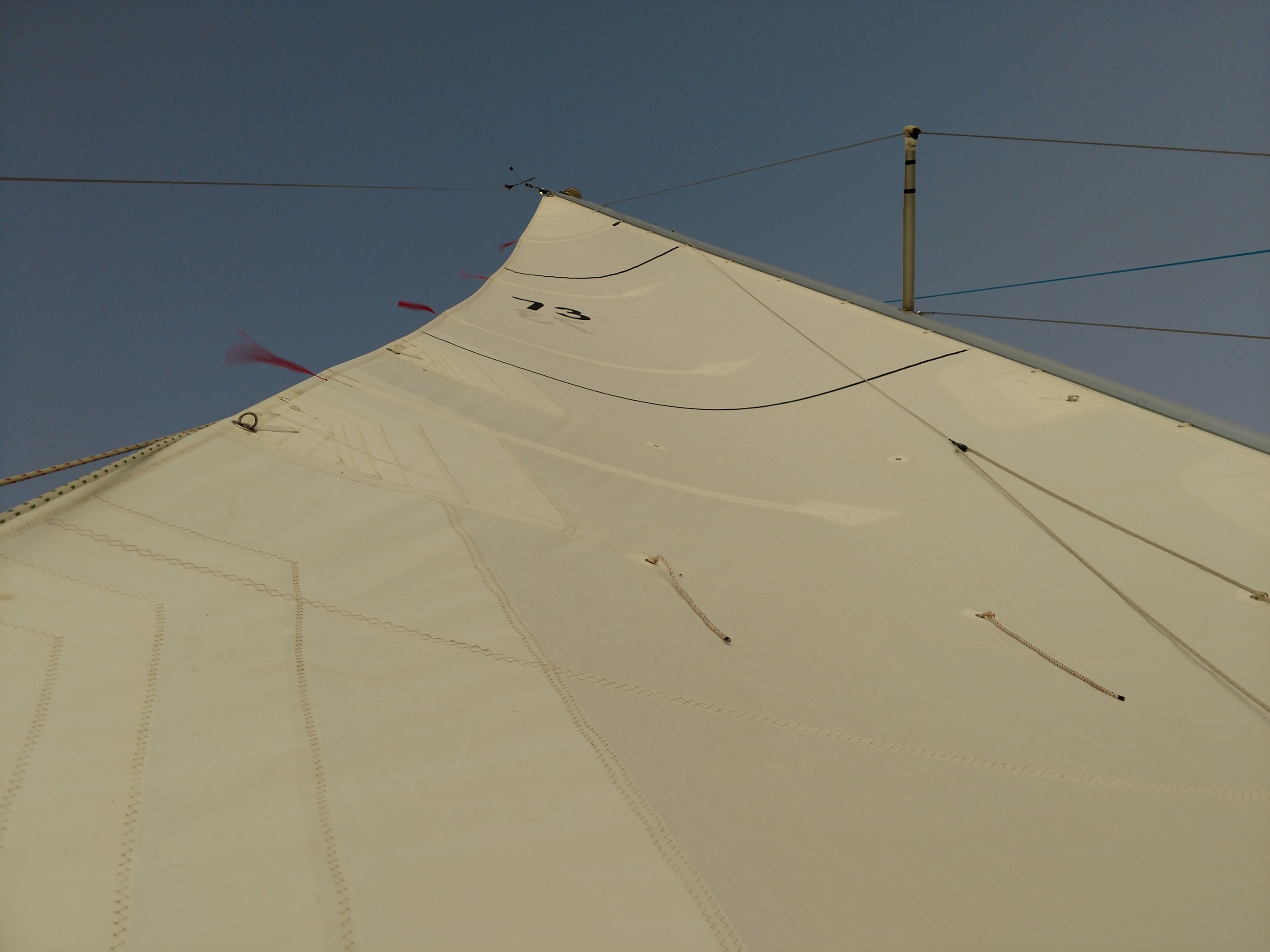

On mine, I have a single line reefing system. On one side of the sail is a stainless ring large enough to not pull through the grommet. Attached to that from the other side of the sail is a medium sized Selden Block. The reef line runs up from the aft end of the boom (off of the sheave) through the Selden block and back down to the boom where it is dead ended through an eye strap with a knot. Sorry, I don't have any good pics of the block side but attached is the ring side. If you blow up the pic of the boat going away, you can probably see the block and reef line on the port side of the sail. The reef line is rigged similarly at the forward end. This works well.
