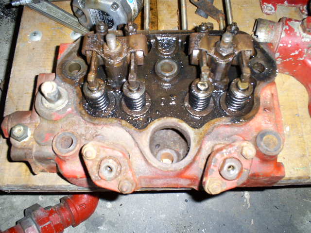

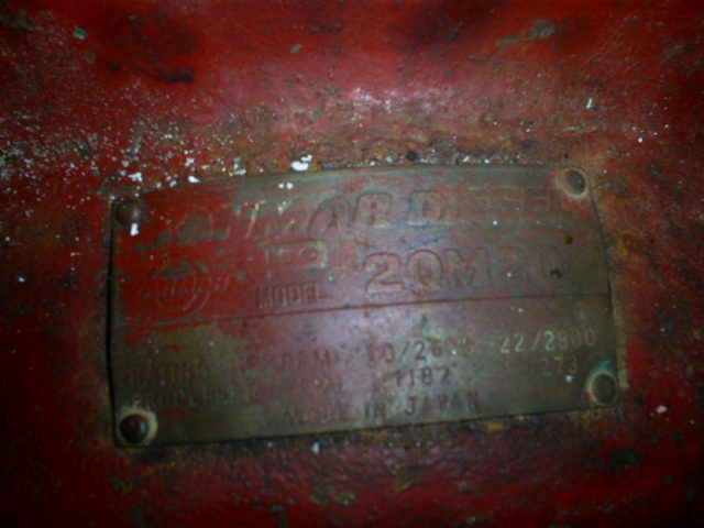

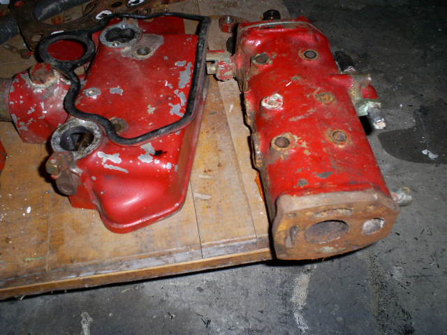

I pulled the head already. They look a little different headless, as any of us would. the plaque has 1273 on the lower right, maybe the date of manufacture?

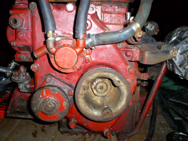

I have a question for those who know. Does that water pump look like it's designed to have a raw water side and fresh water side?

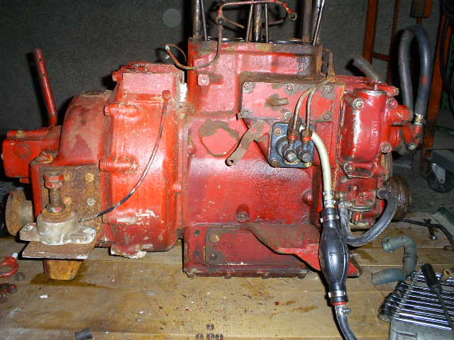

I guess maybe that is a 2QM20. I would have to look at the manual that I don't have here to be sure.

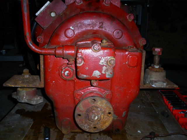

Did this engine come from a powerboat? That looks like a very heavy duty, large reduction gearbox. If you can turn the engine over, you should check the gear ratio. It's probably way too large a reduction for the size prop you can fit on a typical sailboat.

I believe the reduction ratio is 2.3:1
What ratio does your have?
That's about what mine is but that gear on your engine looks massive and with a lot more shaft drop than what is on my engine. You need to either find a nameplate or see how many turns of the coupling it takes to make the flywheel go around once. Now that the heads are off, that shouldn't be too difficult.

I haven't looked all over for a name plate on the tranny. I got that number by marking the crank and output and turning it over once.
I am estimating the 2.3:1. But if it's not that it is very close. It was said to have come out of a sailboat.
That shaft drop will make this boy stand up tall in the engine compartment.
Do you think the water pump looks like one that is a pump for fresh and raw water? There are 4 ports on it.
It looks to me more like the optional bilge pump option that they offered since there doesn't seem to be a heat exchanger. You need to contact Torrensen Marine and buy the manuals, you're only looking at about 30 bucks and they include complete instructions for disassembly and rebuilding. There is a service manual about an inch thick and a parts manual.

I was able to take a quick look today while moving the boat to her storm berth and, sure enough, one of the gear options is one that looks just like yours. It looks like a more substantial gear than the Hurth on my engine, the kind you would put in a powerboat instead of a sailboat, but the reduction ratios are not greatly different.
10,219
I think that optional gear was to better fit into a classic full keel boat.. with the prop in an aperture .. engine much more accessible than if used with a “normal” drop gear.. Interesting.

I just got back from the boat. I did some measurements and found I would need 5" or 6" longer compartment and about 3" to 4" taller. The stringers won't need any width changes. I can definitely accomodate for the extra space, but I will need to weigh this engine and see if it is in the rhelm of possiblity. If she can handle the weight, I will build a removable wooden housing.
I tore the engine most of the way down. It looks like someone rebuilt it recently. before I replace anything I am going to have some measurement on tolerances done by a pro I trust. I could have this in my boat for under $500 in parts.
