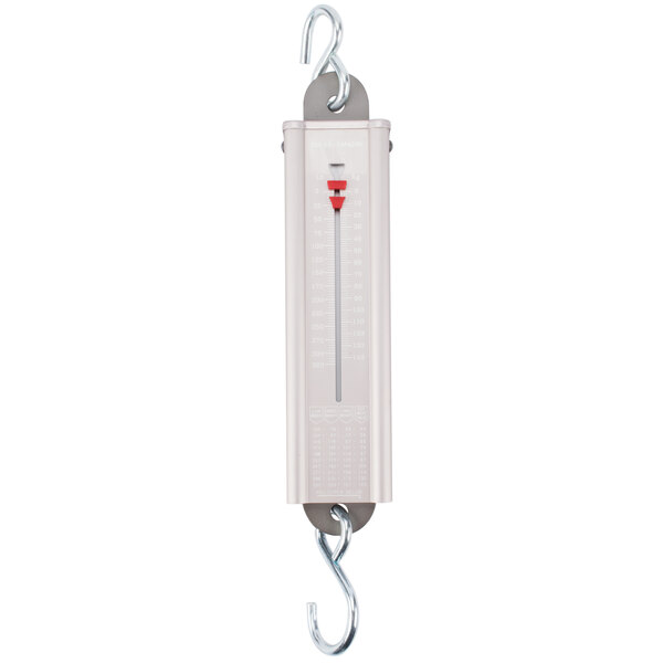

rgranger, you should be able to test it at the dock. Here's a hanging scale rated for 300lbs, for around $30
Connect this to a piling or dock cleat and your halyard.
Make sure you have a good angle away from the boat that is both realistic to the bridge situation and your boat is not bound fast against the dock so it can move out as the masthead comes over the anchor point.
Haul on the halyard until you get the desired angle. You could even pre measure the halyard length from the anchor point and tie a piece of red thread on it to tell you when the masthead is at the desired height.
This would tell you how much weight in seawater you want to attach to the end of your halyard. Use seawater because it will stop pulling once in the water. Maybe a group of five gallon buckets.
-Will (Dragonfly)

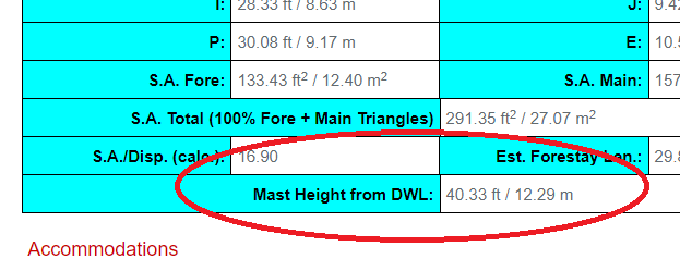

@sail sfbay I was looking at this number on sailboatdata.com
It seems too high to me but....???
To answer several questions, above.... I'm moving to Charleston and one of the condo's I'm thinking to rent has a tidal creek behind it with enough depth for me to make it to the main channel... but the reviews for the bridge I'd have to pass under say that it is a PITA and dangerous at low tide because the boats crowd up and sometimes they are large commercial boats so..... I might not be able to take advantage of a quick evening sail when conditions are perfect if I have to time both tide and bridge openings. So... got to thinking that if I could tip the boat over.... this condo might be the perfect spot... no marina bills :thumbup:
@markwbird Yes my math is correct... assuming the air draft of 44' is correct.... simple trig.... but... I am doubtful that air draft is correct. I need to measure it myself.

Height above water line is fairly consistent for all three sources. 39’ 9”,40’ and 40‘ 4” but measuring on your own boat is the only way to get a completely accurate number. My confusion on your math is where you get 35’ as being the safe distance To clear the bridge. You earlier indicated the height to the bridge from water was 33’ (Assuming Rick is correct that is height to underside of the open bridge?) Are there other factors that increase the water to bridge height to 37’? Say lower tide vs average tide?
