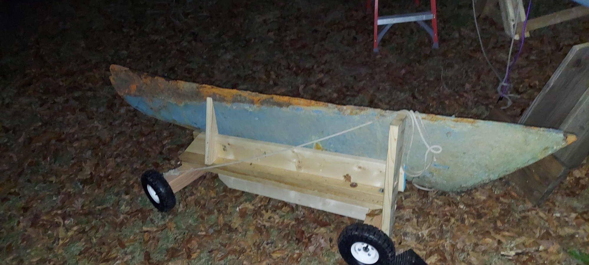

Cliff notes, you -must- take it out and blast it at some point. You may be shocked at how little iron you find. I cannot emphasize enough how important it could be to your safety, especially on cheap old boats like Macgregors.
My Mac 25 was an ocean boat most of its life, and its keel looked uglier than most in the midwest. I got a lot of advice in prepping to remove it, for which I am grateful.
But.
I also ran into the “nah it’s normal” trope from many people, INCLUDING the folks at Strictly Sail Inc when I was trying to pay them to do it. “We don’t take keels out, we just hoist the boat, sand what sticks out and paint it. It’s all you really need, they’re iron and they’re going to rust anyways.”

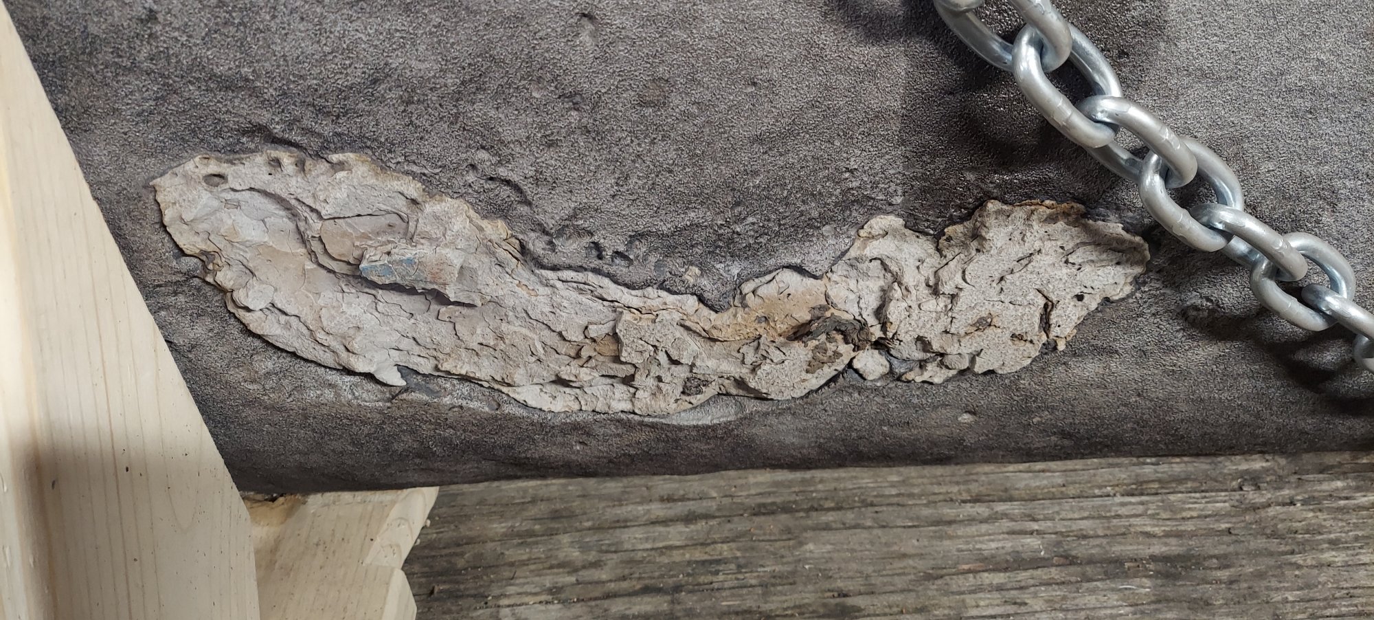

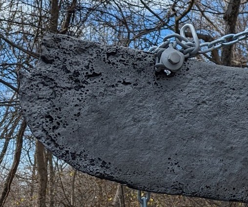

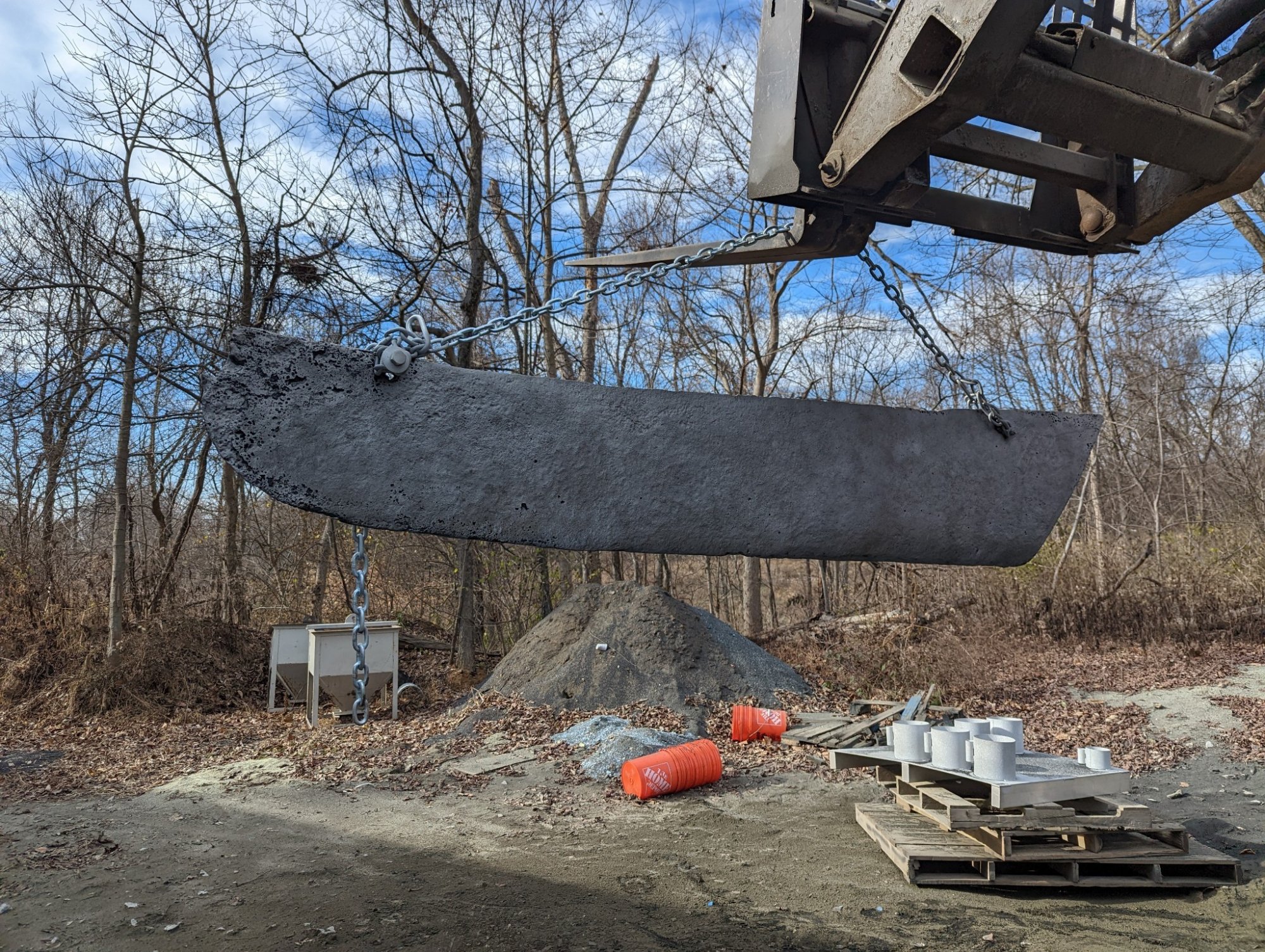

Well I didn't listen, I built my own hoist and did the job myself. The rust line on the keel made it look as though it had never even been lowered for paint, instead being painted in the retracted position, on the trailer. In the photos you can see that even the halfazz job of slapping paint on what was exposed made a HUGE difference in the life of the iron.

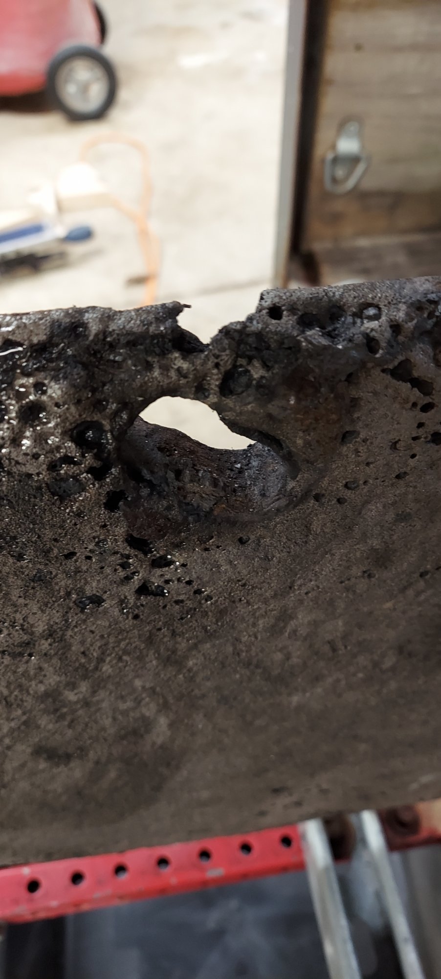

The unpainted iron is deeply pockmarked and pitted, the keel bolt was only hanging on by a 3/8” x 1/2” thick ribbon of iron! The painted stuff still has a cast finish, with mild pitting only in places where it contacted things like the hull or trailer.
That little ribbon of iron was not long for this world, perhaps only a few years from succumbing to the 650lb weight of the keel a tearing out.
The simplest way for your boat yard to do this is likely to block/clamp the keel to the trailer, remove its hardware, and hoist the boat up and off (and put it on the hard, don’t camp out on the hoi$t). Wheel the trailer into the blasting booth and blast what you can reach (protect your trailer!), then immediately clean it with acetone and coat it with something like POR-15. In 6 hours you can then paint over that, either adding more barrier layers or going straight to bottom paint if the yard wants you out. Set the boat back down on the keel/trailer and reattach it. The bits of keel hidden by the trailer will now be exposed when you hoist the boat back up to do the normal bottom paint work-scope. I’m planning to do this extra step every 5~10 years.

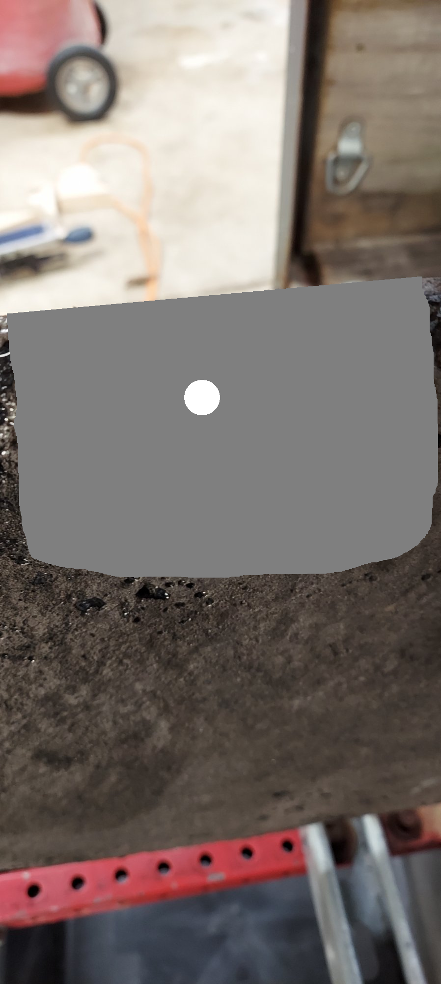

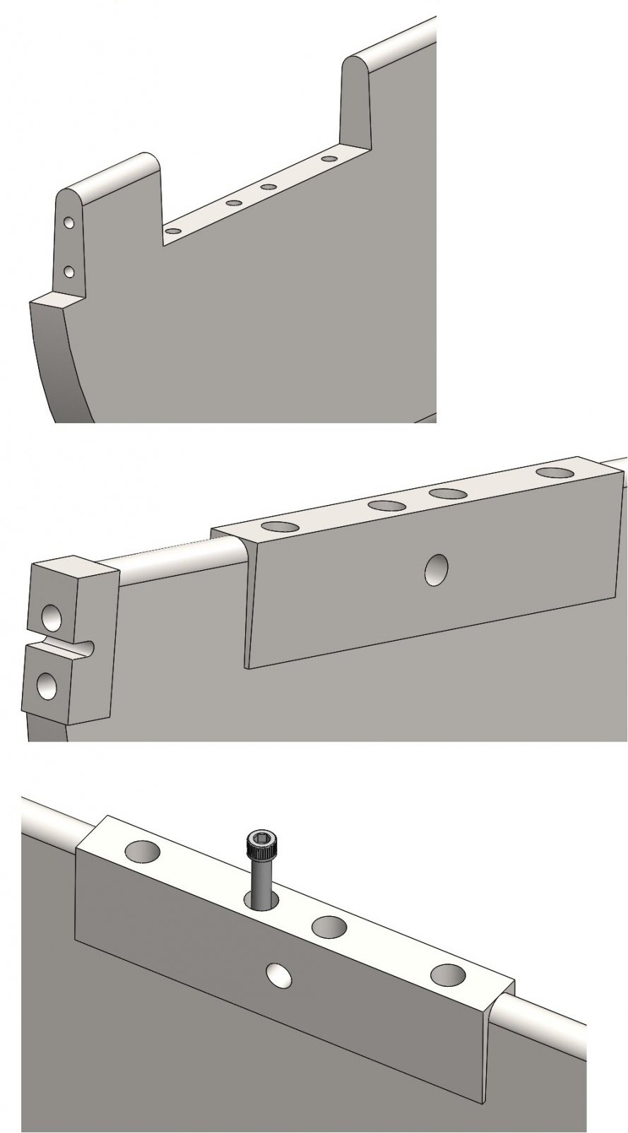

How did you repair the pivot hole?
Future tense, how will I?
I have a plan for cutting away the bad metal and threading into some good "meat" with 4 bolts. My current hang up is choosing the material for the bolts, to minimize galvanic corrosion.

Something like this... cut out the bad area and weld in a piece of iron...
I'll bounce that idea off the weld engineers here at work. I have a mechanical-connection bias because that's what kind of engineer I am. lol

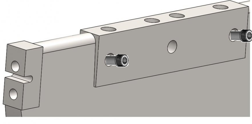

I'm worried about the strength and longevity of the weld, based on how much garbage is in the base metal, and irons' tendency to get brittle. Attached is the rendering of my repair. Plan to use 4140 steel, with everything coated and potted in POR-15 to isolate things. Each bolt is good for 1400lb, I want to spread the thread load so this thing can age a while before yield values become an issue.

That looks like a viable approach. A concern I have is that the bolts going into the meat of the metal would be supporting 650 pounds of the keel when it is in the up position. Any corrosion between the bolt and the meat could lead to the bolt backing out. What if you extended the sleeve a little past the cut out and over some solid areas of the keel... and added two vertical through bolts that went completely through the keel.... like this...
This would only fail if the keel rused all the way through the spine or if the bolt failed.

.... like this...
I had the exact same concern, and fiddled with some ideas along the same lines as your suggestion. Grinding down to find enough meat for this kind of interface requires a more precise removal of metal, to maintain uniform thickness for that interface. The "web" you end up with for thru-bolting is only an inch wide, so I'd need to go down 2 more inches to give a healthy enough amount of material to retain things. The notch I can hog out with a grinder and clean up with a rasp/file.
The math for the four bolts works out to have a lot of overkill. Each 3/8-16 bolt can resist ~1400 pounds of pull-out force (2400 if I go up to 1/2"-13). Add to that the fact that the keel pivot hold half the weight (or less) of the keel in the up potion, and that's a lot of overkill. In the down potion, it's predominantly a shear force, with the steel brick being blocked in that direction. Retention can be enhanced by cross drilling and thru-pinning the bolts.
Right now my big rework hurdle is settling on a material for the bolts. Something that won't treat the iron like an anode... I should probably add a Zinc while I'm at it.
