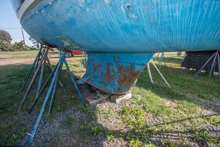

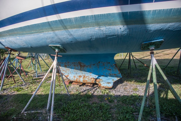

I have a Hunter 33.5 and it has been on the hard for the last 10 months and expect it to remain so for the next two years. I am currently located where there is no water :cry:. The keel is starting to show signs of rust in different places. Is there a fix for this? if so, please let me know what your experiences have been.
I have attached two shots port and starboard. The round hole you see on the starboard shot is to prevent water building up in the bilge as there is no power to the bilge pump.

Do you think I should be concerned with that rust line on the starboard side?
Regards

Petit Rustlock Steel Primer (#6980) works extremely well. My keel looked very similar to yours. After the first year of use, rust was reduced ~ 85-90 percent. Now I have very few small rust spots upon haulout.
Also the port side looks as though it has about ten coats of bottom paint on it. Mine looked like that when I repainted the entire bottom for the several years I owned her. You might want to consider spot painting the bottom, plenty of ablative paint already remains. It's a lot less work and you can lose alot of weight over the years by spot painting. It took me too long to figure out that one.

When you get ready to paint the bottom you will probably want to clean up all the rust. You can grind off/wire brush any rust between the stub & the keel. This area needs to be sealed and re-caulked.
