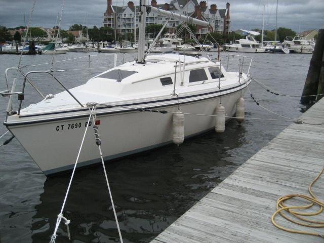

here's what I found the boat this afternoon when I got back to her... she was exactly as I left her yesterday :)
