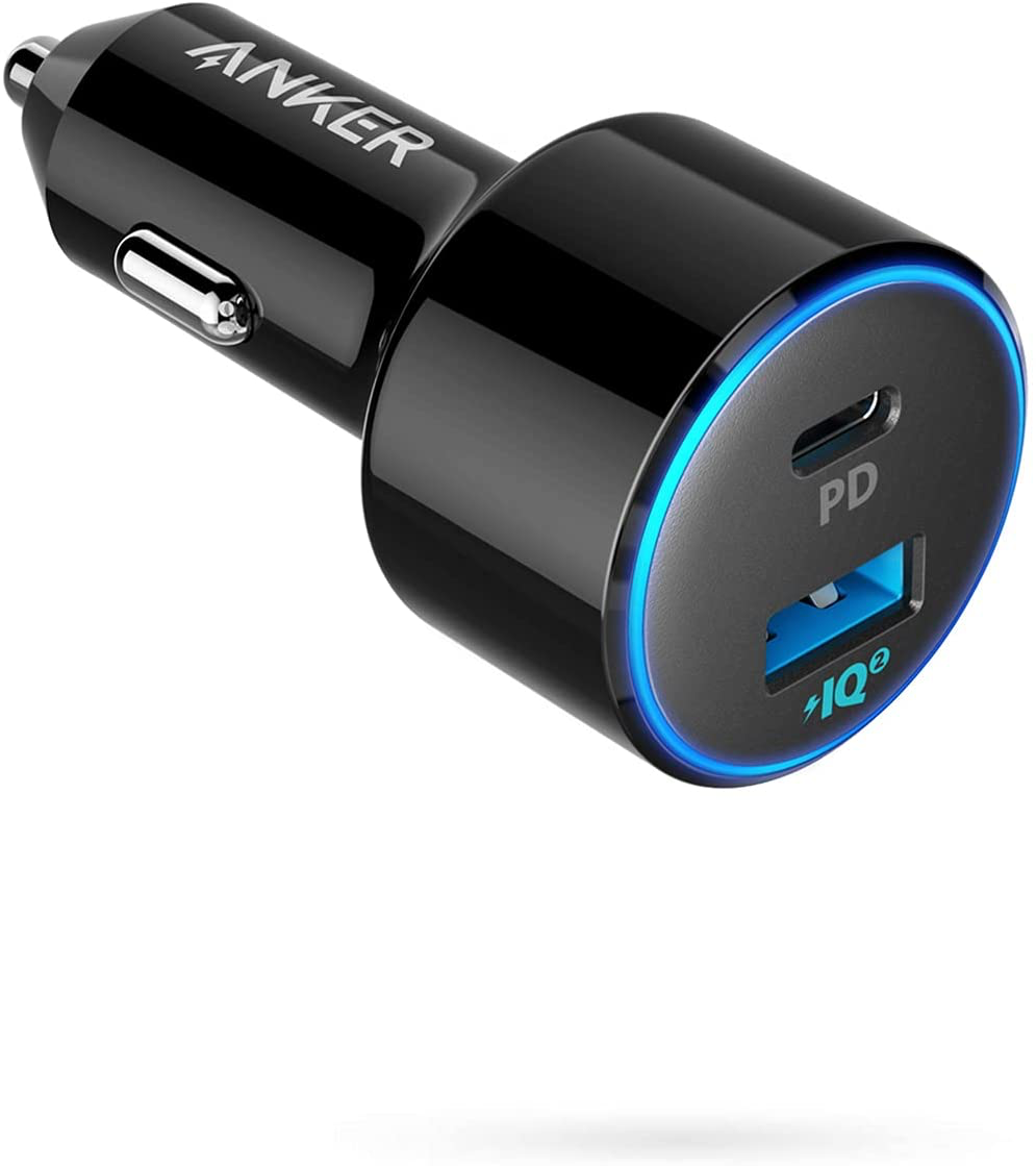

I also added the
USB C Car Charger, Anker 49.5W PowerDrive Speed+ 2 Car Adapter with One 30W PD Port for MacBook Pro/Air 2018, iPad Pro, iPhone XS/Max/XR/X/8, S10/S9, and One 19.5W Fast Charge Port for S8 and More

Wade, I think that the BLUE SEA unit may be listing the "Maximum" performance. When used it may be performing at a "safe" level. Not sure. I do know that the 2 units I posted have preformed while I have been sailing providing adequate power to the iPad or the bigger charger to my laptop.
Note that you indicated the iPad is in a water proof container and out side (I assume in the sun). If the iPad gets warm, and charging can increase the heat in the battery, the iPad tends to shut down to protect the unit from overheating.

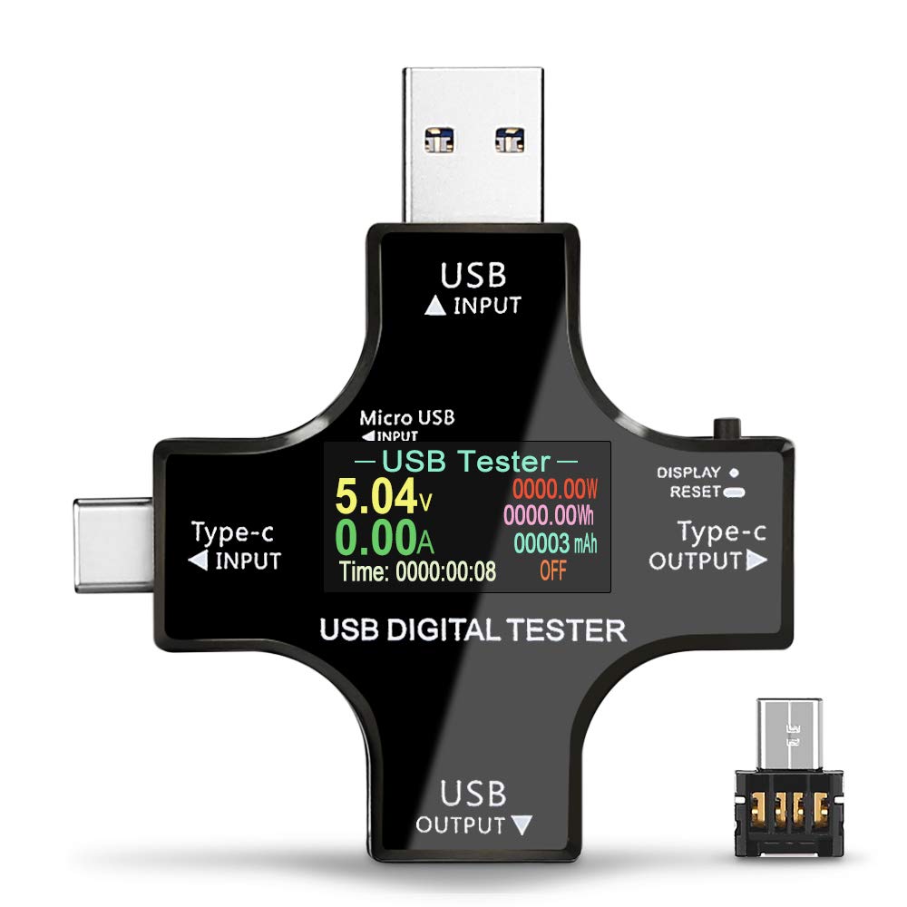

Which is why I suggested to measure the voltage the iPad is getting.
How would you suggest doing that? The connectors on a lightning cable are too tiny to get a DVM probe on, and even if you could testing them when the connector is out probably won’t indicate the voltage when the connector is plugged in.
Apr 1, 2019
27
Freedom 38 Boston, MA
Good question! After some searching, it turns out there are specialized devices that will do just that. There are tons of them on Amazon/Aliexpress, and they all basically do the same thing. I just ordered this one, so we'll see how it goes:
Sep 25, 2008
7,605
Alden 50 Sarasota, Florida
A simple USB tester or the old fashioned way of exposing the wires on an un-needed cable to allow measuring with a voltmeter.
