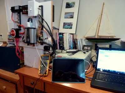

400W Inverter & Apple 120V Adapter
I have been conducting a lot of battery testing this winter and needed my test station in my downstairs office area. It makes it very convenient to have the batteries at a good constant temperature and this area makes that possible compared to my barn/shop..
This system can be used to conduct 20 hour capacity tests on batteries, cycle testing of batteries, track solar performance and can track multiple channels for current, energy used/supplied, voltage, watt hours, battery efficiency etc. etc. etc. etc...
Today I was just curious to find out exactly much energy it takes to charge an iPad Air 3G from a 12V bank via a small MSW inverter..
The Testing Station

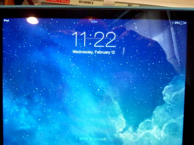

Data Point 0% SOC @ 11:22 AM = -0.02 Ah's
I snapped my first photo of the iPad at 11:22 AM and it had already gone from 0% to 2% SOC..
11:22 AM - 2% SOC

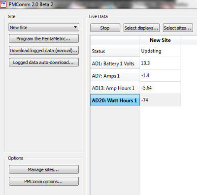

For this test I decided to use the Bogart Engineering Pentametric Analyzer to track the ampere hours and watt hours of energy consumption. Throughout the entire test the battery bank voltage remained at 13.3V - 13.4V. The iPad was charged via a 400W Cobra inverter to mimic the way I see most of my customers charging iPads, via an inverter.

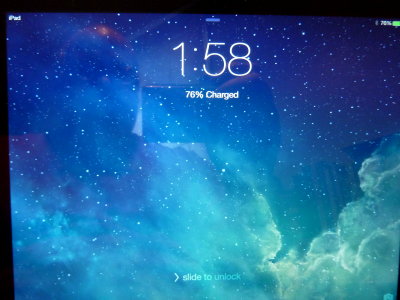

You can see here that in order to get to 80% SOC it consumed -3.91 Ah's or -51 watt hours from the battery bank.
Data Point 79% SOC @ 1:58 PM = -3.91 Ah's
After nearly 2 hours and 40 minutes of charging at 1.5A the iPad Air is nearing 80% state of charge.
1:58 PM - 79% SOC

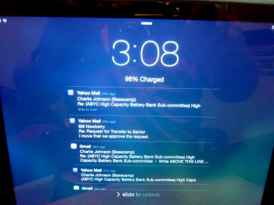

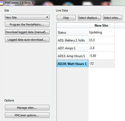

Here the iPad has approached 98% SOC and consumed 5.5 Ah's to get there.
Data Point 98% SOC @ 3:08 PM = -5.5 Ah's
3:08 PM - 98% SOC

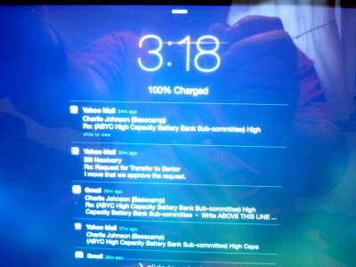

At somewhere between 3:17 & 3:18 PM the iPad clicked over to 100% SOC and had consumed -5.64 Ah's to get there.
100% SOC = -5.64 Ah's

3:18 PM - 100% SOC

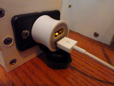

For this second part of the charging observations I chose to use a USB 12V adapter as opposed to an inverter.
This particular 12V USB adapter has an output rating of 5V and 2.0A which is 0.4A less than the output of the Apple 120V adapter. All this means is that it will take a bit longer to charge the iPad. Bot regulate to 5V max but one as a 2A output and the other has 2.4A of current capability.
This particular USB adapter is branded Rayovac. I grabbed it at Wal*Mart for about $9.00.. The standard Apple USB to lightning cable was used.

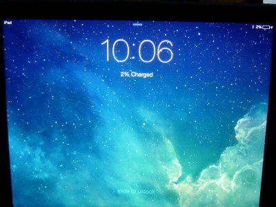

My first iPad screen shot is again at 2% SOC. It appears the screen won't even turn on until it says 2%.....
10:06 AM 2% SOC

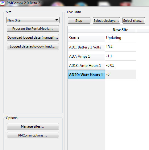

First data point via the Pentametric tracking software.
Data Point 2% SOC @ 10:06 AM = -0.01 Ah's

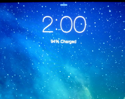

2:00 PM - 94% SOC

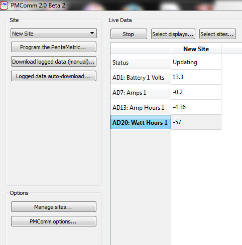

Here is where the data begins to get interesting. It took just -4.15 Ah's from the battery bank to go from 0% SOC - 94% SOC using this 12V USB adapter. It is looking very good for a DC>DC win at this point....
Data Point 94% SOC @ 2:00 PM = -4.15 Ah's

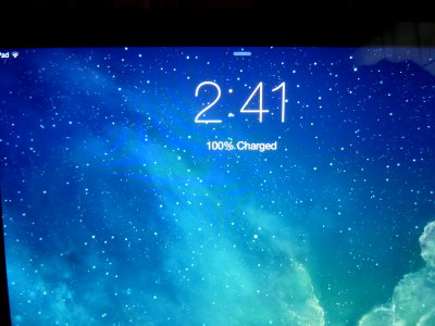

The iPad finally ticked over to 100% sometime between 2:40 & 2:41 PM as I was doing a quick screen check every minute after 99%..
2:41 PM - 100% SOC
As in many other observations one can easily see how much more efficient it is to remain DC throughout the entire charging process.
To go from 0% SOC to 100% SOC using straight DC>DC, as opposed to DC>AC>DC we saved 1.28 Ah's of energy (5.64 Ah - 4.36Ah = 1.28)!!!
Put another way when using the 400W inverter and Apple 120V adapter to charge this iPad it uses 29% more energy to for a complete charge cycle.
