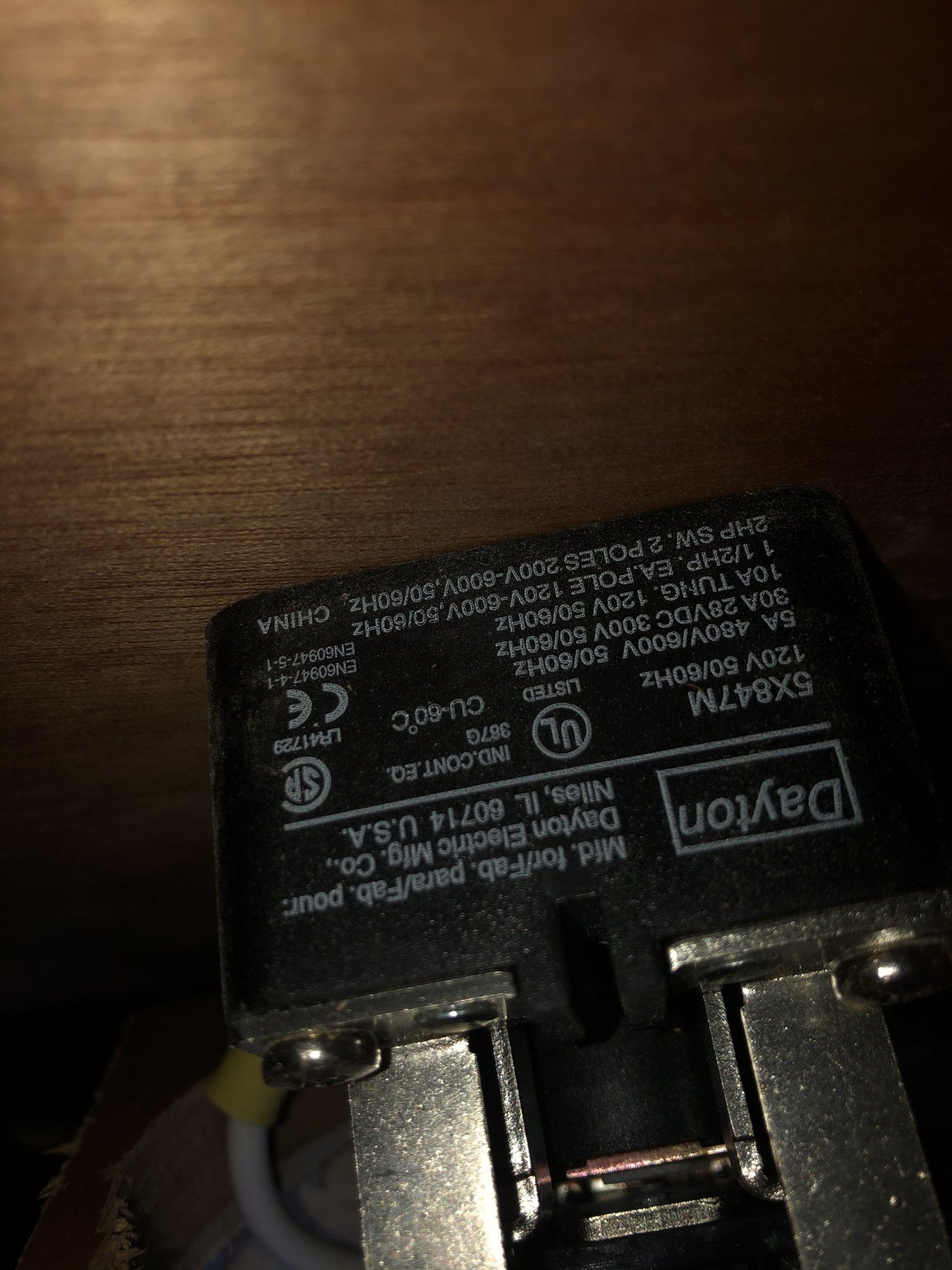

Hello all,
So I have a 3000w inverter that I just started to use as I am now working from the boat..... printer and charging lap top. I never used the inverter before however it always hums loud from behind the electrical panel. Inverter works fine. So today I opened up the panel and there is a relay prior to the ac panel that is making all the noise. I looked it up and only $35. Just want advise if this is what happens when a relay starts to go bad or is it sign of something else?
Thanks!

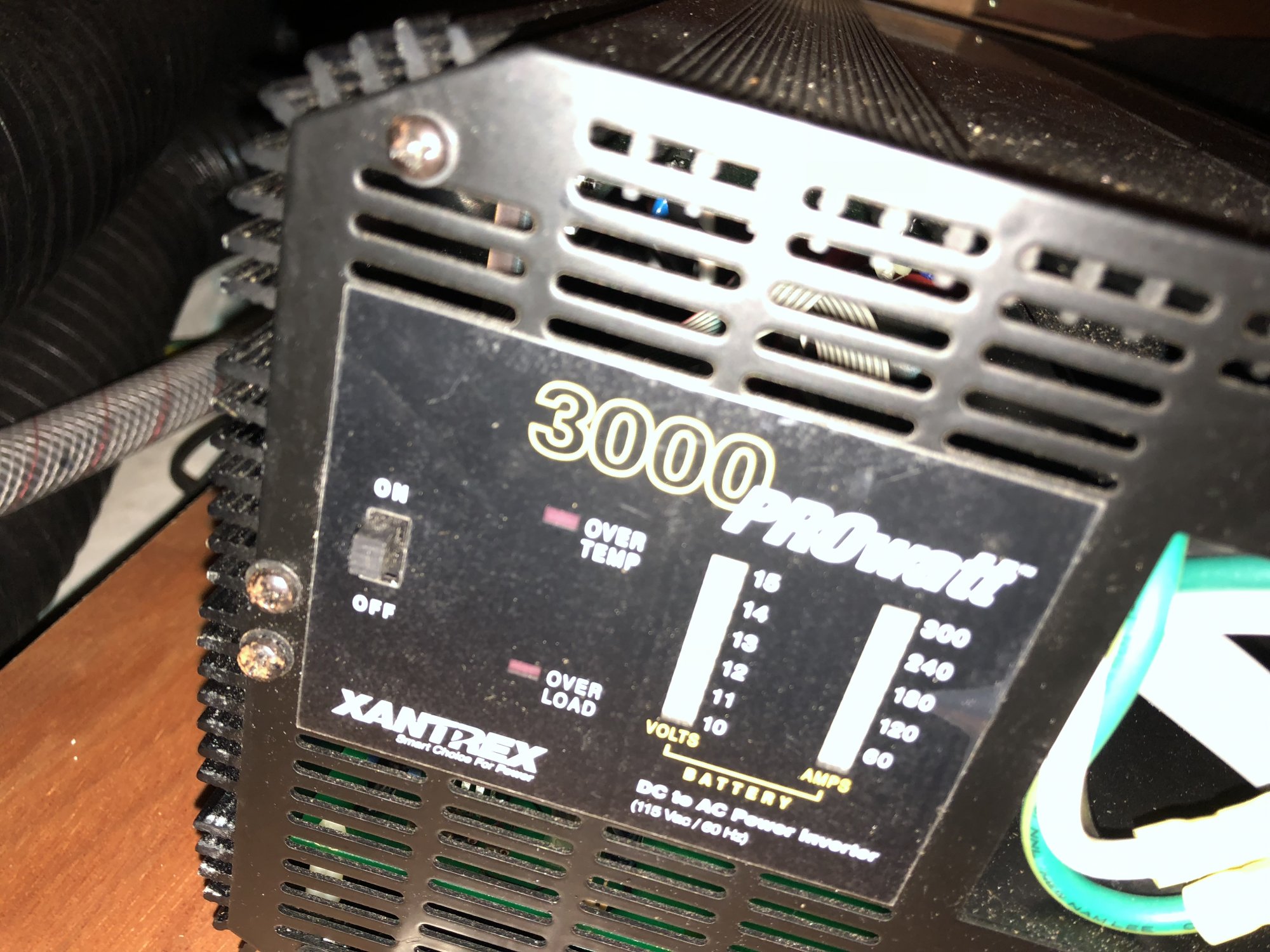

It’s a Xantrex 3000w 2005. It is connected to a grounding plate on hull. Video was me turning a/c power on and off just to show humming

Is 2005 the year it was made? Really need more info. How about some pictures of the inverter & the relay.

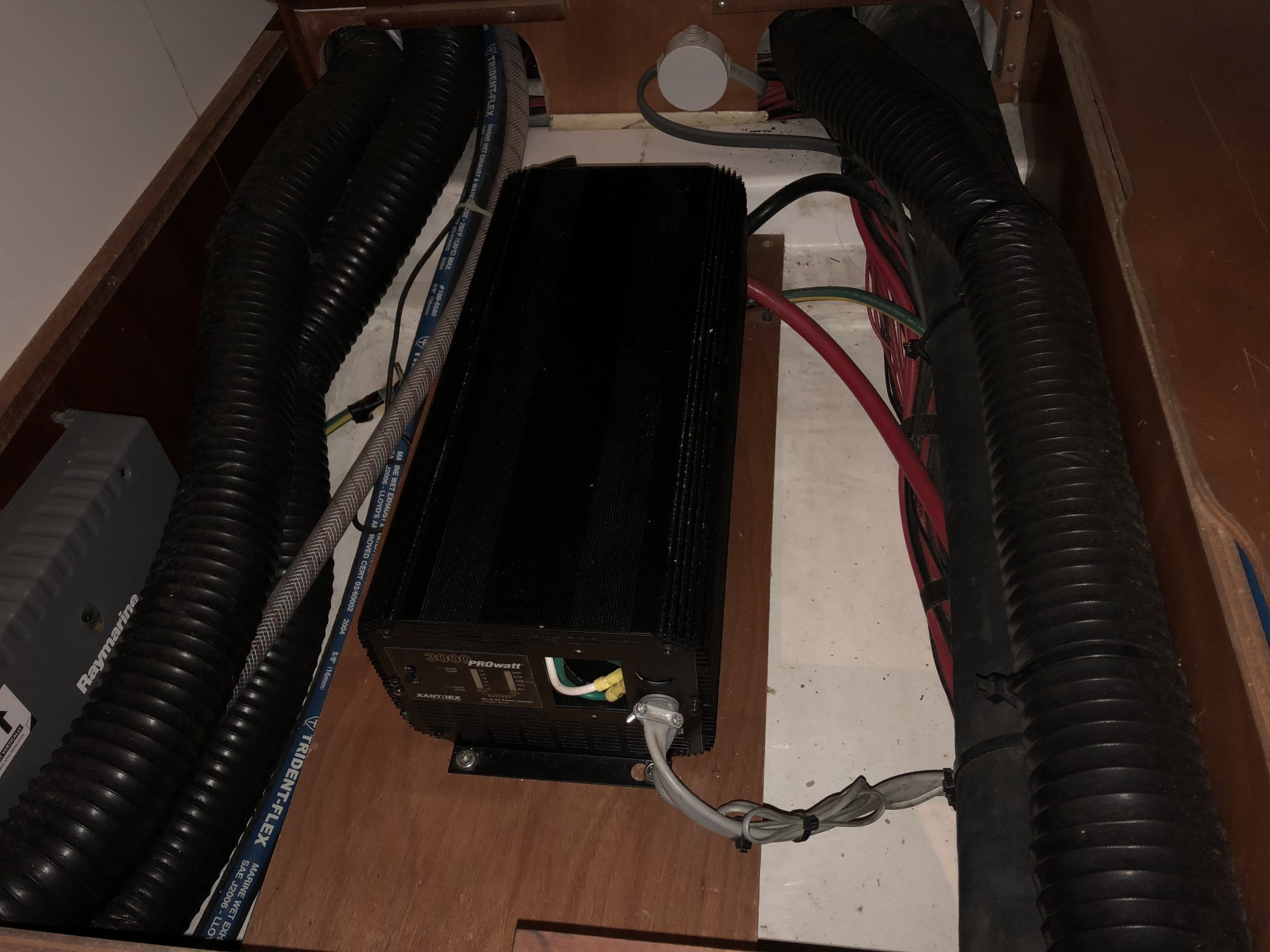

Video above of relay. Inverter came with the boat in 2005. From factory......CC4DA970-D91C-4DC4-AE54-3C89568CF599.jpegB585EE30-7098-4495-A17A-C5D9190F6AE2.jpeg

Sometimes dirt particles get into the relays case and prevents the armatures mechanism from sealing up tight contacts. This would require the coils to be drawing additional power to maintain function and will eventually lead to failure. This is just one of the causes and cannot guarantee it is your problem but if that relay is old you could not go wrong by replacing it.

I am here asking because I don’t know..... just following the wire set up. Inverter is wired up to power entire ac systems in boat ( all outlets, microwave, Etc) not just one outlet. Inverter wires to relay to ac panel.

I listened to that video.. my "calibrated ears ???" think that is a 60 hz buzz.. If the relay coil is powered by AC and it mechanically starts to degrade, the coil could buzz like that. I doubt it hurts anything but would be annoying. If the relay coil is powered by DC, it wont buzz unless the drive circuit was oscillating (I dont think this is the case since it sure sounds like 60 hz).
Relay is cheap and sounds like you can find a replacement.. I would just replace it. FYI, does the relay buzz in shore power position.. or does is buzz in "ship"? If its buzzing in ship, you are using the boats batteries to power that relay ... no big deal if you have tons of power available but.. relays use a bit of power to operate the coil (like several watts) which might be important in a lower power system.. If it buzzing is in shore power mode, can we assume that the relay drive power is coming from shore power so no big deal at all..
Edit.. re read the OP statement and he said the relay buzzes in ship mode.. So likely you are powering the relay somehow from your batteries.

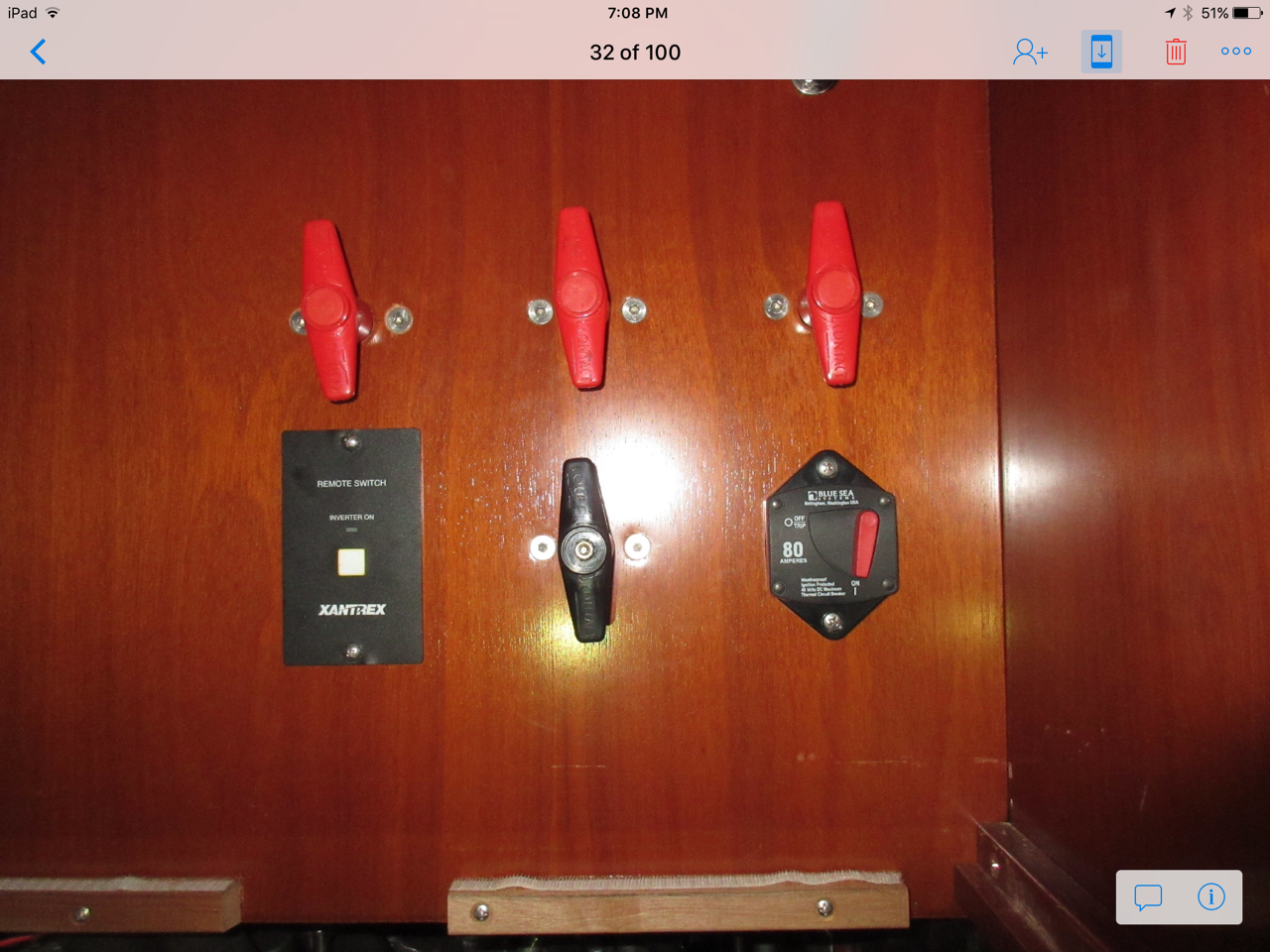

Yes... I do have the RED switch which is a break between batteries and inverter. Then I have the remote switch which will turn it on..... All good to this point with no buzz. However as soon as I slide the mechanical bracket and turn on the Ship AC Power..... the relay closes and the hum begins. Now this is a thought, could the inverter in-fact be wired directly to the ac panel then go to the relay? It is tight behind the panel and I did not open the rear cover to the ac panel to trace those wires that lead from the relay to the panel. Guess I need to investigate. But either way, a 15 year old relay may have a loose coil which might cause a hum? I am going to buy the new one and in mean time will open up everything just to really know how its wired. I just assumed it was going from inverter to relay to panel.....
