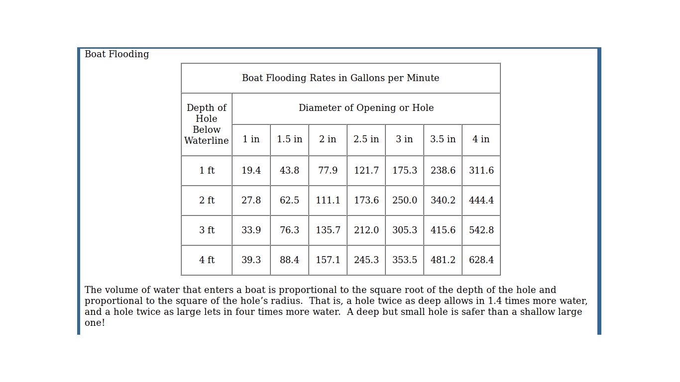

I had a similar system on my 53 footer, but I had 3 much larger a/c pumps, with 1.5" discharge lines and a genset. Never mind 2 rule 3k 12vdc pumps and two sump pumps. Even with all that, the table below may give you some idea of how much water you must be able to remove to stay afloat.

I just can’t see 12v bilge pumps of any size, let alone a manual pump (how many strokes you think you’ll last) as valuable for anything other than nuisance water. Check out the chart from capta and do the math. If you have a puncture below the waterline of anything more than an inch diameter you’re better off radioing a mayday, grabbing life jackets and an EPIRB. Otherwise consider a prop shaft driven pump, such as from Fast Flow that has minimum flow rate of 24,000 gal/hour. larger pumps are available. Just my 2 cents. Or, as has been suggested, spend your money on materials that will give you a chance to block off intruding water.
