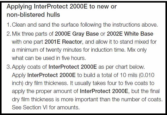

I applied my second to last coat of 2000e (white) before I start on the AF paint. I am kind of concerned about the speed the 2000e is drying. The last coat needs to pass the thumbprint test so to "hot coat" the first coat of AF. It was 65 and overcast this morning and the 2000e was already well pass the thumbprint test after just 25 minutes....no where near the time stated on the can. Anyone else experienced this too? I reck'n I need to roll 2000e in my right hand and AF in my left ;)

I will be adjusting my catalyst for my last coat I guess. Maybe go 4:1. The 3:1 just isn't cutting it. Like I mentioned, it was around 65 and overcast with low humidity. I am not sure how I can pass the thumbprint test the next morning......I had only15-20 minutes! I was thinking of doing one side at a time but would rather not. It takes me maybe 30 minutes to paint the bottom if I work fast. Hopefully going 4:1 will give me the time I need. Wondering now if I got a bad batch of the part B catalyst...............
I don't think that'll work as hoped. The reactor in the mix is a component of the 2000e epoxy, not a catalyst. As such, you cannot vary the amount of the reactor same as you can the catalyst (methyl ethyl ketone) in polyester resin.
You'll wind up with an unpleasant goo of unreacted epoxy.
If you're that worried about the thumb test, any chance of waiting for some cooler weather, applying a coat of 2000e and the AF coat ? I did my AF application when the thumb test was pretty hard. No problem when I tried to scour off the AF with a rag the next time it was due for bottom paint. The final thickness of black ablative AF was NOT coming off the 2000e for love nor money.

Thanks Ralph. I guess I will apply it at the crack of dawn when it's cooler. That "mix only what can be used in 5 hours" is insane. I mixed a quart at a time, enough to cover one side. By the time I got to the rudder, it was pretty much a thick goo. Maybe I am just not understanding this "thumbprint" test. After 20 minutes I can press my thumb on it where it leaves a print but doesn't leave any paint on my thumb. Maybe I need to whack my thumb with a 5 pound sledge hammer to make the 3-7 hour window that Interlux suggests ;)
