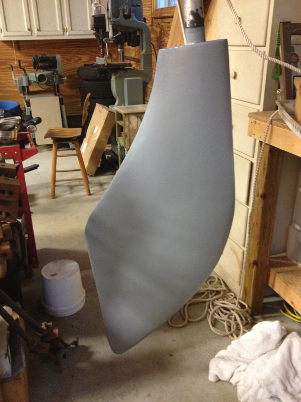

It's fairly cool here today, mid to high 50's. We were putting barrier coat on the Pearson's rudder and I expected 3-4 hours of time between coats. I put on the first coat and in under 30 minutes it's dry to the touch. No "thumb print" test needed here.
Does that first coat over bare fiberglass dry that quickly? I'm going to move ahead with the second coat and see how it does.

I've done the second coat and its about dry also.
Maybe I'm rolling it too thin or something? It looks really good.
