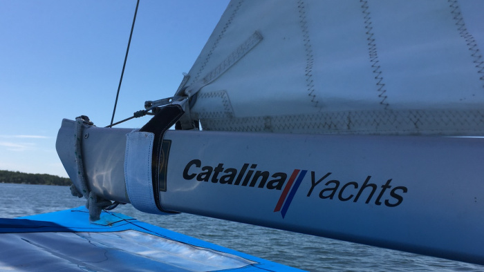

Aug 1, 2011
3,972
Been there, did that. Learned that the sheer strength of Velcro is something amazing.

Aug 1, 2011
3,972
The strap is Dyneema from Sailrite and it slides like butter on the boom. The strap is about 24" and there's 2" nylon velcro sewn to it, which was the hardest thing I've ever sewn, the velcro is like hard plastic and the Dyneema slides around in the machine like you never saw. Suffice to say the stitching isn't very straight. I didn't want to put binder on it as it's out in the sun. This is the only picture I have. The Dyneema was measured from the clew, all the way around, through the sail and all the way around to the clew, and the velcro is all the way around except for 2" where the Dyneema passes through the ring. It's attached such that the velcro is "inside" the two strips of Dyneema.
There was a LOT of discussion about the Velcro. It's odd, you can peel it apart with your little finger, but try to pull it apart (sheer) and it won't come apart easily.
