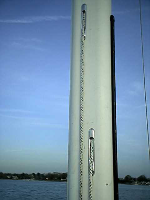

see what I used - Nico Fico exit plates
I used Nico Fico exit plates (Metal Mast - Putnam, CT) staggering the height to not weaken the mast and still allow you to jump the spinnaker halyard. Not that I jump anything anymore! To install these you cut out a small rectangle from a template using a metal blade and sabre saw; smooth the edges and the top, and drop the plate in which is secured with 1 3/8" 10 X 24 machine screw. You should to use machine screws so you also need to drill & tap which is real easy in aluminum. For the masthead - again drill out and file smooth. Snaking tracer lines for the halyards can be done using 3+ lengths of cheap 3/8" X 10' plastic pipes and connectors. I painted my mast beforehand and put the wiring into a 1" emt conduit riveted in front right. If you plan on using exit boxes instead I have a pair I bought from Catalina and didn't use.
