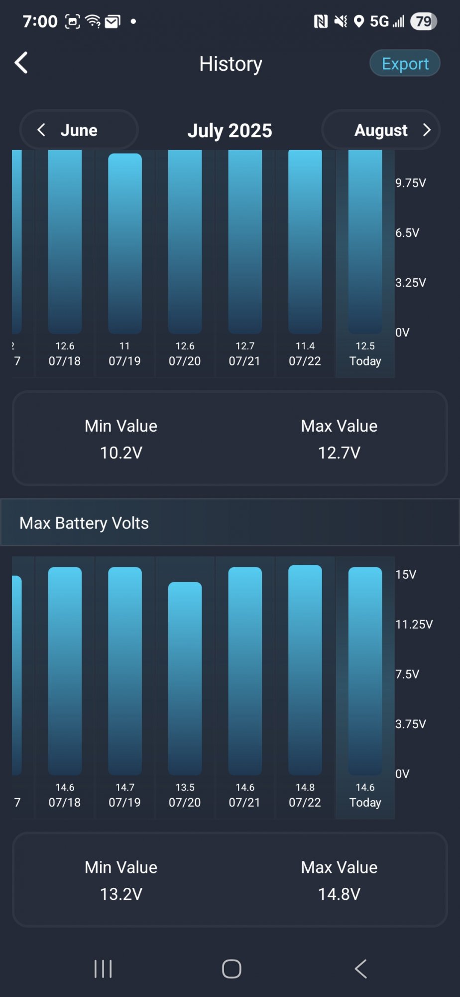

I'm pretty sure they were fully charged. The boat sat on a mooring and was used briefly for 2 out of 7 days. The min and max voltage measurements for the past week are below. I had issues on 7/22, 7/19 and 7/12 (not shown). we stayed on the boat aother night and I think the 10.2V was briefly while we made coffee. It appears that they were fully charged the rest of the timeScreenshot_20250723_190018_Renogy.jpg. My boat also charges from the solar panel so, unless both my alternator and solar panel are bad, I think it's a battery problem.
It's my understanding that Trojans have a life of 5-10 years if maintained well. In real life stuff happens, I tried but I don't think I treated them kindly so I might be on the 5 year side. In any event, I don't have time to replace them before my trip. I'll ensure that the alternator is in fact charging before we leave, I have the solar and a honda generator as backup.

I'm pretty sure they were fully charged. The boat sat on a mooring and was used briefly for 2 out of 7 days. The min and max voltage measurements for the past week are below. I had issues on 7/22, 7/19 and 7/12 (not shown). we stayed on the boat aother night and I think the 10.2V was briefly while we made coffee. It appears that they were fully charged the rest of the timeView attachment 233188. My boat also charges from the solar panel so, unless both my alternator and solar panel are bad, I think it's a battery problem.
When batteries age they lose capacity, not voltage. The batteries will charge to the proper voltage and look "charged" which they are. However, over time the capacity decreases. The 100ah battery may only have a capacity 60 or 70 ah or less after several years or some unfortunate deep discharges or lack of maintenance. The telltale sign is the batteries discharge quickly, because they don't have much capacity. This seems to be happening to your batteries. Equalizing the batteries may increase their capacity, but it will not return the batteries to original capacity.
A 20 hour capacity test will yield the actual capacity of the batteries. Note, this is capacity test not a capacitance test which is what the auto parts stores use to test the battery.
