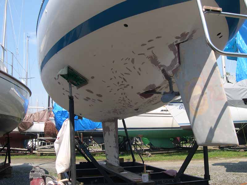

Hey all, I've gotten my '83 27h down to the gell coat, all blisters repaired, and the entire hull fared (see photo). We're ready to roll on the barrier coat. I was planning on going with the West System, but now am wondering about Interprotect by Interlux. I've searched the archives, and really don't see anything comparing the two. Anyone have a preference?? Any pros and cons I need to know about each? As always, thanks for the advise and thoughts. 3 weeks to launch! Kevin in Vermont
